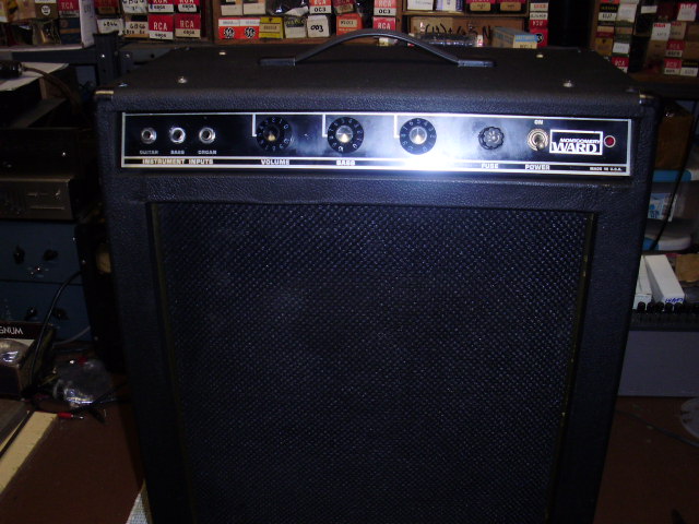

I was at a big Radio/audio show yesterday and was looking for some vintage git amp speakers...

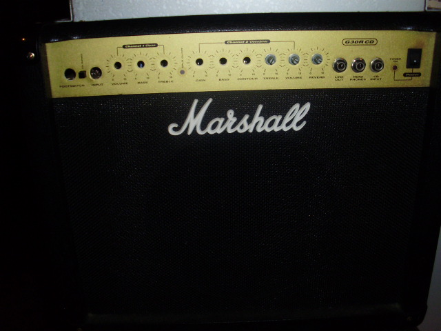

Found a couple of SS guitar amps, in not working condition,,, A Montgomery Ward Bass amp with a nice 15" Rola,,, and a newer Marshall with a 10" MG series Marshall speaker...
Also found a couple of other loose speakers, and thought rebuilding the non working amps with tube amps could make winter projects... So,,, anyone have a idea/schem for a vintage Marshall or MG/Airline tube amp I could build for either box??
I have some experience with vintage Fender circuits,,, but Marshall is new to me, and has its own unique tone, that I would like to keep with this project,,, The Marshall amp PCB appears to have been damaged(but there is no physical damage on the outside of the cab) as 6 of the[ 9 pots are sheared off the PCB, which I read was a design problem with them,,, There doesn't seem to be a schematic available for it, so the tube amp chassis seems like a good "fix"...

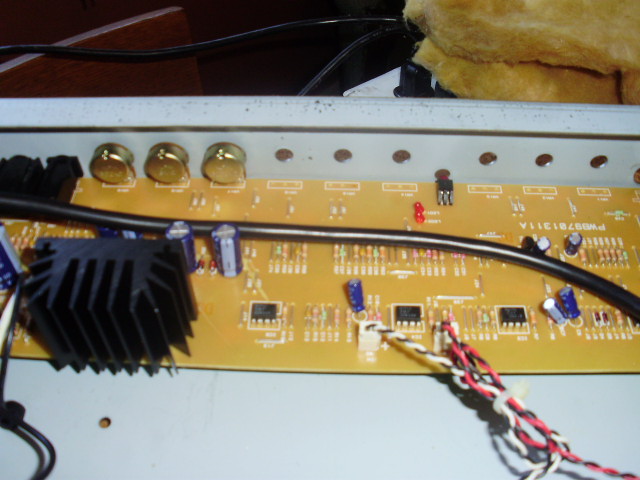

As ti building a tube amp in either solid state amp, you will have a metal chassis and the cab with speaker. None of the rest of the parts will be of use.

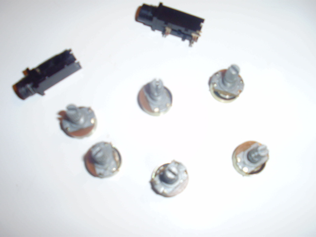

As to design flaws, some people gripe that pots ar mounted right on the board, instead of flying wires. But really, the ONLY way all the pots broke off is physical abuse.
Thank for the reply and schematic,,, I was looking last night, and came up empty... however I did read that the pots usually broke off their mounting to the PCB,,, the board is fastened to front plate by the pots and two thin plastic sticks hold the rear of the board to the chassis... horrible mounting system, which is prone to failure by bumping or even the amp tipping over... Since this seems to be a cheaply built chip amp, with broken parts,,, I would rather find a vintage Marshall tube amp schem, gut the metal chassis, and try to use the speaker (which sounds very good with my Champ project), and rebuild the nice cabinet, with its speaker,, and a Champ sized Marshall tube amp clone...
The Wards amp turns out to be made by Marlboro USA, and I found some examples of a simalar amp with their name on it,,, no schem turned up yet tho... This Bass amp has a nice 15" Rola,,,, compared to the 12" amps I found reference to,, so far... I can see using an old Airline Bass tube amp schem for this one....

Here's the broken pots,,, lugs are all snapped off clean,,, not sure where they ended up,, they aren't in the amp...
Thanks!!! This is exactly the info I needed,,, looks like EL84s,,, so they will be easier to source than EL34s or the KTxx that I saw on most of their schems... The British OPTs may be a bit different sounding, but I have some vintage PTs that should provide the right specs...

I also cleaned up the SS amp in the Monty Ward bass amp,,, fixed some wiring, cleaned the pots, and it sounds good, like to find a schematic for it, to check bias but its OK for now...

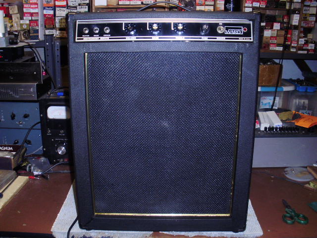

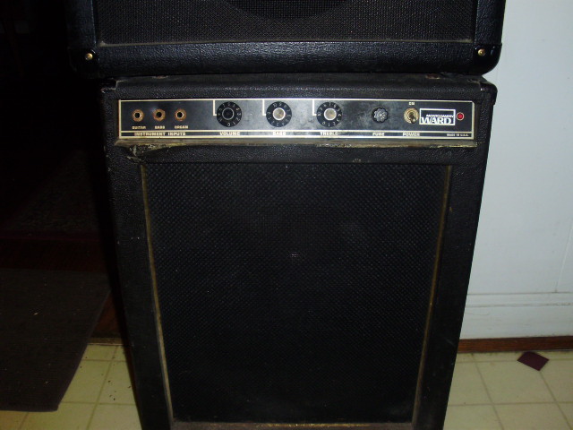

Cleaned up the Bass amp a bit,, re glued Tolex,, new 3 wire cord,, stretched grill cloth... Sounds pretty good for a SS amp... 15" Rola speaker is full range...

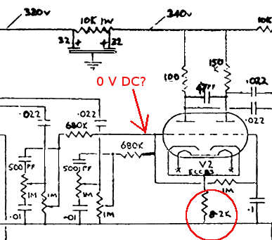

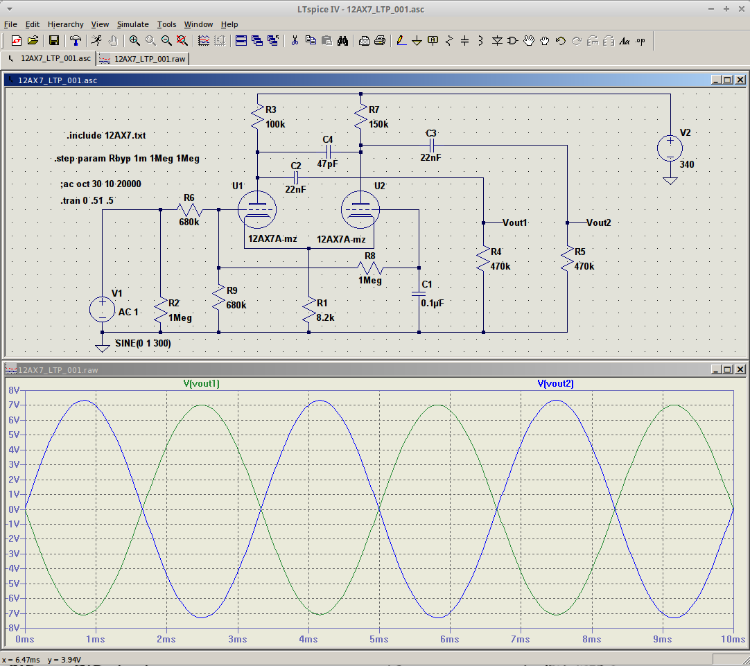

What's going on with that LTP phase-splitter stage? It looks as though the control grids are biased to 0 V, and the tail resistor is 8.2k, equivalent to 16.4k for each triode. In other words, both triodes are set at extremely cold bias.
Normally the tail resistor will be split into two, the triode control grids returned to the junction of the two resistors, and the control grids AC coupled to the input signal and ground, respectively. Control grids are not at 0 V DC in this arrangement.
The arrangement in this schematic, however, will produce extremely cold bias, so much so that I wonder if a long-tailed pair will even work under these conditions - if the input triode is biased off, there is no signal at its cathode to drive the second triode. In other words, there will be no output from the second half of the LTP, until the input signal to the first triode is quite large.
I could imagine that serving as the Marshall "cold clipper" stage in a guitar amp, but for P.A.? We need relatively linear small-signal operation for P.A. use.
I think there's a mistake in the schematic. Or am I misunderstanding something?

I looked at those three (#17, 18, 19), and all three show the same (faulty) LTP design. Control grids at 0V, single 8.2k tail resistor, 100k and 150k anode load resistors.
Is this a case of an accidental error in the first schematic, accidentally copied over to two more? Or a deliberate error in the schematic, to discourage copycats? Or does the circuit actually work as drawn (which I doubt?) 😕
There are other strange things in these three related (identical?) schematics, such as the 320uF cathode bypass cap for the input triode. Firstly 320 uF is not a standard value (330 uF is), and secondly, 330 uF is about fifty to a hundred times bigger than it needs to be for full bypassing over the entire audio range.
Schematic #20 on the same page (Marshall 2100 Lead & Bass), by contrast, shows an LTP design which will actually work.
I wonder if anyone has tried to build the 20W designs using these schematics, and if so, what problems they encountered? The mis-biased LTP and oversized cathode bypass cap are easy enough to fix if you know what you're doing, but I wonder what circuits/values Marshall actually put in these amps?
-Gnobuddy

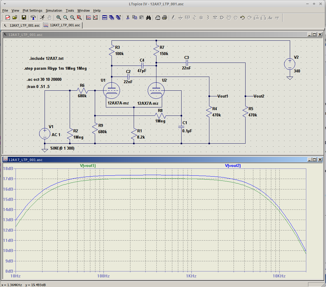

Having had all those doubts, I decided to simulate the circuit in LTSpice. The results are attached.
Unsurprisingly, LTSpice says each 12AX7 is biased to -3.5 volts, which is really cold, most of the way into cutoff - take a look at the 12AX7 datasheets to see how far to the right and down this puts the operating point.
However, to my complete surprise, LTSpice says that this crazy super cold-biased LTP actually works. The attached screenshot shows the two outputs of the PI, with the input driven by a 2V (peak to peak) input signal. What's more, the cold-biased LTP doesn't distort audibly until it's driven fairly hard - 6 Vpp at the input is still pretty linear.
While it does work, there is a penalty for operating so cold: voltage gain is a pathetic 7 times (17 dB) , instead of the roughly 25 - 30 times (~ 30 dB) we'd expect from a more conventionally biased LTP phase splitter. In other words, the cold-biased LTP has about one-fourth of the voltage gain of a more conventional one.
LTSpice shows a second problem (seen in the second attached image.) The signal from the volume pot to the first LTP triode is fed through an enormous 680k resistor, which acts as a low-pass filter with the input capacitance of the 12AX7 triode.
The second 680k resistor (from the second volume pot) helps out a little bit - if that volume pot is turned to zero, this 680k resistor effectively halves the source impedance to the triode, so it's effectively fed from 340k rather than 680k.
Still, this is ten times bigger than the usual 34k grid stopper at the input of a Fender amp (two 68ks in parallel), and LTSpice says it will severely limit high-frequency response: it's down 3dB at a mere 10 kHz!
This is probably plenty for electric guitar, but today, we wouldn't consider it enough for P.A. duty. Still, unsophisticated listening tests I ran on friends when I was a teenager showed that most of them would not notice a 10 kHz low-pass filter if I switched it in before they began listening to the music. (Some would notice if I switched it in while they were listening.)
Bottom line, my concerns were overblown; the circuit will in fact work as shown. 😱
(But more voltage gain can easily be found by changing the LTP stage biasing to a more conventional setup; this may affect overdriven tone for e-guitar use, however, so it would be an experiment to try, rather than a for-sure improvement.)
-Gnobuddy

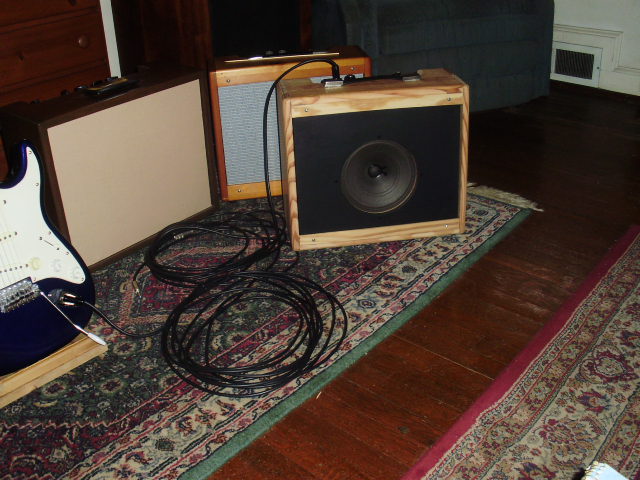

Heres the 5F1 Champ,, got it fitted in the box,, with the 8" Heppner speaker i grabbed last week also,,, sound better than the Marshall speaker in this circuit1
