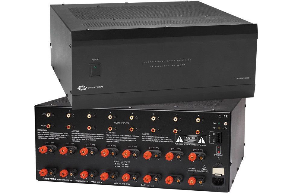

I was able to acquire a Crestron 16x60 amp, unfortunately one speaker terminal on the back was snapped off. I was able to obtain an OEM replacement and it looks like it would be a pretty simple replacement.
Can anybody provide any guidance? Would greatly appreciate it.

Remove the cover. Solder the wire to the terminal and attach it to the panel.
Verify that the terminal isn't making contact with the chassis.
Pray that the amp is working....
Here a manual

Oh, that is a total PITA to replace! This is because the binding posts are soldered on to a large circuit board that spans the entire width of the back of the amp on the inside. To get to it you will need to remove ALL of the amp modules first. It's not super complicated, but you will be disassembling a large portion of the amp. You will need to make very careful notes about how you did that, so you can do the reverse when you try to put the amp back together...
