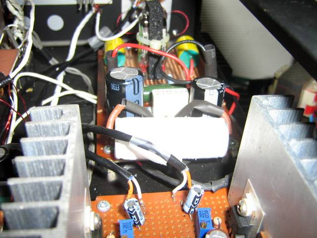

Hi, that light blue shoei solved hum problem in my dac dht tube out heater (1.25V), in my case 1uF/100V. put there before cerafine, mkt, mkp to no avail. I should bought more of them.
What league? I don't know, saw several of them in old (japan made) sony car amps, good enough I guess. (the ones near trim pot)
best, TeguhPS
