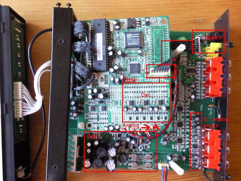

Hi All,
I hope somebody can help me with the following;
I have a fully operational 5.1 DTS/dolby surround decoder from Teufel, the decoderstation 3, which decodes a digital/optical signal to 6 analog channels
Because of the excessive use of elco's I want to replace some of them with film-capacitors. I have the feeling not all of them are necessary, so I want to remove the one's not necessary.

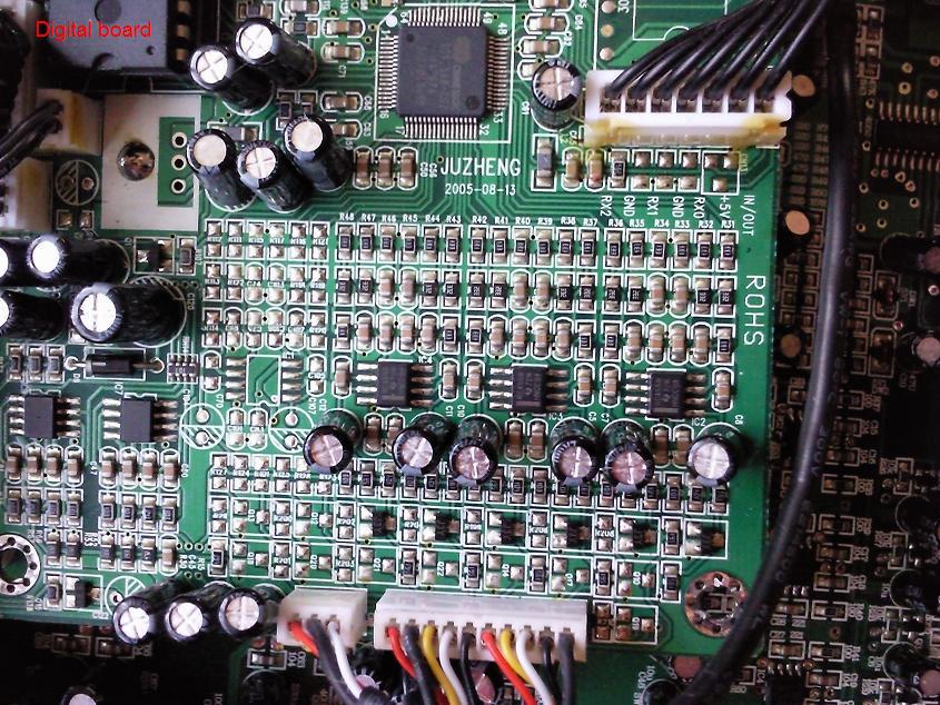

The input-signal is processed by the DAC. After that you see 1 couple capacitor (CC) per channel (photo overwiew.jpg), then the signal is transferred trough the red-striped wire (--> A)

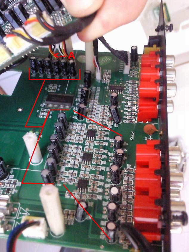

In the third photo (analog_board) there are again 6 CC's and after some sort of processing of the signal (I dont't have a clue what this IC does) there are again 6 CC's. After (what I think is) an extra ampflifier-stage there are again 6 CC's.
I hope some of the last capacitors can be shortened/removed. Furthermore I would like to replace the necessary CC's with film-capacitors.
The value of all of the CC's is 10uF / 50V. I read somewhere that when there is no DC between capacitor-pins measured when in progress, you could replace them with non-polarity capacitors. Is this correct?
I hope someone could help me with this one??
Thanx very much in advance
Maikel

Do you have schematics? I'm almost willing to bet that the electrolytic caps you are looking at are actually mostly for decoupling the supply rails. A few of them near the RCA jacks might be audio coupling caps.. Without a better understanding of the design criteria used in their selection I would leave them alone.
Also this stuff is ESD sensitive, I hope you are disassembling in a static free area with the minimum of an ESD wrist-strap. (An ESD mat would be a good idea too.)

Hi Kevinkr, thanks for you're reply. Unfortunately I don't have any schematics.
I didn't knew this is ESD sensitive 🙁 , I didn't touch any component but did'nt use any wrist-strap. Hope nothing is damaged, I'm going to use this now.
I'm going to try to find out if the caps are indeed for decoupling the supply-rail. How can I check/verify this. Is it enough to see if the - of the caps are on gnd of the power-suply-rail??
Could you leed me in the right direction? 😕
I'm going to email teufel, maybe they can send me the schematics, I can't find any on internet
Thanks in advance
Maikel
