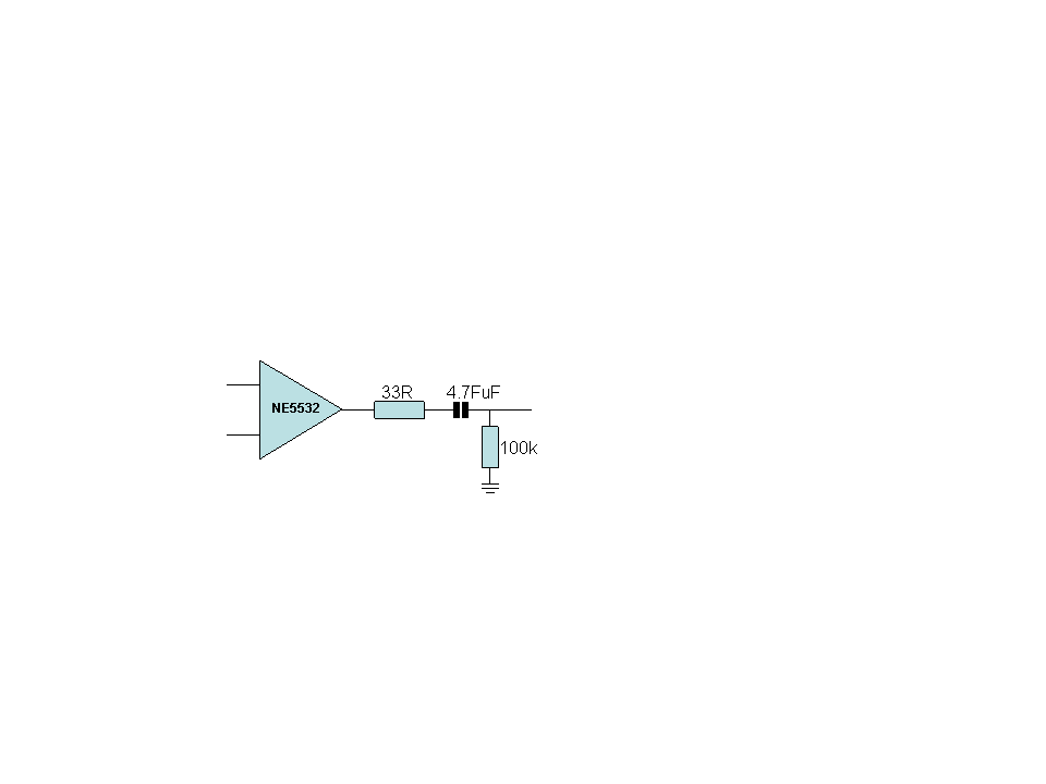

I received once advices for NE5532 implementation in DA conversion, which is interesting and not obvious at first sight: supply 7812 reg, as close as possible to supply pins (and no bypass at all(!?) -> on the output of the chip resistor - fairly low 33R-> 4,7uF poly cap, and after that->100k to GND. The signal iz taken from this point. The point is, this chip works best if it is stressed for high current output, and the cofiguration of R/C on output is inverse of usual practice as can be seen in most of the CDP schematics.
I tried this on some old Rotel RCD971, and there is significant difference in sound, really, especially on the quieter bacground and more real stage, noise but I don't know if it works in preamp configuration.
Interesting to note I was told this solution is taken from some Studer proffessional broadcast CDP, so it might really be very carefull design.

Usual reason for putting a low value resistor on an opamp output is to ensure stability into capacitive loads... even lead capacitance. The 4.7uf eliminates DC offset, the 100k providing a true ground reference (0 volts) at the other side. The only load on the opamp output is the 100k...
Don't quite follow what you mean tbh 🙂
Sometime the output from a DAC is fed into a low value resistor to ground such as 33 ohm, and that converts the DAC's current to voltage. An opamp is then used to amplify that.
