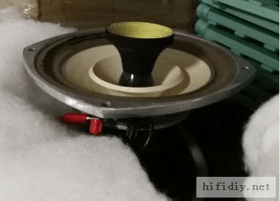

My quick-and-dirty PM6A 360° before the pair were placed onto steel umbrella stands. The deflectors were hand-wound-and-sculpted from 0.5mm-thin 1cm gasket foam tape (unpeeled except at both ends). Excellent stereo imaging with deflector, none without. But I was scared off by the much greater raw SPL needed.Omni eh? That would change response curve from cone area-weighted to radius linear-weighted, favoring HF. (At least when I tried it on Lowther PM6A after Harman Kardon Citation X 360.) It would also require much higher raw SPL spread 360 degrees, especially tough on the midrange output. Perhaps you can get more info from your friend how he dealt with these interesting design challenges ;-)

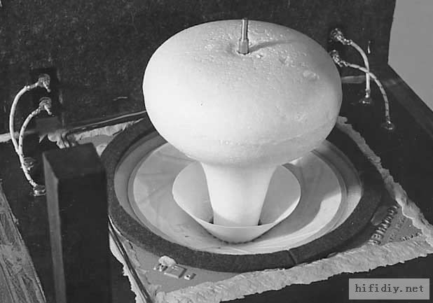

Modelled after the 1960 Harman Kardon Citation X 360° which used a custom version of Lowther PM6 (further aided by a flat back-reflector) http://roger-russell.com/omni/omni.htm
