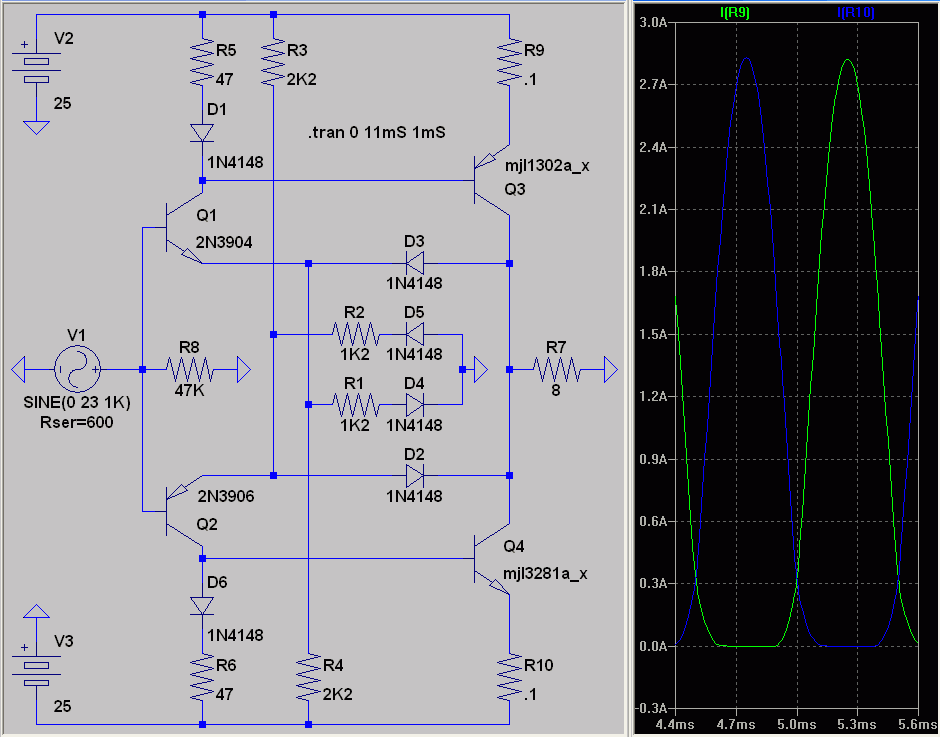

Long time ago I made a class A+B output stage, bridged, for the BEAG guitar amp with damaged output transformer. The guy wanted it to be repaired overnight, but I did not have an OT, and did not have a chance to rewind one, so I installed instead of it a PS with 50W toroid, and made a SS output stage. It sounded nice, and musicians were impressed that a guitar amp now can play bass. B|
It is not class AB, it is class A+B, you can see what I mean on the graph to the right. Transistors never cut-off, and the amp goes from "triode" to "pentode" mode when overloaded, exactly like output tubes.
