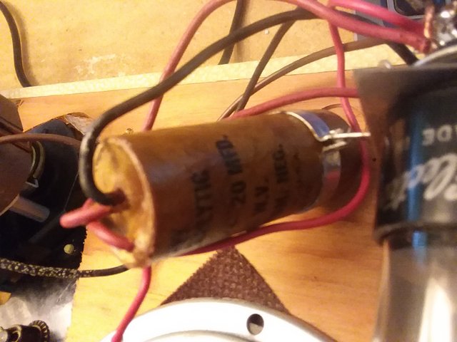

Do I have to replace this with one of the canister type, or will a modern one like this on ebay work, or where can I source a cheap replacement?

Much appreciate any help. I have this little old phonograph like what you would have see in schools or for kids maybe in the 60s. Tube lights up and it makes that capacitor hum.

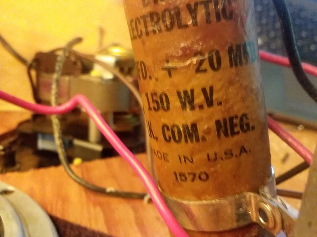

I can nearly see 20+20 uF, thus 2 caps is needed. My guess at least 300Volt.
Is there 3 wires connected to it ?
What voltage is across the cap when powered on ?

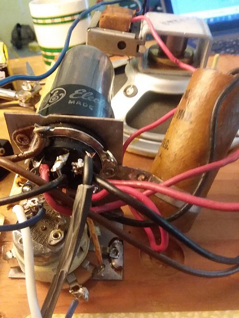

Okay thanks, I didn't notice "20 + 20" -- I'm totally unfamiliar with these circuits so I'm asking as a noob.
Yes it has three leads (it says "BLK COM NEG) on the capacitor itself that are all wired to the single 117 N7 GT tube. Also has 7-52 188-5 on the black part of the tube (backplate type?).

That OEM part is clearly marked 150 working volts. As modern electrolytic caps. are much more volumetrically efficient, use 200 WVDC or even higher rated parts and increase the operating margin. 2X of this part will satisfactorily replace what's currently present. Stick 'em down with hot melt glue.

In cases where the cap is inside the chassis I usually zip tie two caps together. Definitely get higher rated caps like 250v. Line voltages are higher than they used to be.
If you're wondering why the cap suggested by Eli is so much cheaper than the other one that was linked (62 cents vs $2.50), it's because caps with axial leads (one coming out each end) are much more expensive than radial leads (both coming out the same end) and 20uf is not as common a value today as 22uf. Either one will work fine. The cheaper one is actually a better cap too since it's rated for 10,000 hours vs 2000 for the more expensive one.
