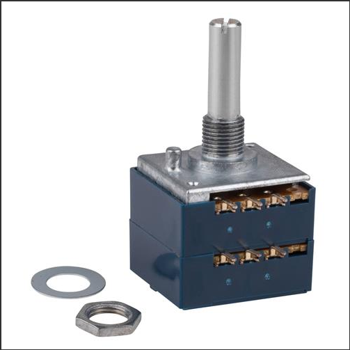

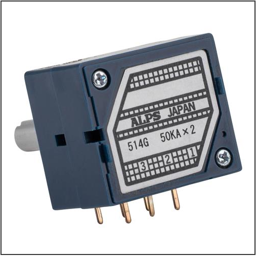

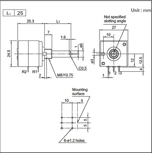

Hey all,
Did some digging online and I haven't come across a thread on this that I could find.
Anyone ever replace the volume/selector switch ALPS Pot on a Rega Mira series integrated? I've seen the scratchy intermittent switch is very common, but I've never seen an actual replacement solution.
Does anyone know if this would work?
ALPS 50KAX2 50K Ohm Audio Taper Stereo Potentiometer 6mm Shaft
Thanks for any thoughts or experience!
