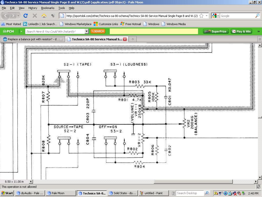

I've been using the service manual but can't for the life of me find the balance pot on the schematic.
And yes, 200k. I tried attaching the manual, but the file is too large.
Also, I tried resistors in the manner gmphadte described. One channel was very quiet, the other got nothing.
Location in schemaric

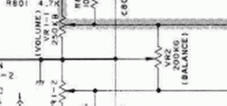

The balance circuit is as I described in post #5. Have you connected the resistors in the same configuration? Are you sure it's the balance pot that's broken? Methinks there's more going on here than what has been disclosed thus far.
In the general info category: If you're using Adobe Reader, you can select Take Snapshot from the Edit pulldown and then select the desired image by dragging your borders with the mouse. Reader will automatically store the image on the clipboard. Then just use a program like Irfanview to paste as a new image, do final editing, etc.
