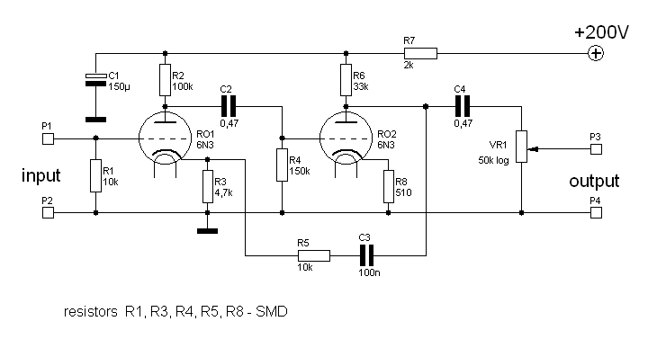

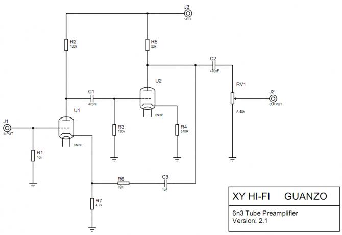

replace 6N3 tube preamp with mullard E555L
Hi all
just buy from eBay this kit:
6N3 Tube HiFi Buffer Audio Pre Amplifier Amp Board with Transformer | eBay
according to the Reviews this is nice pre.
the schematic and some picture are attached.
Friend give me Mullard E55L (8233)*2 tubes, i read on the net that they are nice tubes. can i replace them with the 6N3 tube from eBay?
The power is 170ac+6.5ac
6N3P cannot be replaced by E55L for this kit. It would require redesigning component values, and furthermore 6N3P is a double triode, meaning there are two triodes in a single glass envelope. E55L is a single pentode; even if it's triode strapped and has the same base, you would need to add two sockets and get two more E55L's.
