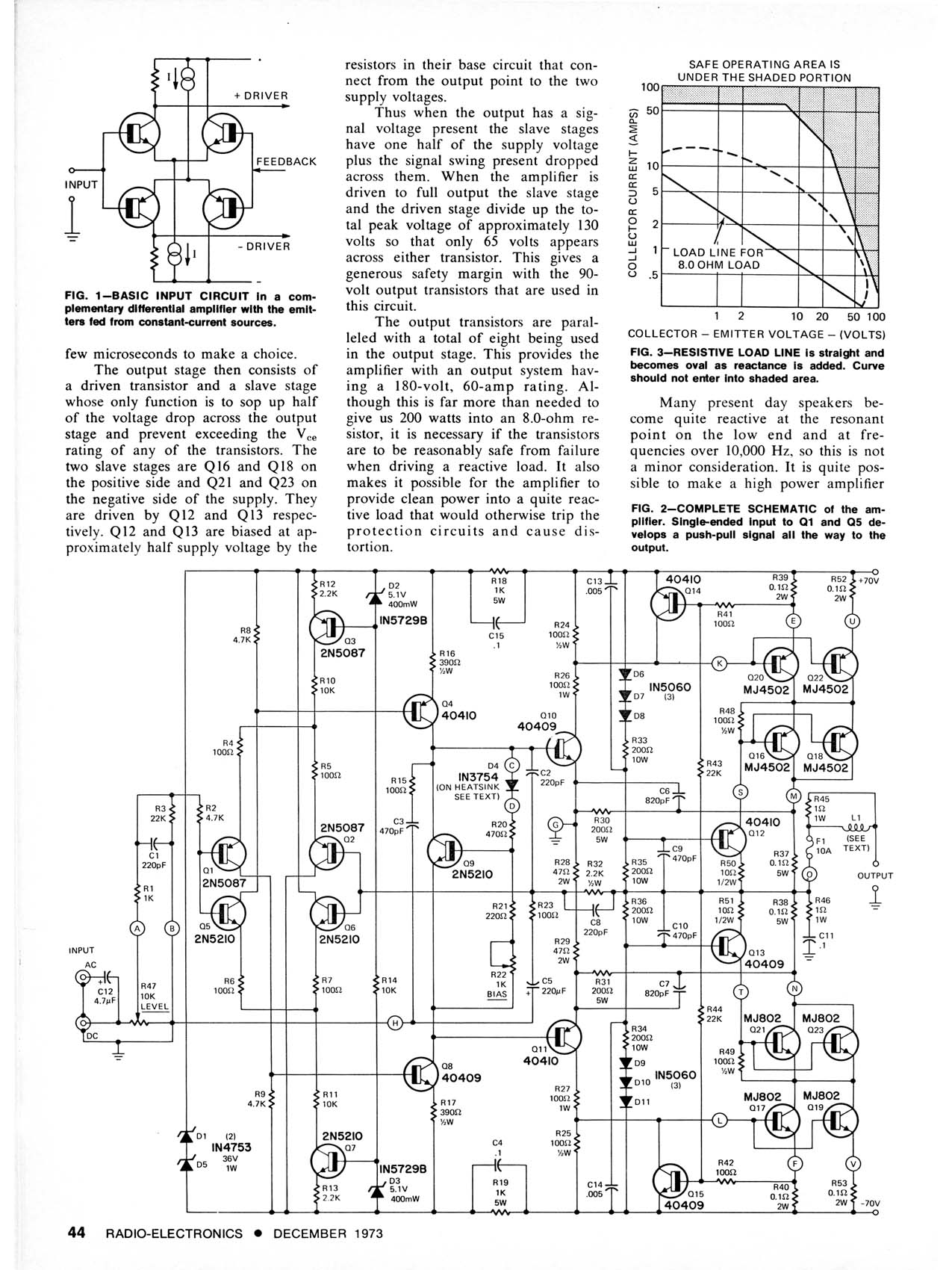

Where will I use them? I plan to try to make a updated version of the South West Tech Tigersarious 250 watt mono block amp using updated transistors and outputs on a new PC board that will support the different footprint of the newer transistors. I am somewhat confident that a newer board a better laid out board will yeald an amplifier that doesn't blow itself up due to faulty construction and workmanship. The two Mono block amps I had worked very well and sounded quite good.

2N3440 and 2N5415/6 add finned heat sinks
The MJE devices will generally not fit the skinny holes in the PCB and they are much taller once inserted
I had actually used the 3440 and 5415 as replacements for the blown RCA transistors on the Tigersarious driver boards along with heatsinks. The amps were still working when I gave them to a neighbors son prior to moving. I was thinking there was possibly something a little more robust. That and the fact they are getting hard to find also.
MJE340/350 are a close cousin to 2N3440/5415. Easy to find a way to heat sink, too. To-39’s are a pain in the ***. 340/350 are often used as replacements for unobtainium originals for predriver or VAS duty in many vintage 200-250 watt per channel amps. Also still a reasonable choice for new construction.

Just be careful to leave lots of room around the 10W power resistors that do the voltage dividing for the drivers -- R33, 34, 35, and R36. They start throwing off a total of 24W as soon as the rails go up. And there are several others that'll get pretty toasty as well.
Not to throw a wet blanket on your project idea, but I'll be really surprised if the reliability of this design can be substantially improved with board layout. Just about every part between the outputs and the input long-tails are being ridden pretty hard.
It is a tasteful, aesthetically pleasing design, I'll admit -- full complementary-symmetry. The early Bryston 4B is very similar in concept (though not device p/n), and they're notably hard to pop, at least by my experience.
Maybe instead of looking for close replacements to the 40409/40410, find out what Bryston used for the VAS and drivers. I bet they'd hold up better.
