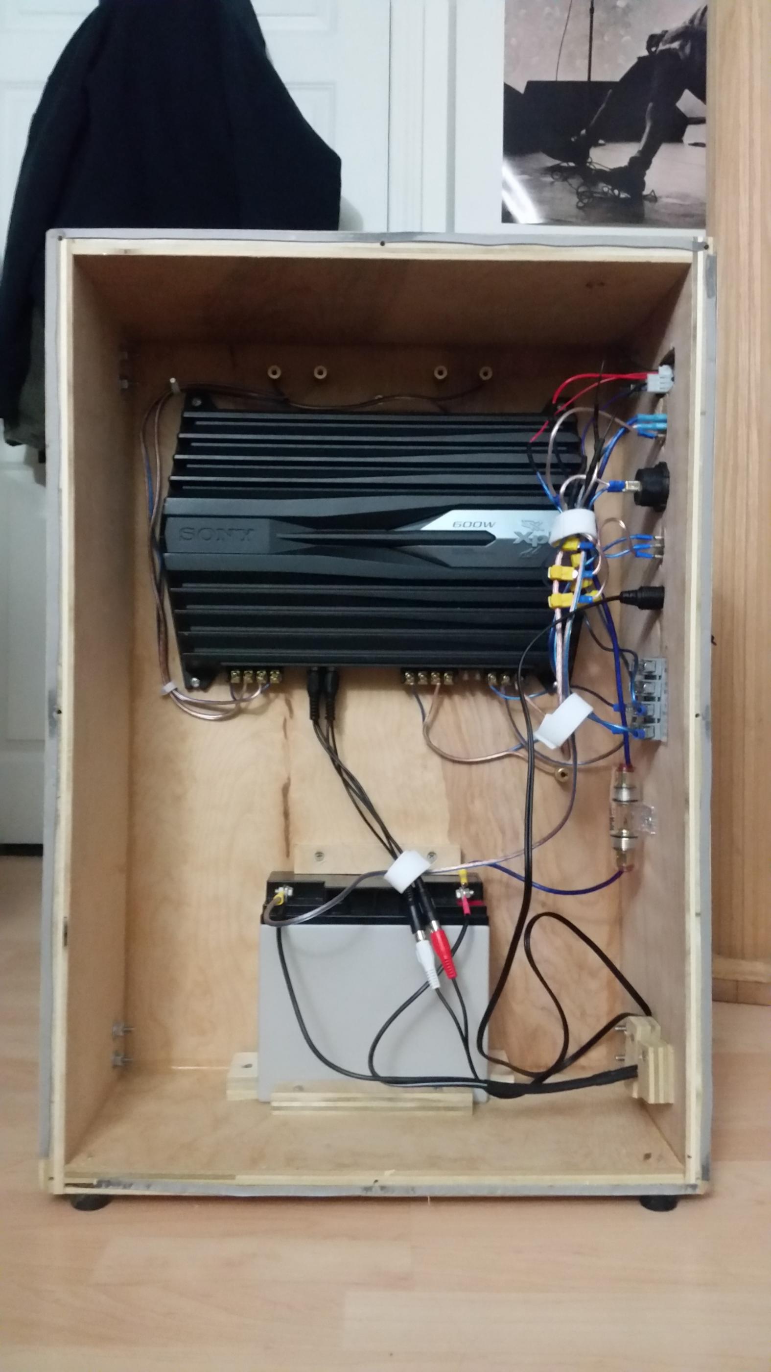

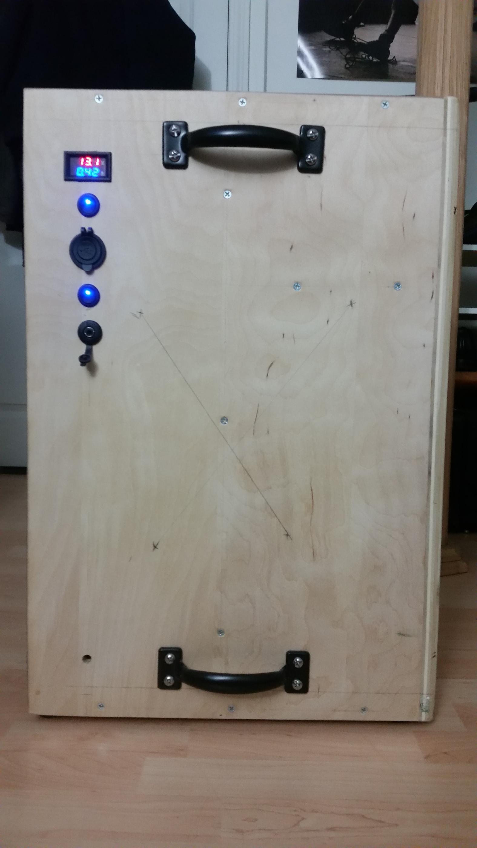

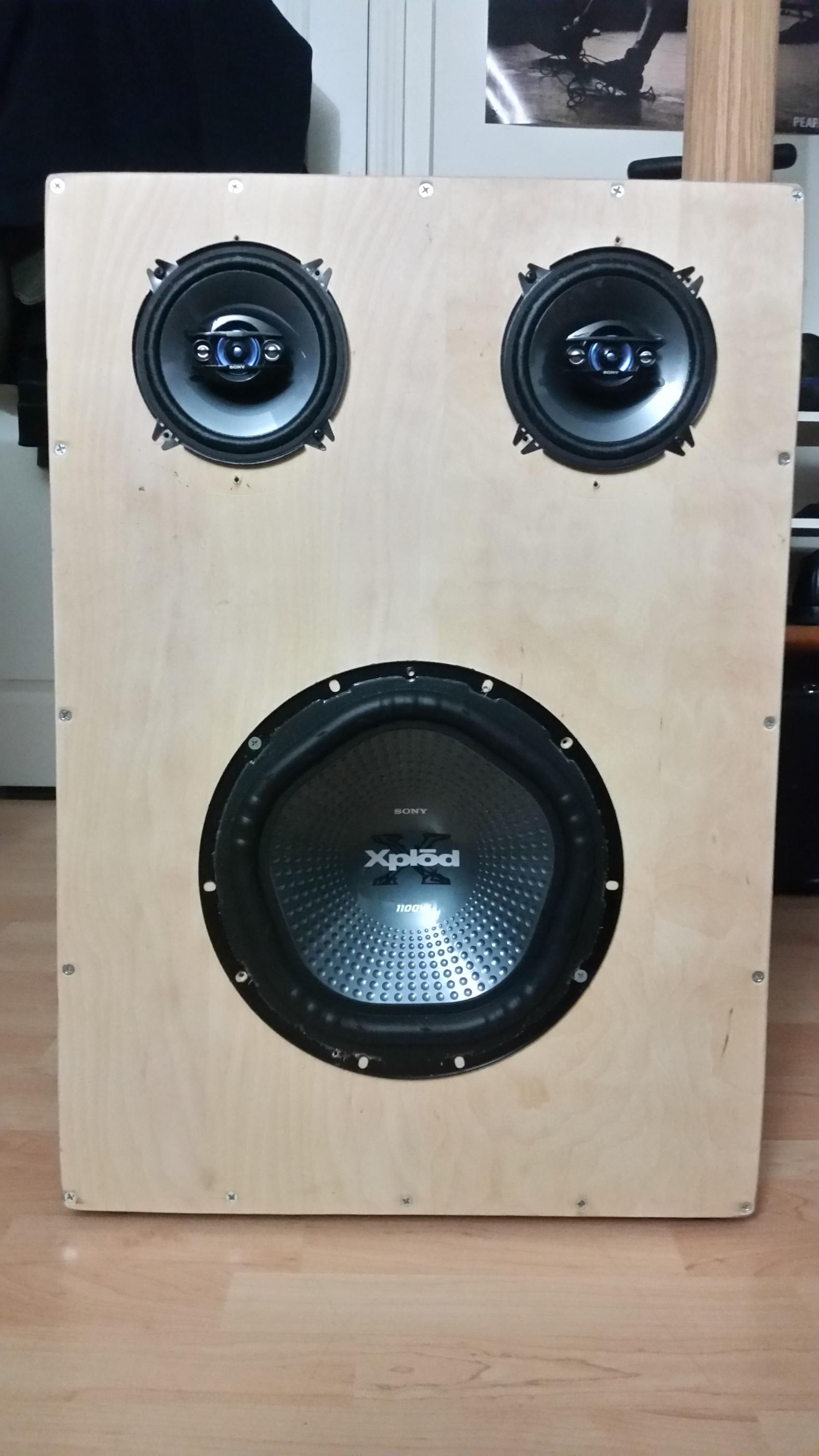

Here are a couple pictures of my project as it stands now, if anyone is interested.

I'd definitely try to add a port to the box.
You can get extendable ones. Mount it with the port sticking out, play music, adjust the length. Once you're happy with the sound, mount the port inside the cabinet and you're good to go.
You'll get more SPL for <$10, and cutting a single hole. Very much worth it IMO.

Hi, You need to seal off the upper drivers, and add a port, rgds, sreten.
The upper drivers are sealed off. Each driver has it's own compartment.
You guys are really pushing for this port ;p What frequency do you think I should try to tune it to? Any recommendations for the easiest way to accomplish this?
I was convinced that the Polk drivers were much better than the Sony's, but now you guys have got me worried. Which drivers would you recommend that I install?
The easiest way to install a port is to use a 3.something inch hole saw and then jam a 3 inch (internal) abs pipe length into the hole. It fits so tight you will probably need a hammer to get it in the hole. You don't need to glue it or anything, it won't go anywhere and it won't leak around the edges. Just cut the hole with the hole saw (attached to a drill) and pound the abs port into the hole.
