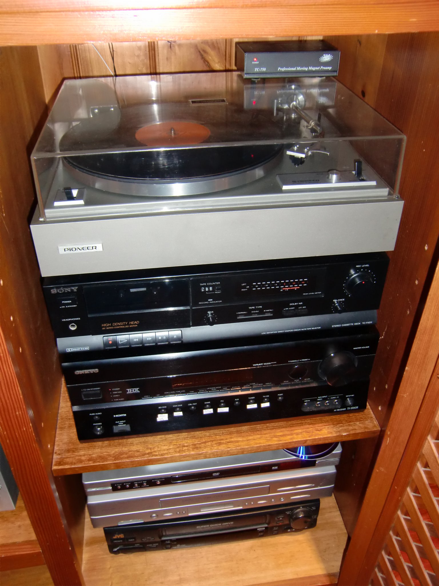

  • Unfortunately Thakker only had 2 belts, so it was missing the tape counter belt. So, looks like directly from Webspareparts website was the go - Also worked out cheaper than their ebay store.
  • I double checked the tape deck manual and it states that it can record on type iv metal tapes, though it says the bias setting is not as effective. Is this what you guys are referring to? I was wanting to try recording some lossless high res flac files, along with recording off the turntable. This is more for fun than anything else. I kind of just want to experience for myself what all the fuss was about.
  • I'm not sure who manufactures the belts, but at least they state they are made from 2021, so hopefully they should be nice and fresh. I think they ship out of Portugal? I recently saw on the news Spain was going through a crazy heatwave hitting 47 deg C. So I suppose if they can survive that, they should be ok in an Australian summer.
  • Though I think this time, I'll keep the tape deck beneath the amp, not directly above it, which probably didn't help. Though I suppose I'll need to figure out where I should put the turntable, as I don't want to melt those belts too. The other challenge is that the amp is so heavy, its balance is a bit precarious when sitting on the top of the stack. So I suppose I should just add more shelves.
  • Lastly slightly off topic - Even though mums TV cabinet is really solid and heavy, at high volume, some sound vibrations make it back into the turntable and causes unwanted feedback. Also I'm not really able to physically separate the speakers or the turntable from the cabinet. So is there a better way to isolate or dampen these vibrations?

Unfortunately I can't move the speakers away... I've tried discussing it, to no avail. Maybe I'll need to make some custom speaker stands, and maybe with the sub included in one. Though I think the proximity is still too close so I'll have to look at those other options too. Though I thought felt mats were slippery? Would any felt do? And does that go above, below or replace the rubber mat entirely? Or do you mean putting the felt/carpet underneath the turntables rubber feet?

Put the mat under the feet of the table.
If possible, two different density layers in the mat.

Hmm, i don't think that will be possible. The cabinet is quite large, made from solid wood, and takes 4 people to move... so probably around 200kg. It just isn't practicable to put a mat underneath it.
