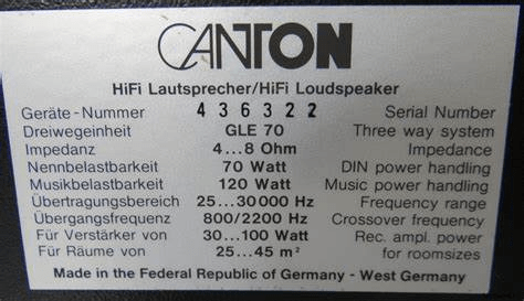

I bought a set of two Canton GLE 70 speakers (1978-1981) at a local thrift store. The guy there promised me that I can return them and get my money back and told me I should test them if I want them. So i took them with me.
This ist the speaker: https://www.hifi-wiki.de/index.php/Canton_GLE_70
I paid 30 for the set.
One speaker sounds very good the other has problems. I think that the midrange driver is gone but I'm not completly sure, could also be the tweeter.

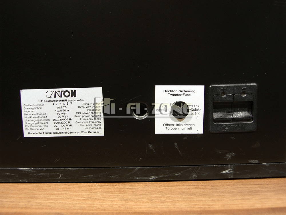

The Speaker has a tweeter fuse built in on the backside. I switched the fuses of both speakers and after this both speakers sounded awful. When I switched them back the left one sounded good again.

The fuse holders may be corroded so try cleaning them. They may have to be replaced or bypassed. Also check the condition of the fuses.

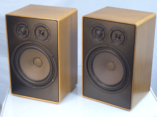

By way of a bump, I am adding photos of the vintage (1978-81) Canton GLE.

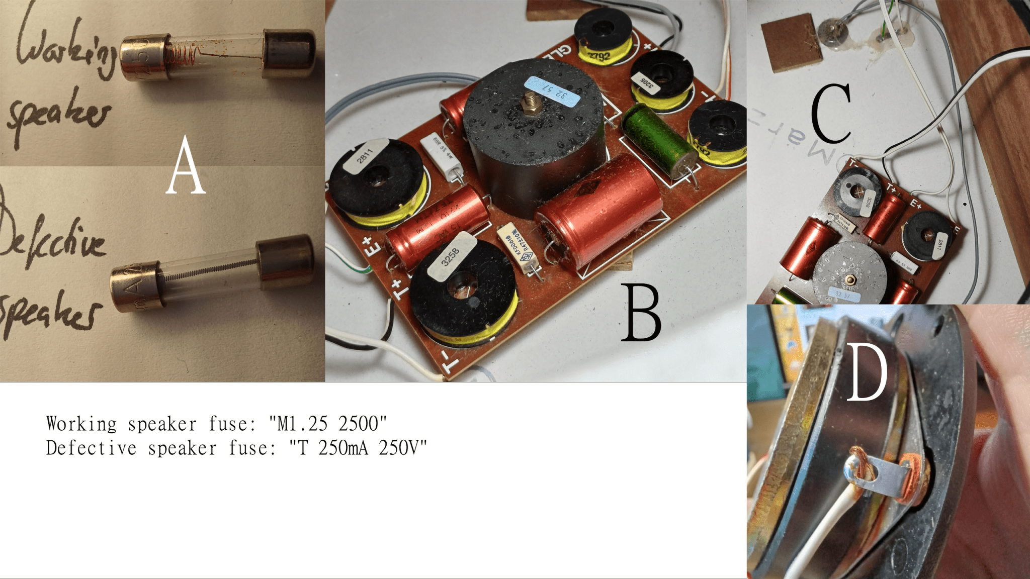

  • A: The fuses in the two speakers differ
  • B: I took a photo of the crossover of the defective speaker
  • C: If I were to bypass the fuses, how would I do it? Would I just solder the two cabels goint to the fuse together?
  • D: This is the replaced tweeter. There is only a little bit soldering going on but it seems relatively attached...

This is a German "Wackelkontakt". A soldering iron and 60/40 solder with flux core are a must. (German "Elektroniklot" with lead and "Flussmittelseele"). Ask someone close to you.
I am pretty confident that you already moved at the Wackelkontakt. Did you crosscheck with a Battery? Credit @turk 182 . Does the Tweeter crackle?
My next step would be to find any working Tweeter. Just to check if the crossover is working at all. You may bridge the fuse, 1,25A is much to high anyway (sorry Canton).

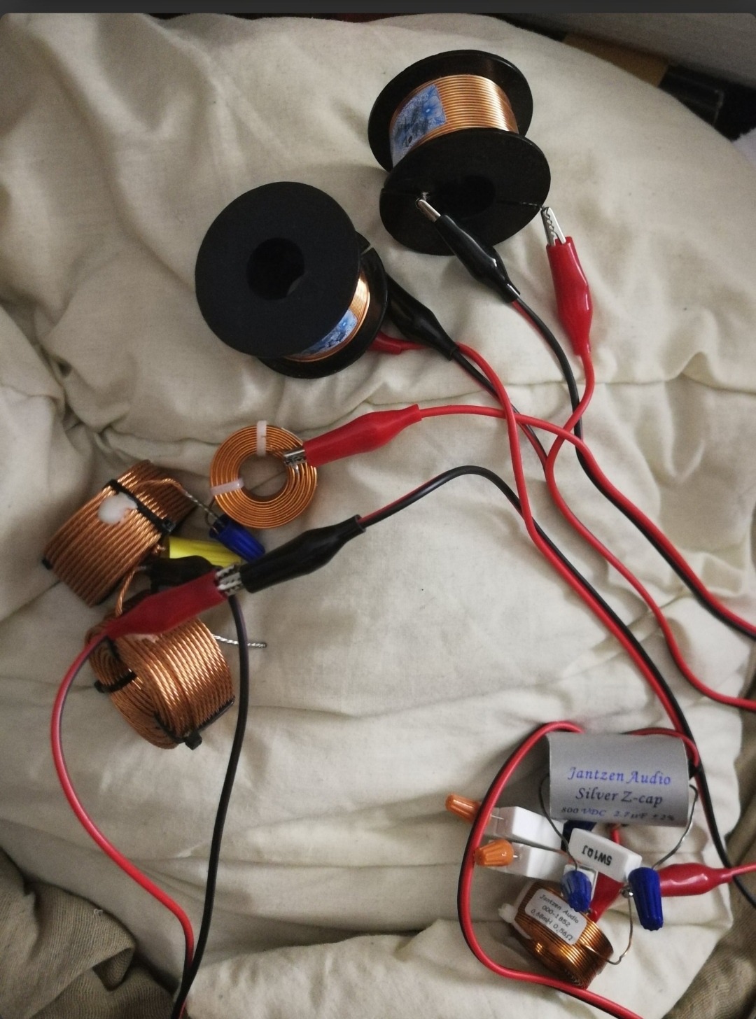

Congrats, you can now identify and diagnose the most common sound issues such as frequency response (tonality). See if you can buy some alligator-clip wire and electrician's caps (look for them in this picture...). Then the most common capacitor/resistor/inductors to play around. Because their values add (C in parallel; R L in series) only a few are needed for doing experiments and "empirical design" by ear.
First you need to bypass the bad fuse/connection -- by brute force. Does the bad speaker play higher than 5khz? If you trace back from the bad tweeter to the capacitor in front of it, and read off the uF value, that should give a further hint how the tweeter is used.

A: fuses, one slow blow in the working speaker the other a fast blow with supported filament...while we tend to trust our eyes and both look good without a meter (or a old school flashlight lamp with our 1.5V battery) there's no telling that the fast blow (from the defective one) is good just by eye (sometimes the caps hide the damaged portion of the filament).
B:could we see the foilside of this x-over please.
C: i would jumper across the fuse holder (but i'm not there and can't see the layout and wiring)
D: mechanically solid does not mean electrically conductive...bad solder joints are everywhere...and could be why we all are gathered here..
