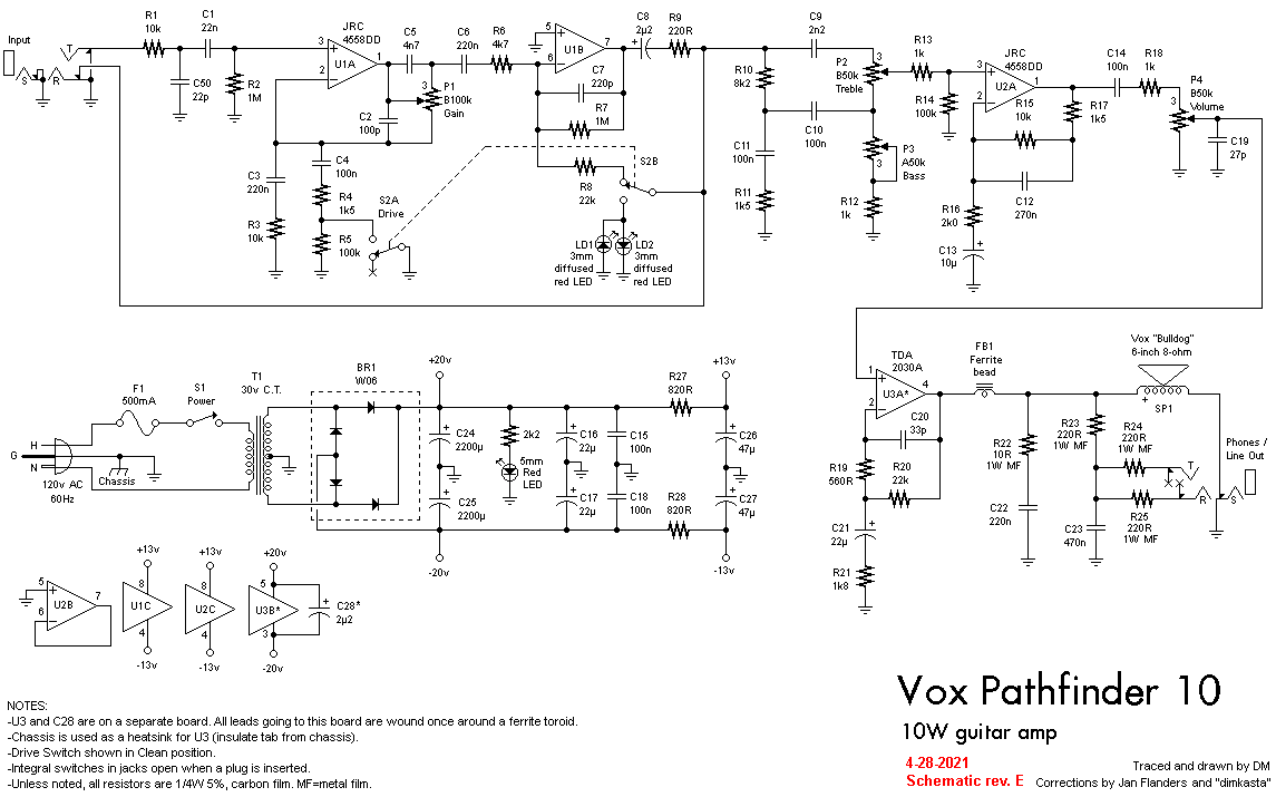

For reference, I'm using the schematic Rev E, traced and drawn by DM, corrections by Jan Flanders and "dimkasta" (found on imgur).
Any ideas?
Posting the schematic or a link to the schematic here is a nice thing to do. Just glancing at the Rev B on "aggh" it sounds like a bad capacitor in the signal path to me. When you say they "look" OK, does that mean that you pulled and tested/replaced them?
If not: I see most of the caps are poly, so they should be bullet proof. The only electrolytics I see that would be my first suspects are C8? the 2.2uF right after U1B, also C13 10uF, C21 22uF. Best to just replace them if you can.
After that, if the problem is still there, if the pots are not scratchy, and the drive switch not flaky, and you don't have a thin cracked solder joint somewhere, I'd replace the op-amps. JRC4558 can even be improved with a better quality amp if desired.
Thanks for the insights! Schematic attached now.

The scratchiness of the pots is an interesting idea -- I suppose if P1 (gain) pot was defective, it's early enough in the signal path to possibly match the symptoms. But would that indeed cause a broken up/noisy signal at any position of the pot?
Op-amp replacement does seem to be sensible, but I'd need to order some (NE5532?). But probably worth it for the quality bump (and definitely worth it if it fixed the issue!).

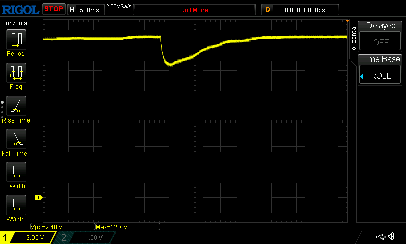

I tacked on some new 100uF (what I have) electrolytics across C26 and C27, which made no difference.
However, investigating your other thought of power supply cleanness under load yielded something interesting! Giving a good pluck of the thick E string, on drive channel with gain at 50% and volume at 20% (and with headphones connected i.e. speaker disconnected), the voltage between earth and +13V dropped significantly. See 'scope trace attached, at 500ms/div, 2V/div.
Makes me wonder if either C24/25, rectifier or transformer is bad.
That does seem unusual- a 2V drop taking 1 second or more to recover (only as the note dies down). With headphones there is very little loading on the output amp compared to the speaker, so I would not expect a droop this big. Was this also seen on the -13 rail?
The rectifier could have a bad diode (Did the output amp previously short?) If there were a bad diode, the bridge rectifier becomes a half wave rectifier for one side, so one side would have twice as much ripple as the other side (and the ripple would be at 60Hz instead of 120Hz) but that would not explain the lower output signal- a bad cap would however. If you listened to the op-amp outputs and they seemed normal, it seems the problem would be with the output, and if it is working properly again, points to the bypassing. Yep, I'd do all of the caps in the power supply and go from there.
