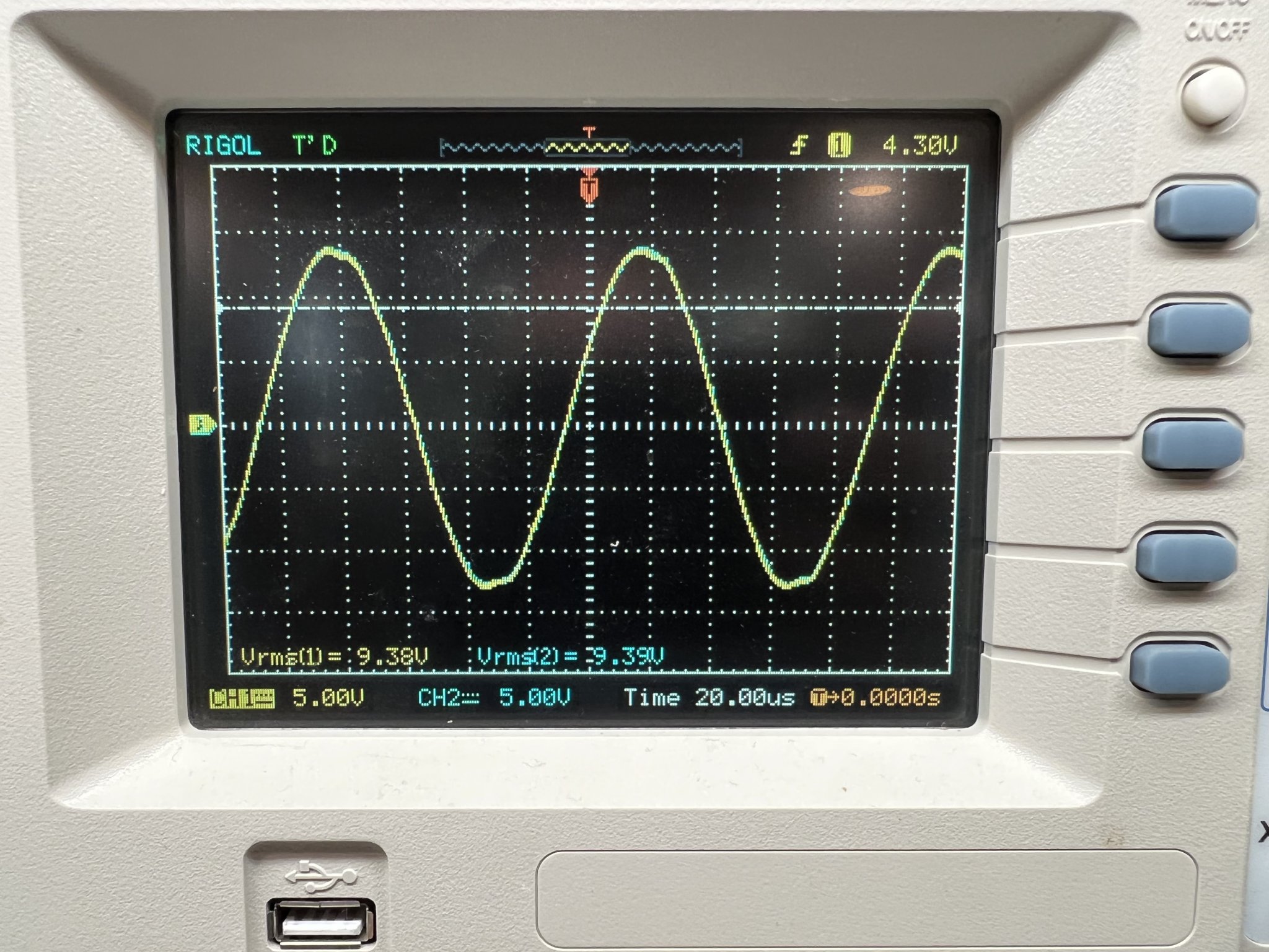

Repairing fairly rare mosfet amplifier, things to double check?
Crossover distortion should only show in the centre of the waveform around the zero crossing point. Make sure you have a suitable load attached as distortion will not show with no load. 4 ohms is good as a test.
Power should be kept low as the distortion shows much more at lower levels.
The flat tops on the sine could be down to the actual source. If it is from a function generator (so a synthesised sine using diode clipping) then it is likely normal. See if the input waveform looks the same.
This shows crossover distortion (yes, it's only a simulation but it is accurate)

Oh yes, sorry I know what crossover distortion is, at the lowest bias point that’s what I thought I was showing here
You can see the slight squiggly line there, but maybe it’s not enough. I have the amp driven into a pair of 8 ohm dummy loads. I should get another pair of 8 ohm so I can drive into two 4 ohm loads, but can’t at the moment. Should I be seeing more crossover distortion? The distortion on the peaks I knew wasn’t crossover distortion, but was curious if it could be caused by the bias voltage.
