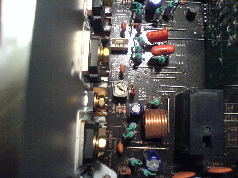

I'm repairing a Denon AVR-1602 surround receiver for a friend and I've replaced the broken parts (fuse and two transistors). Do I have to adjust the trimmer pots? (And how?) There's one trimmer pot for each channel.

Chris,
I checked all the transistors mounted on the big heatsink and then I replaced Q101SL (2SD389) and Q103SL (2SB1559).
I used a DMM to measure resistance between the different transistor legs. The broken transistors had close to 0 ohms resistance between two legs.
Hi Brannigan,
I would recommend you replace the drivers as well. Possibly the bias transistor also. Did you check the emitter resistors, as well as the resistor between the bases?
Once you have done that, adjust the control to make the voltage across the emitter resistors the same as the other channel. Recheck every 15 min for an hour. I don't have the manual, so I can't advise you more than that.
-Chris

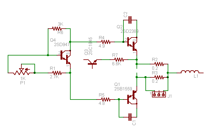

I've put together an approximate schematic of the output stage.

Hi Brannigan,
Is there a distributor for Denon in your country? Why not just order the spares from there? Check how much a manual is, it may not be that expensive.
If the parts come from Denon, they will not be fakes. The really low value resistors are probably the emitter resistors. You measure across these to determine bias current.
-Chris

I measured across the emitter resistors connected to the test points:
Front, left: 3.28 mV
Front, right: 4.61 mV
Center: 3.14 mV
Surround, left: 2.97 mV
Surround, right: 7.42 mV
The transistors I replaced were in the left surround channel.
I assume these values differ too much?
Hi Brannigan,
The bias on the right surround channel is too high. The left is fine. The other values are acceptable as they range in the same ballpark. I haven't read the service manual, so the right surround bias might be within tolerance.
