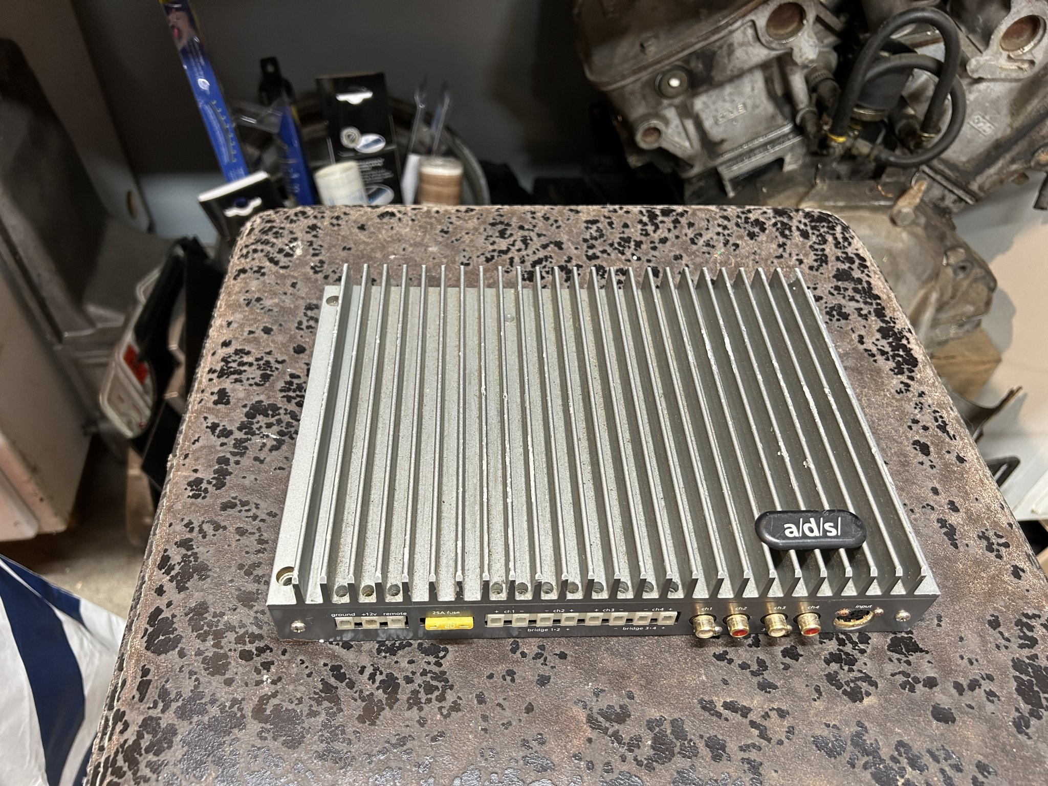

I picked up this ADS Power Plate amp a few months ago and finally had time to put it on the bench and test it.
It powers up, the power light turns green, but doesn't have any output on any speaker output.

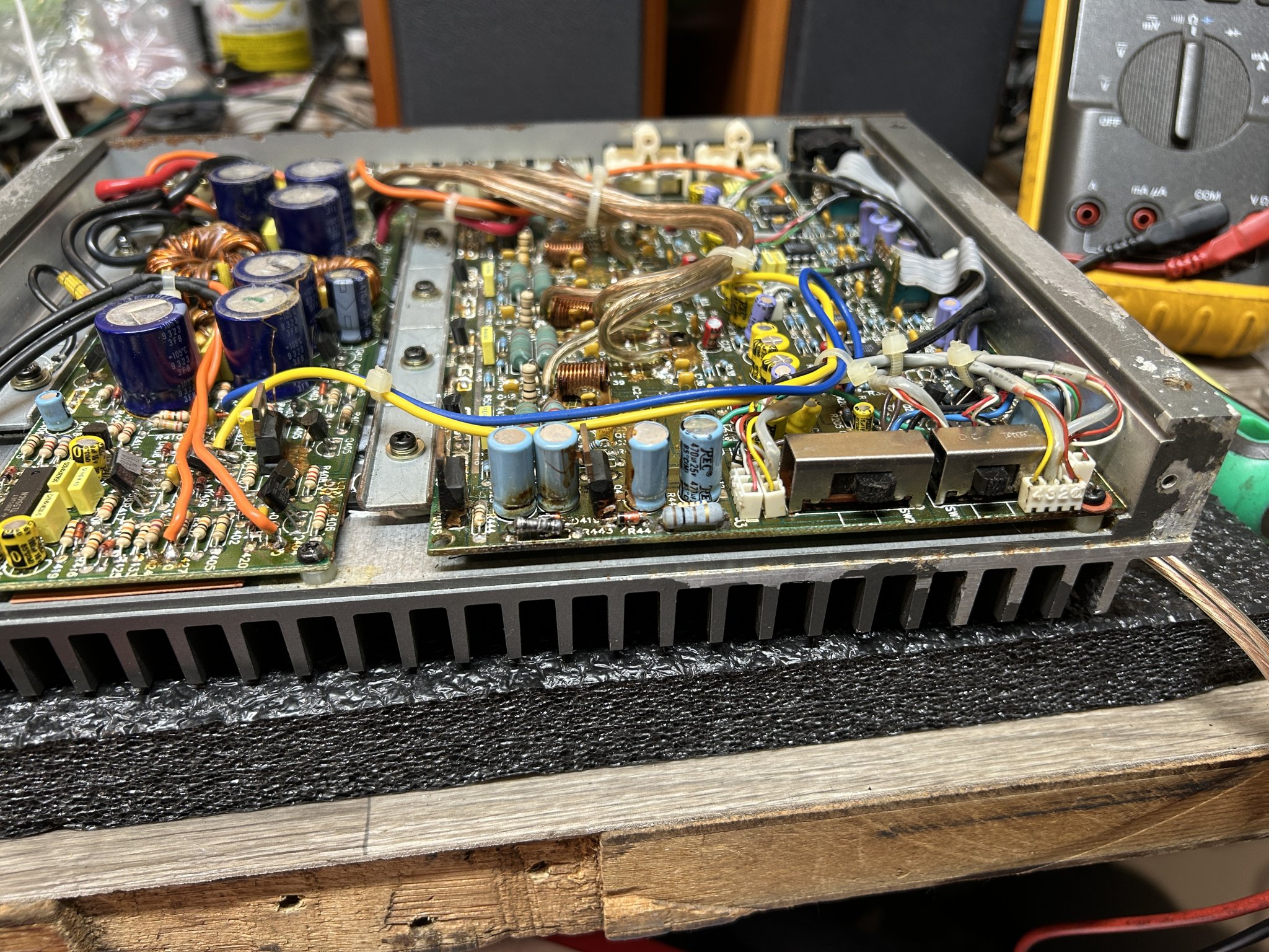

So I opened it up and the most obvious thing I see is this destroyed resistor.
I'm still working my way through Perry's tutorial, I have been reading a few pages every night trying to work my way through it finally.
But for now I am assuming that the burned resistor is the same spec as the good one to the right, so I ordered a few 1W 100 Ohm resistors. I will pull the board this weekend and start removing the resistor and also testing the other components nearby.
I'm thinking that the transistor near it has shorted causing too much current through the resistor. So I'm assuming I will need to replace that transistor. There is also a Zener Diode behind the resistor that I need to test and possibly replace. And I ordered some capacitors to replace the two that might have been damaged when the resistor burned.
I'm also guessing it makes sense to replace the components near it that look to be for the other channel? Since I'm in there.
I don't have a schematic for this amp and haven't found one online. There are a few ADS photos in Perry's tutorial but none that match it exactly.

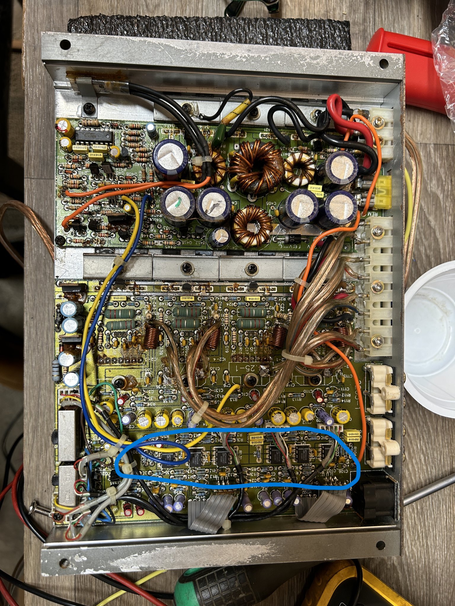

Do you read 0 ohms between one end of the resistor and either power supply terminal of the op-amps?
You look like you have a current boost transistor shunt regulator. The PQ10 has only a basic shunt regulator for its single op-amp.
Are 443 and R444 serving the same purpose (feeding the Zener)?
Did you check the resistance across that fixative?
I did check the fixative, it is slightly conductive. Like 6-10 M ohm.
Are these the op-amps you're referring to? Circled in blue. I can check that next.
I'm not sure if R443 and R444 are feeding the Zener, but I will check votages around there as well.
OK between either leg of resistor R443 (the burned one) or R441 (the good 100 ohm resistor) and B+ on Op-Amp 5 I get 0.39 M ohm.
And between either leg of R443 and R441 and B- of Op-Amp 5 I read 1.4 M ohm

Last night I pulled off both resistors and removed one end of both zener diodes. One of them was bad, it reads 0 volts in both directions. The other tested correctly, 0.7V in one direction, nothing in the other.
I also removed one of the transistors and was able to read that it's a TIP 41C, so I will order a few of those. I ran out of time before I was able to test the transistor. It was also a major pain to remove, I need to improve that skill.
I'm still feeling like a parts swapper, but the various pieces of the amp are starting to come into focus. I will keep reading while I wait for the transistors and any other parts I need to come in. Then hopefully I can swap them back in and test it again.
One regulator is NPN and the other is PNP, very likely. TIP42 would be the other one. MTX is one of the few amps that don't use complementary transistors. The datasheet will often show complementary transistors. Sometimes, the datasheet for one shows both (TIP35 and 2n6488, for example). The TIP is in the 'semiconductor datasheets' folder.
