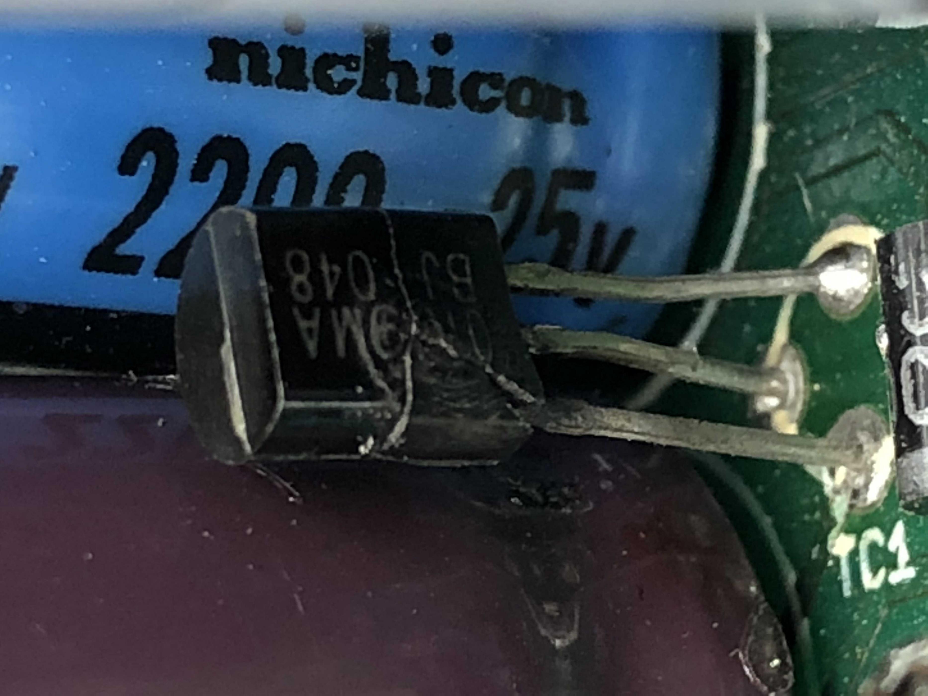

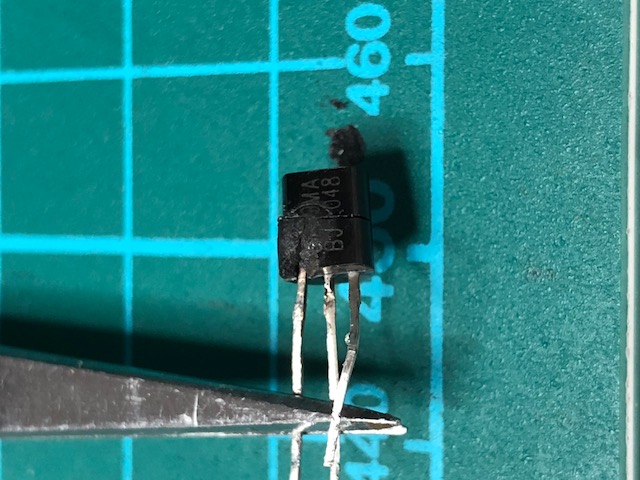

After receiving this preamp, I have noticed that the +15V was missing on the OPA2134 but the -15V was clean. Thinking that it may be the 7815, I have replaced it. This let the magic smoke escape in one of the transistors which was right after the AC input. Since the transistor is damaged so badly that I can not read the code anymore, with my utterly limited knowledge I can not figure out what it is. The only remaining text on the front face is "BJ 048" on the bottom line and the top line ends with maybe a "0" followed by "9MA". Can anybody help me solve this mystery? It was a TO-92 package.

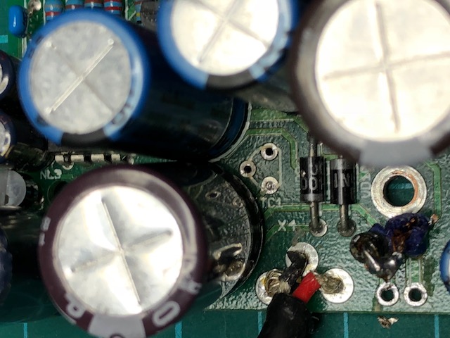

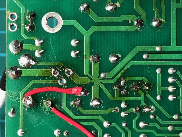

Let me explain what I have attached. This is a dual sided board, the top layer has no connections to the transistor terminals. At the back, there is a 3 pin connection coming from the AC power supply. The two pins on the left share the same pole. These are the ones that get connected to the two terminals of the blown-up transistor. The remaining terminal of the transistor ends up in the NE555 circuit. I think this is a part of the high voltage circuitry to run the 12AX7s.
Please let me know if more pictures are needed.

Thanks for the pictures.
So a triac. That changes things somewhat 😱
It looks like the gate (middle pin) goes off somewhere (your 555 circuit ?). This is all guesswork without a circuit but I would try and see where that cable goes. The soldering looks a bit scratty (technical term 😉). Is there a short between the red wire and the braid ? Are those two diodes OK ?
Triacs are pretty tough and so whatever happened looks like a catastrophic overload somewhere.
I also can't see any connection between the missing 15 volt rail and the triac... unless there was a short on the rail and that is why it was missing.
This is one that definitely needs a full circuit diagram to figure out.
