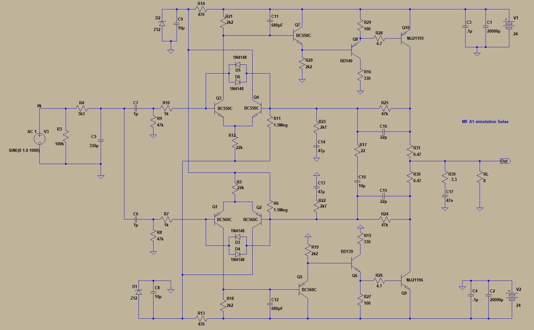

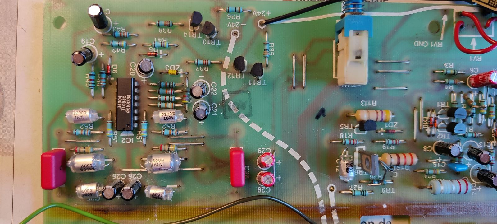

In my sim I had about 800mA bias with 3.8Meg resistors. But probably can be caused by different models.I tweaked them values to get proper bias current with the LT Spice models. In actual amps they are higher but also also possibly differ between editions?
No, not matching output devices. More like adjustments on resistors in case one channel was running much differently in bias mA than the other.I have played with it in LTSpice as well while working on it.
Since the A1(X) only has one NPN/PNP pair per channel, matching of pairs is not possible. Maybe you mean positive and negative to have as little DC as possible? I actually had planned to measure the DC and forgot 😆.
Will do the next days.

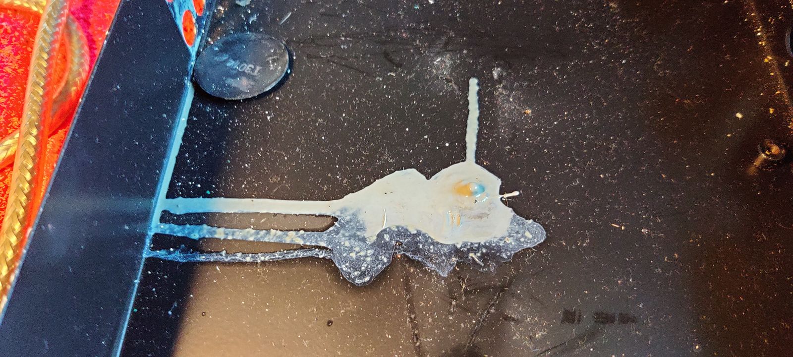

But I will not open the beast and reapply the thermal grease again, unless the offset is really high.

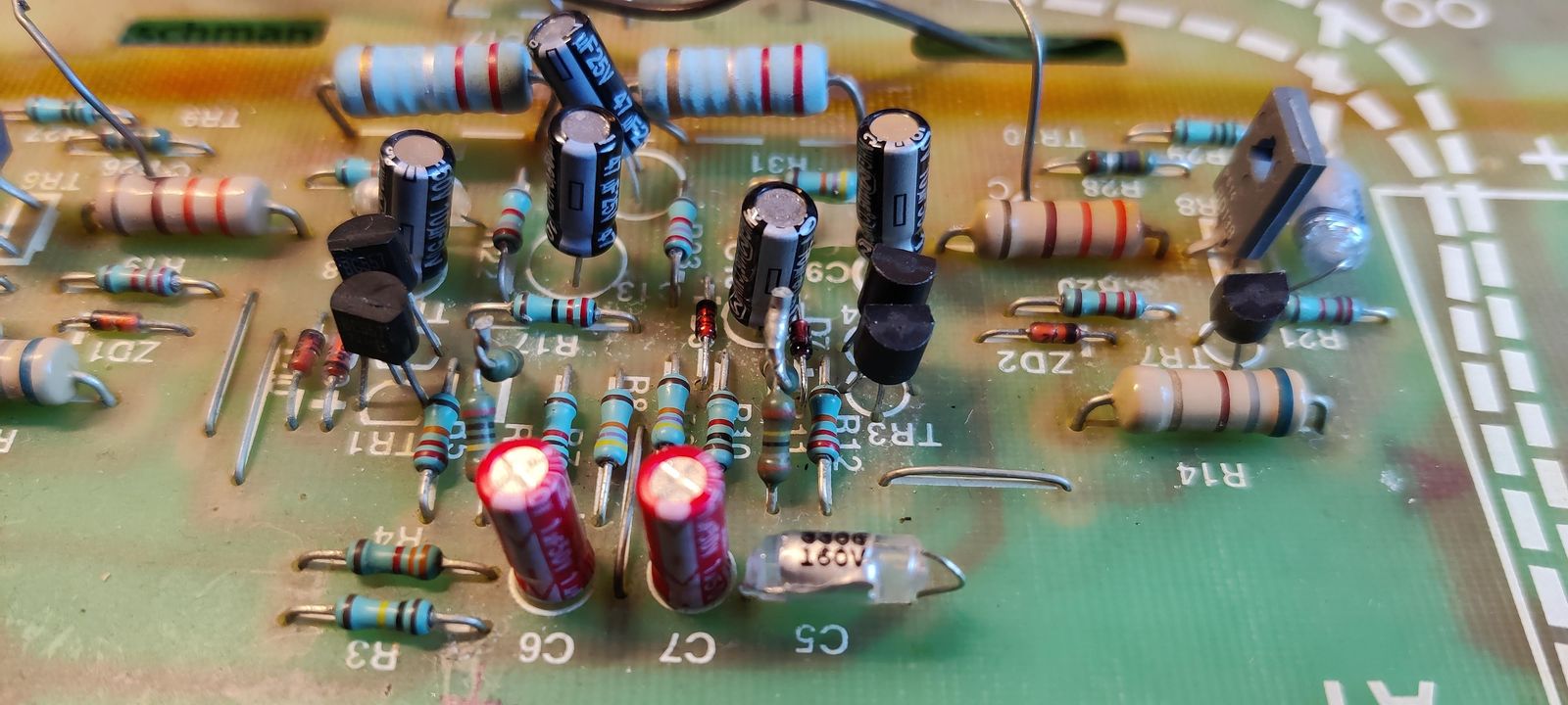

745mA with 1.5 Meg in mine. 3.8Meg squeezes it down to 302mA. Could get 585mA with 3.8Meg if I replaced my 0.47Ω emitter resistors with 0.22Ω. As I saw two red stripes on your emitter resistors photos. 2.7Meg & 0.22Ω would do 812mA. But the MJ21195/21196 sim models I used wouldn't know peculiarities of the amp's circuit editions and its actual type semis in the little inferno box. 😉In my sim I had about 800mA bias with 3.8Meg resistors. But probably can be caused by different models.
90dB spkr sens definitely helps. A friend had the A1 for years. I had listened to it with various speakers. Not much resolution by modern amp standards but enough to get the message across. With a particularly pleasant tone in a British signature way. Looks were unique and iconic too. 2023 reissue in a wider box as redesigned by MF and made in Taiwan is better done. Has more PSU reserve, better layout, -10dB line direct switch, a volume remote. Not too badly priced either considering things classic audio tend to be much overpriced today.Yeah, I saw in my simulations, that the amp is not ideal for 4 Ohm speakers. I am using it with 90dB 4Ohm speakers at the moment and it can play pretty load and still sounds fine to my ears.
@Salas, I played with various BJT models (which are used in schematics flowing around the net for the A1) in all stages of the amp. Bias varies only a little. Here are the end BJT models I originally used. But as I said, also with MJ21195/MJ21196 bias is comparable.

With the models you just posted my sim gives 0.73A Iq for 3.3Meg front and 0.22Ω output emitter resistors. Also better DC offset than with my MJ21195/MJ21196 models.
756uV DC offset for me. 10.45mV before. We are getting much closer, maybe some differences in our BD & BC transistors models remain.
Yes, reliable enough.In general I was pleasantly surprised how realistic the sim values were.

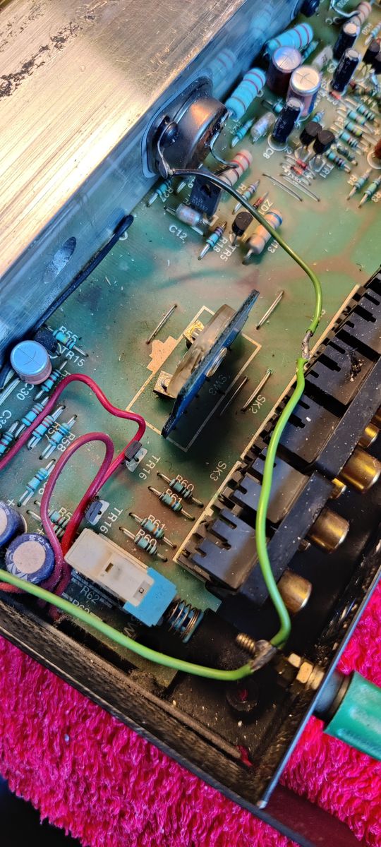

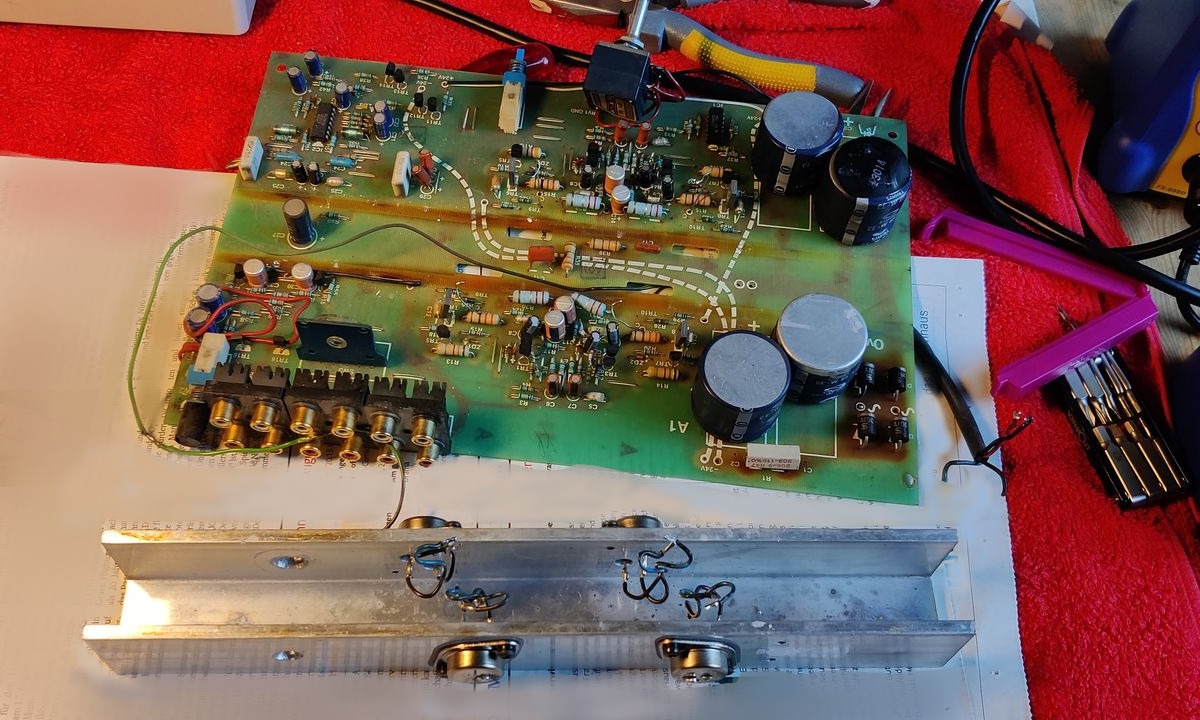

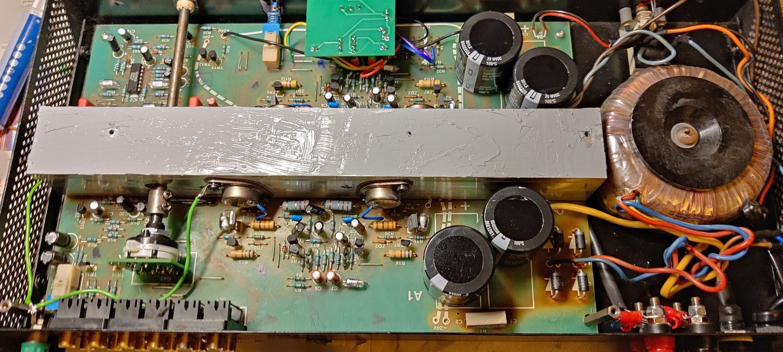

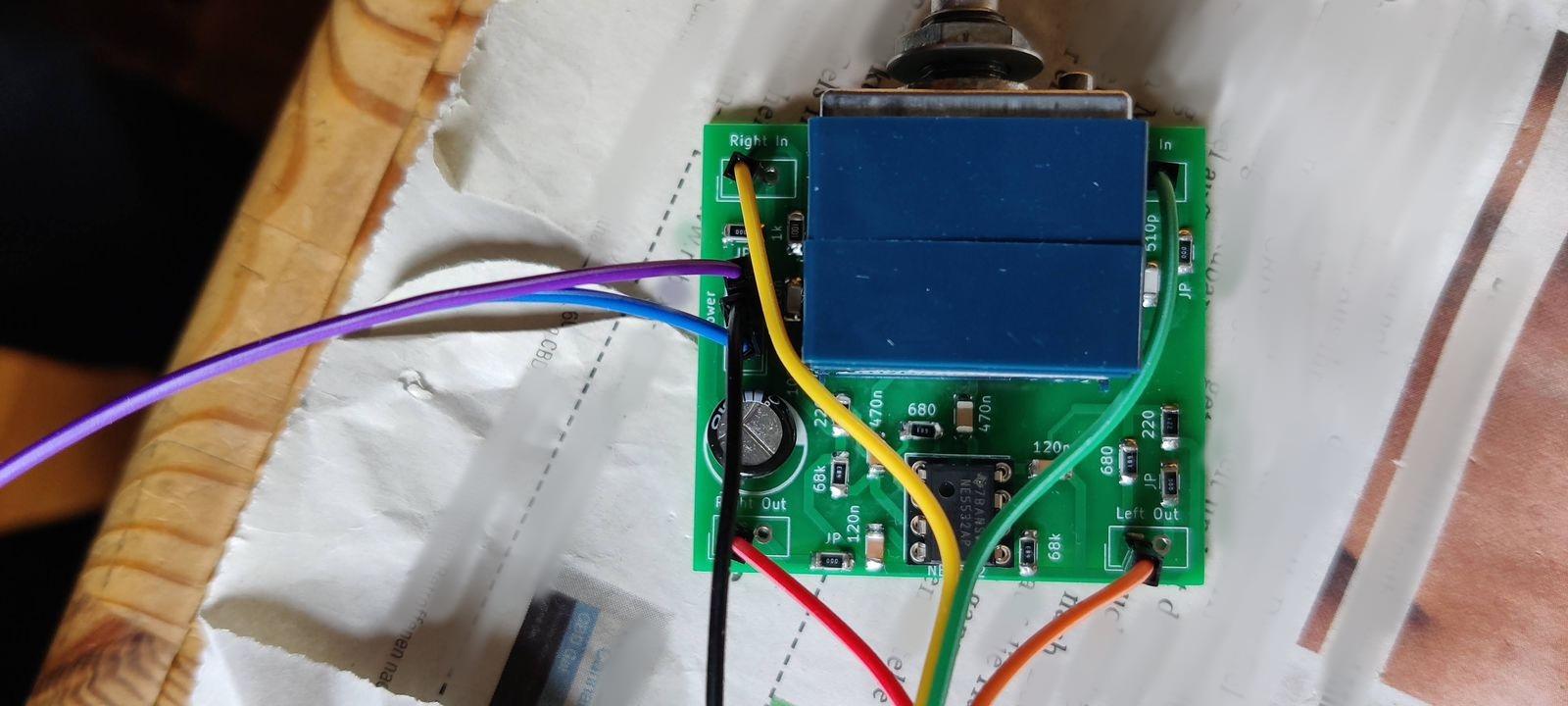

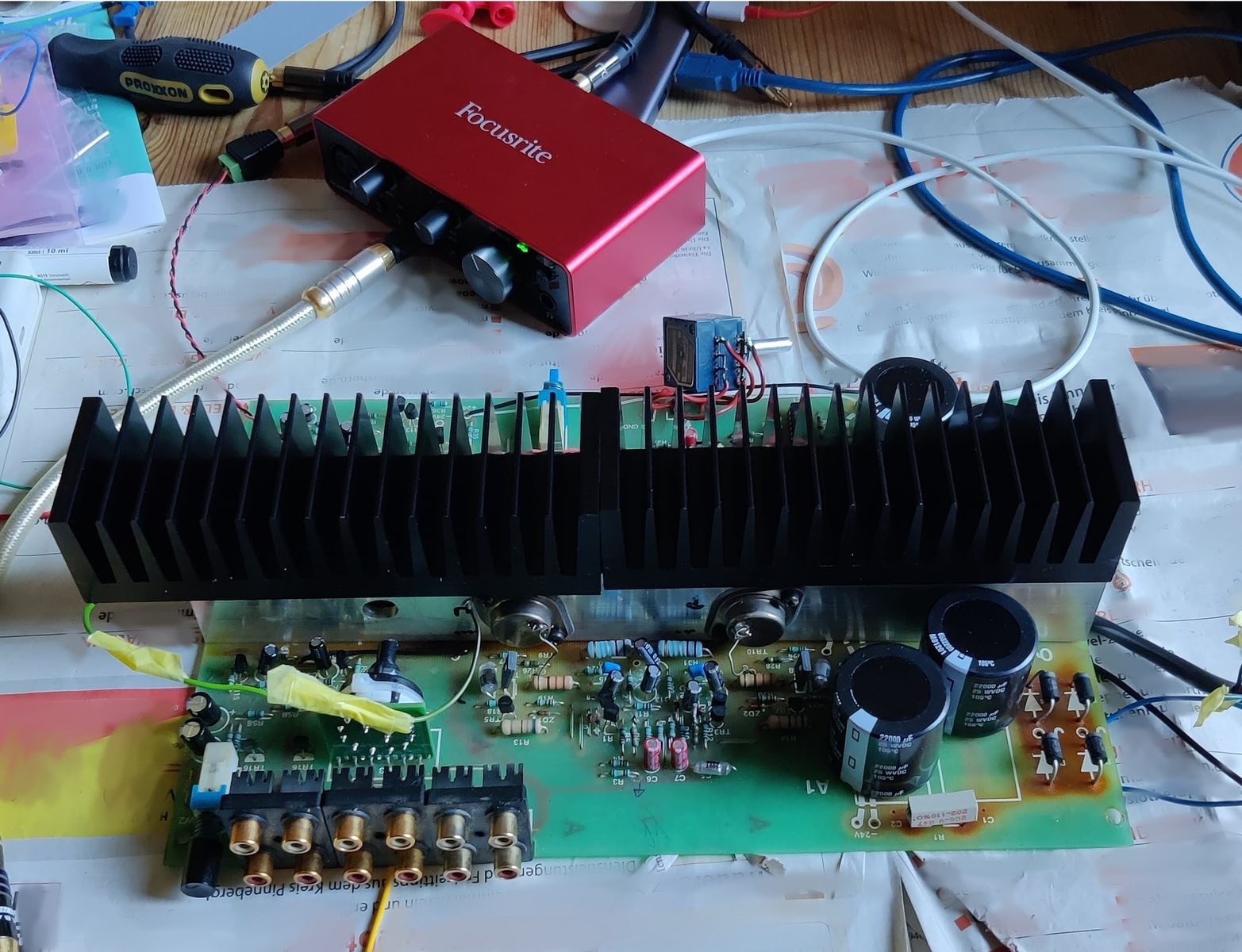

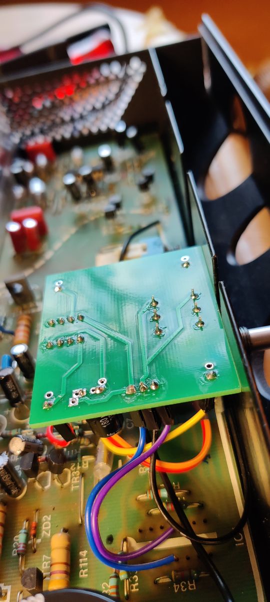

You did a very good restoration of a deteriorated and badly tweaked unit. Along with Mark Hennessy's line/volume alternative you included on a nice custom pcb it should be a quieter & more reliable, more pleasing than stock, little warm tone amp to use for many years. Congratulations for your work and presentation.

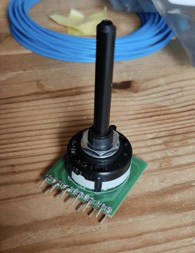

Hi,mz543578854..
I want to know where did you buy source selector switch and attached small pcb?
Thanks in advance.
artzyo in Seoul.
Thanks in advance.
artzyo in Seoul.
Hi Artzyo, not sure if they ship internationally.I want to know where did you buy source selector switch and attached small pcb?
https://www.platinencenter.de/de/product_info.php?info=p20_komplett-bausatz-drehschalter.html
