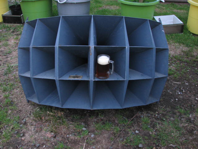

One of my Gaumont Kalee horns has a crinkle or dent on the front edge, which I’d like to repair without doing further damage, the original damage is from dropping the horn on one of its front mounting brackets.
I’m curious to how others here may have gone about removing dents, being the horn is 2 skins and possibly tar filled?.
Does anyone know how the 2 skins were bonded, are they soldered?
Any help appreciated, I can upload a picture or two If required

Here's a pic, hope it illustrates what I meant, I’ll have to drill out the rivets if it requires disassembly
Heres another pic
Since it is the inside of the cell that matters I would use a small hammer of no more than two ounces to very lightly tap out the damage. I mean tap not hit. It should be done extremely gradually. Hundreds if not thousands if taps. No two taps in exactly the same place. Properly done it should leave a reasonably smooth surface requiring perhaps a sanding. But I wouldn't sand it.

If the mounting bracket is removable, that's step one.
It's sheet metal and not likely tar filled between what you call the skins, so you may be able to form it partway with crescent wrenches and/or duckbill pliers before proceeding as Ed has suggested. I would then turn it damaged side down and support it on a buck or anvil. There are specialized bodyshop hammers made of metal, wood, plastic and rubber that are common and easily sourced.

Just found an ex panel beater selling a bunch of hammers so I grabbed them, here goes another learning experience, I’ll practice on something else first...
