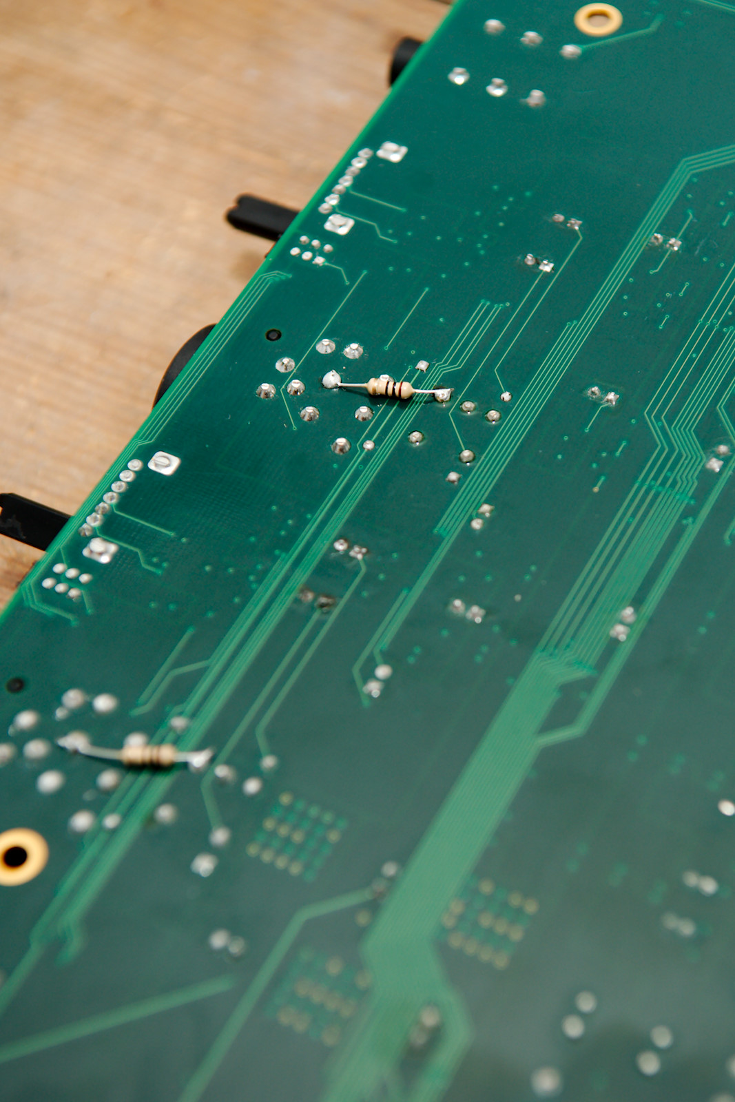

Ok, I'm back. With good news -- the preamps are fixed. Everything is crystal clear 😀 :sax:
The short story: a faulty RA43 breaking the circuit, with the exact same fault in the other preamp; see pic for the fix.
The full story
You remember I had a cheat where the noise seemed to disappear if I put an capacitor between point A and ground. I repeated that with a 1000pF capacitor (instead of 0.47uF), effectively replacing the one in the schematic that I thought might be faulty -- but it had no effect.
Then I tried just a piece of wire; shorting A (effectively IN-) to ground, and got the same effect; the noise almost all disappeared. I noticed the speech seemed to be exactly the same volume. I shorted B to ground, and the speech disappeared but the noise stayed the same; looks like IN- is carrying noise, and that IN+ was the signal, and so UA9 outputs a nice little mix of the two.
So started tracing the few points between XLR and point A that I had not yet tested (sgrossklass suggested this) and found a break at surface mount resistor RA43.
I tested a resistor in place of the break and all the noise disappeared. A working preamp. I suppose the entire IN- side was acting as an antenna to pick up noise.
But this leaves one final puzzle: since it's not a common piece of circuitry then how could both pre-amps break in exactly the same way? The source of much confusion
Take a look at the attached picture of the faulty surface mount resistor, RA43. It's placed slightly under the XLR socket, and it's the only component in this position; RA42 is not touching the XLR socket. The other preamp on the board is exactly the same physical layout. Could a physical fault result from plugging and unplugging the XLR, causing the surface mount joint to fail? Perhaps I am on to something, I thought!
So I made my fix permanent (see picture) and then to eliminate a possible return from the dead, carefully removed the surface mounts.
But the puzzle remains! Because the removed RA43 is not functioning; there's no continuity across it. So it seems that RA43 has failed, and the exact same has happened in the other preamp. And RA42 is not affected. Answers on a postcard?
Many thanks for all the help. I've learned a lot here, and I hope you find the conclusion equally as interesting!
Yes, its very common for pcb mounted connectors to fail mechanically, its best to have connectors fixed securely to a metal chassis mechanically. Here the stress from the connector has flexed the pcb nearby and cracked the resistor. In hindsight the resistor should have been sited futher away. Some people break connectors and pcbs more efficiently than others!
