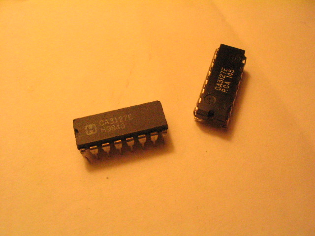

I had finished successfully the repair of my TEK-2213 scope after replace the CA3127E. Now I return to the audio DIY😉.
Thanks for the help of Ashok,EC8010.
X.G.
In the below pic,the left CA3127 is new one from my friend,the right is the blew one.
X.G.
