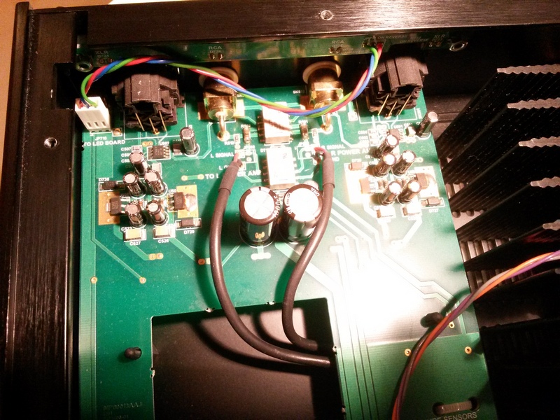

I was working today on the same amp that had a bit of buzz in the left channel. I was swapping the signal input cables to locate the problem and managed to plug in the R signal cable in IDLE connector JP104 (assume that is the bias measurement spot). Instantly after power up I had smoke from the area where the JP104 is and both R channel 10A PSU fuses died. After replacing the fuses R channel is dead. Can anyone point me in the right direction in fault finding while I am settling down and dealing with my range and stupidity.
I did measure output devices (soldered) they do not show any signs of shorts - both source to gate and source to drain pass a MM diode test - identical on both channels.
The signal device at the time was an mp3player with output R=2 ohm C=174uF and L=146uH measured with an LCR meter @1KHz. So essentially a short.
If it was the bias test point that you connected to an input cable then you may well have shorted the positive rail to ground via the low value 0.33 ohm sensing resistor that is in series with the output devices. There is a similar resistor on the negative rail too but with no test point access to it. If that is what happened then the resistors will have failed. If not then you have an uphill struggle as you would have to identify on the circuit exactly what this plus connected to and shorted out.

What is the chance that I did damage the output devices? Was there any consensus on the suitable replacements?
Yes I had both channels connected - now the other channel still works fine. I was looking for the burn marks and smelling but could not detect anything - a little bit of smoke came out. I did check most of the transistors and they seam to be fine - will try that IRF9610 next.

It looks that the problem could be in the signal input side - I measure 100Kohm resistance at the L side and a short at the R side without having input cables plugged in the main amp board or having anything plugged in the amp. Both input relay coils measure correct resistance. Not sure if the other input circuit is for the balanced only or RCAs as well
I've no quick answers or fixes I'm afraid. You are going to have to start with the basics... check the rails are correct, check the output DC voltage is essentially zero (no offset) and that the output stage is passing the correct current (measured across the 0.33 ohm... compare it to the other channel, don't alter any presets).
Those tests will show up any failed output devices.
If you can measure this huge descrepency between left and right inputs then that is perhaps the place to start with some basic checks and tests. I can see what looks like an opamp on there and what could be some discrete regulators of some sort.

Just confirmed that both output stages are 100% fine. Readjusted idle current a bit but there was no damage to them. However, only L channel input is functional - the R one remains shorted (hence no sound at the aftermath test - sorry for being hasty). I tested the channels by using the L input only and plugging it in each output stage at a time.

There is a small SMD 100K resistor (input load) across the input + and GND. It seams to be dead on the R side. Will try to replace that first.
