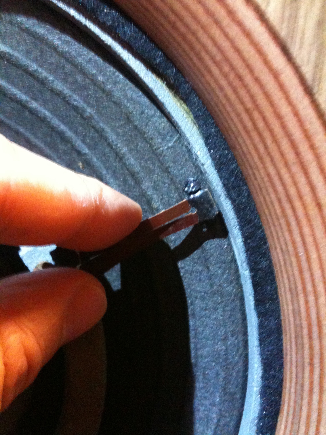

My stupid enclosure maker broke the glue adhered between the paper cone and the cantilevers when installing the driver to the enclosures. 🙁 almost want to kill him!!!!😡
Do any high hands here can halp and suggest which kind of glue i should use to stick the cantilevers to the paper cone. Thank you.

Thx Gary. I have contacted them but no response from them. I attached a photo here and would like to ask any High Hand can help. Thank you.

That does not look bad at all.
I think it is pretty common damagefor Axiom 80, and does not any kind of permanent/irreversible damage if repaired correctly.
I remember that epoxy based glue was recommended stuff for that, but just in case I'll check that yet. ( EvenLoctite?)
I think you should not to try to remove old glue, just use _very_ small amount of new glue.
I've fixed ( got fixed) two similar damages, and the only thing needs to be taken care is the alignment of the cone. The cone might have twisted in wrong postition if supported only with two cantilevers or it might not. The first repair I did did not needed realignment, the second needed a litte.
2- component epoxy based glue was recommendation I got from the guy who made last similar repair to my driver. Cant' remember what was the glue I self used at first time I needed to make this repair, I guess it was just ordinary 5 cent loctite superglue. But that's not a recommendation.
Pay attention to working- and drying times, some varieties have drying times up to several hours, and I guess you do not want to hold them together for that long time.
Also some qualities are sensitive to warming, you can speed up drying with blowing hot air in the seam.
And dont forget to chek the alignmet. I'd say it's 50/60- chances it requiers adjustment, or maybe not.
