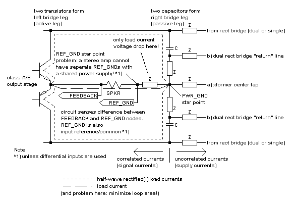

First, I'd say be careful about relying a power chip's PSRR to fix anything (unless you go full class-A and full bridge == clean rails by design). And the major problem is not PSU hum/buzz -- which, if some filtering is applied to it, seems to be rather benign in spectral content and will be PSR'd away --, rather the load current induced disturbance (which is halve-wave rectified stuff) is making the troubles and needs to be adressed with proper decoupling.
While isolating input GND is always a good thing (using xformers or differential inputs), it doesn't help any supply side grounding errors in the individual amps. Also single vs. dual bridge is not the point IMHO (I prefer dual -- lower voltages on the diodes, schottky type).
They key point is that any amp is a bridge circuit, one leg is the amp's output, the other is the supply. And the shared lines between them on the rails are halve-wave rectified but combine to the laod current in the speaker lead. Therefore the reference ground point must be choosen that any voltage drop due to finite impedance is only of signal correlated nature but shall not contain any rectifed supply currents. This where the star-on-star ground scheme comes from, with the signal star seperated from the power star with a single piece of impedance (and be it as little as the impedance of a bolt-washer-nut combo). The power star point is also the return point of the local bypasses, here the key point is to minimize inductances from loop areas with the speaker line. Pls see attachment.
To any true op-amp (thus to all chip power op-amps) GND is a virtual concept. In the LM3886, the GND-input is only a reference voltage, to set the mute/power-up output voltage and for the mute logic itself, plus it probably serves as potential for various internal biasing circuits. Not load/output currents involved, and no necessity to actually connect it to GND (because sometimes there isn't one anyway). They'd better called it REF instead of GND.
- Klaus

[edit: related question: do the chip amps typically push/pull through the ground, or is the ground treated as a low-current reference and the charge is moved through the V+/- rails?]
Any single ended amplifier will have currents flowing from V+ to ground for output voltages higher than ground and ground to V- for output voltages lower than ground. Bridged amplifiers have currents flowing from rail to rail.
Edit: Nice diagram Klaus :up: It shows the current paths of the single-ended output stage and supply caps very clearly.

KSTR said:
First, I'd say be cerful about relying a power chip's PSRR to fix anything (unless you go full class-A and full bridge == clean rails by design). And the major problem is not PSU hum/buzz -- which, if some filtering is applied to it, seems to be rather benign in spectral content and will be PSR'd away --, rather the load current induced disturbance (which is halve-wave rectified stuff) is making the troubles and needs to be adressed with proper decoupling.
"Load induced disturbance": Are you referring to common-mode sag on the rails, or the current draw on the rails causing the ground to shift at the source (the power supply) due to non-ideal conductors? I don't see why that would necessarily happen; In Fred's diagram, it would require R1 and R2 to be nonlinear.
Oh, wait, no, I do see it-- because a load current change in R1 doesn't mean a balanced load change in R2. So there is a potential shift across all the load 'bridges', coupling the load signal from one channel into the other channels. It doesn't have anything to do with internal PSU noise, it has to do with PSU topology encouraging channel cross-coupling.
That applies only to multi-channel amplifiers drawing from one power supply, but I see it.
- Klaus
Ah, but the chip is dumping current to ground through the speaker. That was a different way of putting my previous question and answering it, also 'what BWRX said'. Of course, now that I see the diagram, it's obvious that there was only one possible answer to that question.
[edit: Oh! related question: the note 'problem here: minimize loop area!' implies that, eg, the voltage rails would also benefit from being braided? Ground return included or no?]
For a supply with dual secondaries and dual bridges twist the the V+ and Ground wires together and twist the Ground and V- wires together. The loop area on the PCB also needs to be minimized, which means you want to place the local electrolytic caps as close to the chip's power pins as possible, and have the speaker ground and the two secondary grounds as close as possible.
My LM3875 amps use a supply with dual secondaries and dual rectifiers with large electrolytic caps close to the rectifiers. The power and return lines for each rail are twisted together (to minimize loop area) and routed to the amplifier modules where the bridge grounds and speaker ground are connected through a ground plane on one side of that part of the PCB. On the PCB I use one 470-820uF per rail as close to the chip as possible to keep the loop area between the local tank caps and the supply pins as small as possible. The signal ground uses the ground plane on the other side of the PCB and the ground reference is at the plated through hole of the speaker ground.
I would braid the V+/GND/V- wires together, but the large capacitor charging currents will mainly be flowing through the V+ and V- wires for a center tapped secondary with a single bridge (with an ideal center tapped secondary, ideal caps, and equivalent resistive loads across each capacitor no current would flow through the center tapped ground wire).
