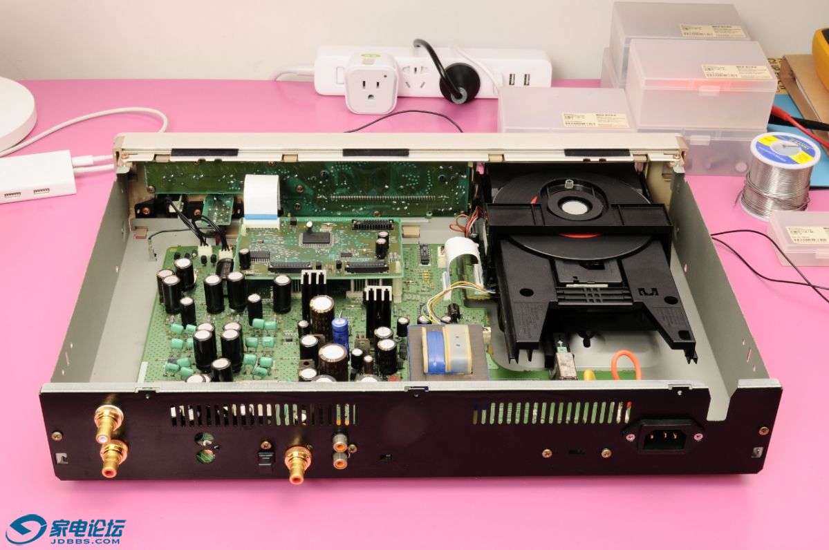

Ten years ago,I buy earphone in a shop, shop test earphone use maranta CD player:CD6000.After I listening,I felt the sound of CD6000 was very bests and I decide to by a CD6000 at once.but boss tell me that CD6000 has halt production,late I buy a second hand CD6000 online shop.because my work was very busy that time ,I didn’t test the CD6000,after eight years, now I use the CD player, I feel the CD has already aged,I decide to renovation CD6000 by change electric capacity, then capacity of CD6000 is all of ELNA and some of them is ELNA SILMIC,i have used lot of ELNA SILMIC II many years ago ,it show very warm sound like electronic tube.I buy all new ELNA capacity of CD6000 now, next times I will change capacity of CD6000
The RCA socket of CD6000 was oxidized,I drill three hole on back of CD,and install gold-plated RCA socket, it was looked very beautiful

Thank for your recommended, I hope restore original sounds of CD6000,so i use ELNA caps to replace all caps of CD6000, I have replaced tow 470uF/35V(SILMIC 2 Super Gold) caps in power supply, the sound is improved a lot, but after other big caps were replay,then sound became blurred,so I am buy Philips caps online store.

I have finished changing all caps of CD6000,less then 1000uF caps, I used ELNA SILMIC 2 , and changing went well, but three caps:4700uF,3300uF,1000uF in the power supply,i first used ELNA,the results were not fine, then i use Nippon audio caps,the results are very fine, now i have run CD6000 for 30 hours, but the sound effect is changing when CD6000 is playing,it seem that need more running time to stabillze the sound effect,may be need 100 hours, after stabillze ,I will describing the sound effect of changed caps, the below photos are changed all caps of CD6000

After 50 hours I found the sound has also began stable, during burn-in time,I bore holes,install three gold-plated RCA socket and a power point,and spray paint rear board of CD6000,now I have completed renovating CD6000.

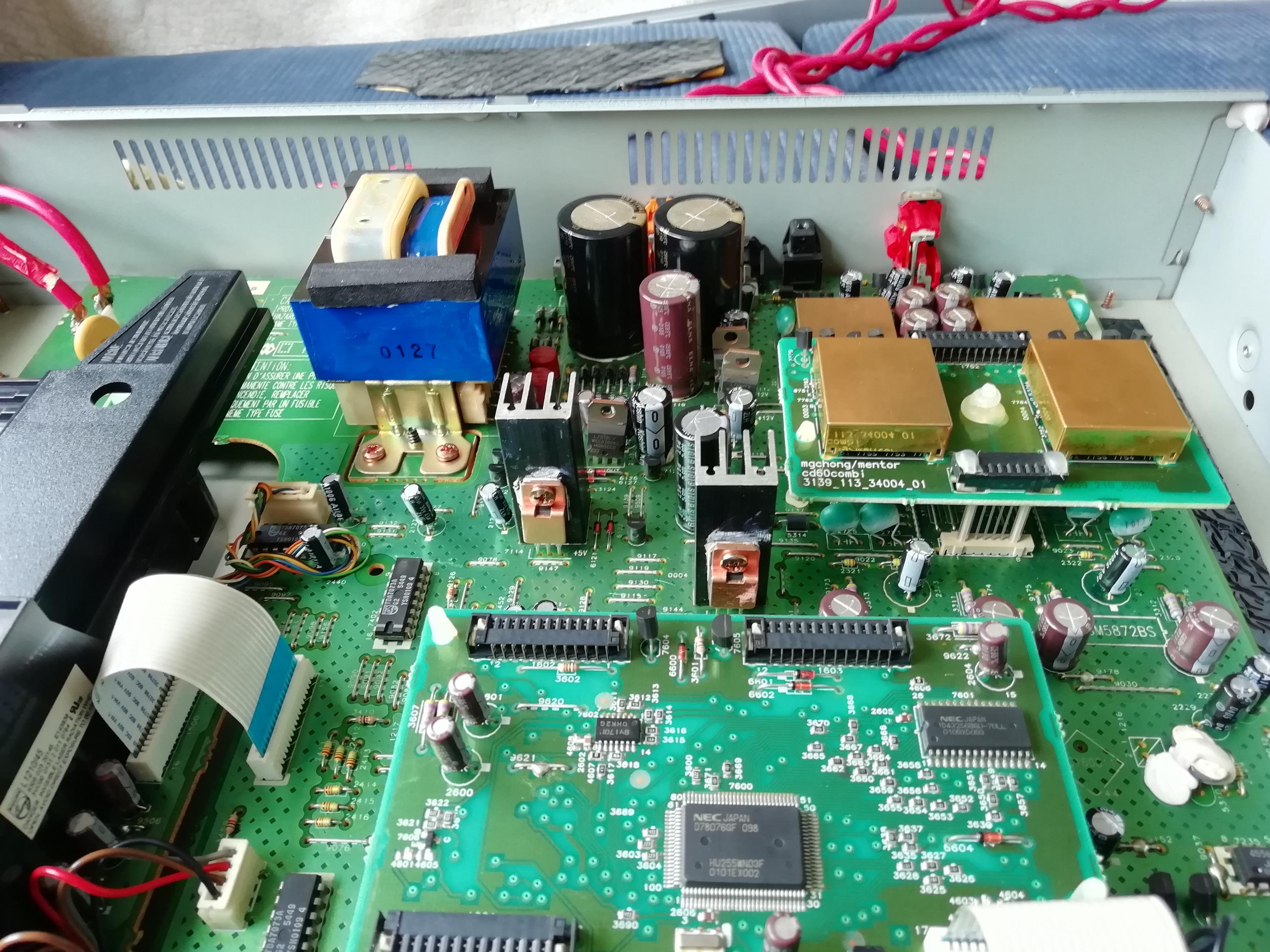

I've got no pics of my finished OSE, but here's one of when I tried some Rubycons before all Panasonic FR in PSU and Silmics 2s in signal paths for huge improvement over Rubycons
