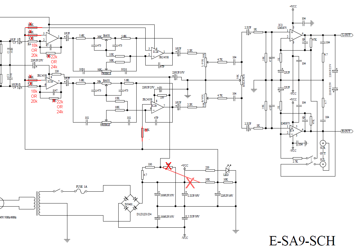

I'm trying to fix a Renkforce E-SA9 that is noisy on one channel. I know the amp is crap and worthless but I'm determined to fix it.
The right channel works fine but the left channel is noisy. The source signal can be heard but is drowned in hissing white noise (no popping or crackling). This is the only schematic I can find for the amp (attached below): Renkforce E-SA9 Stereo amplifier 2 x 12 W Silver (metallic), Dark brown | Conrad.com It's not quite accurate since some of the caps are electrolytics on the schematic but on the actual board are surface mounted non-electrolytics. Some other electrolytic values are different.
I'm using a signal generator app on a tablet to send tones. Probing around with an earpiece I can hear the noisy signal on the output cap of IC2a pin 1 (red arrow below). There is no noise on the same cap on the right channel (green arrow) which uses the other opamp in the dual package.
I've replaced both JRC4458 dual opamps and the red arrowed 10uF SMT cap. I've lifted the supply pins 3 and 5 of the output LM1875 in case the noise was coming from the output amps. The noise is still there.
Any ideas what might be causing it, what might be worth changing?
many thanks

Hissing might be ultrasonic oscillation - check the 47pF feedback caps on that channel, check the supply bypass caps are OK. Each opamp needs ceramic decoupling caps though I don't see that in the schematic. Consult JRC4458 datasheet for details.
BTW the 100k resistors on all the non-inverting opamp inputs are contributing to the noise-floor of this device, they ought to be more like 1k. I'd also be tempted to decouple all those non-inverting inputs at the chip so they can't act as antennas for EMI or even unwanted feedback.
It would take quite a bit to send a 4558 into oscillation.
Actually a bad connection (or resistor) in this leg would also be causing the hiss as observed. Some continuity testing and resistance measurement is in order.
The choice of 100k there is indeed puzzling. Not sure why they felt the need for any resistors in these spots at all, it's not like a 4558 is a super low noise part with super low input transistor Rbb'. I would suggest trying to eliminate (short) all 4.
What's also puzzling is that opamp +Vs is derived via a 335R/430R voltage divider from Vcc, but Vref = Vcc/2. Why? It's not like you're drowning in voltage headroom to begin with. Probably not the most seasoned designer at work there. I hope they didn't muck up the LM1875 layout too badly.

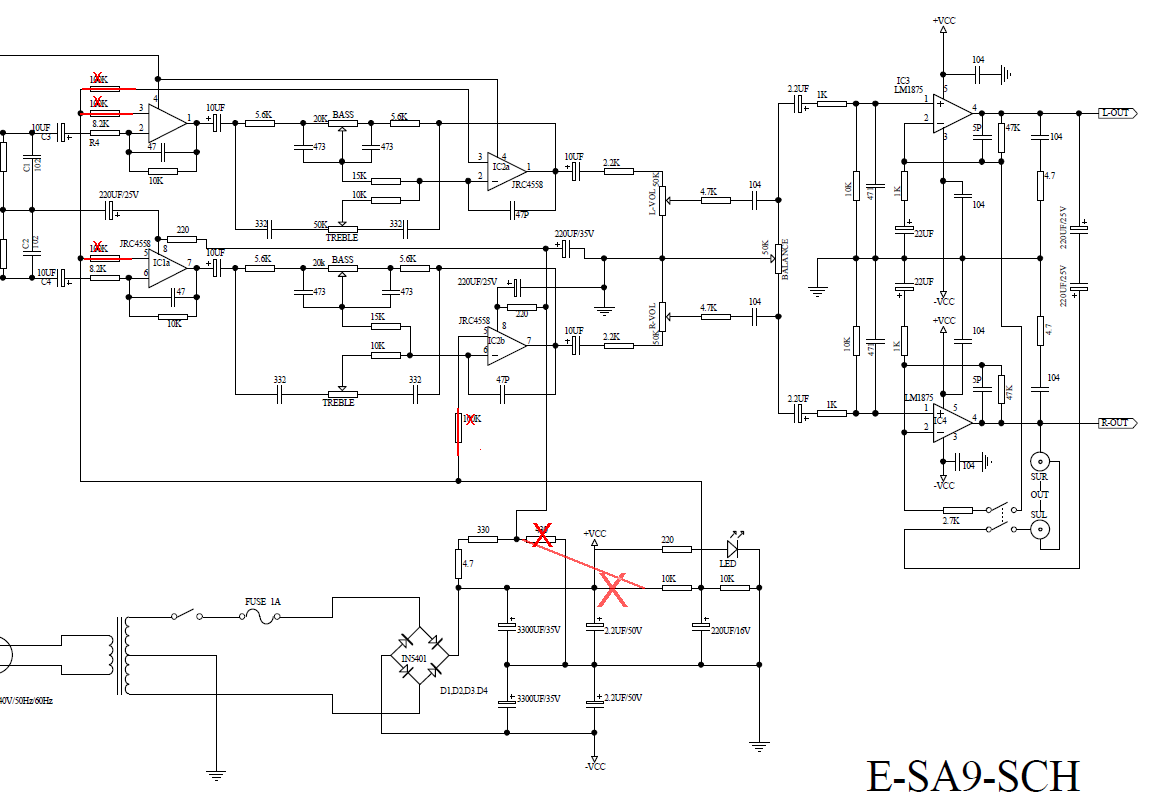

When you are doing the 100k delete, I would suggest taking out the 430 ohm entirely as well, and then reconnecting the 10k/10k divider there (lifting a resistor leg and then running a wire over to where the 430R was should do the trick). Like this:

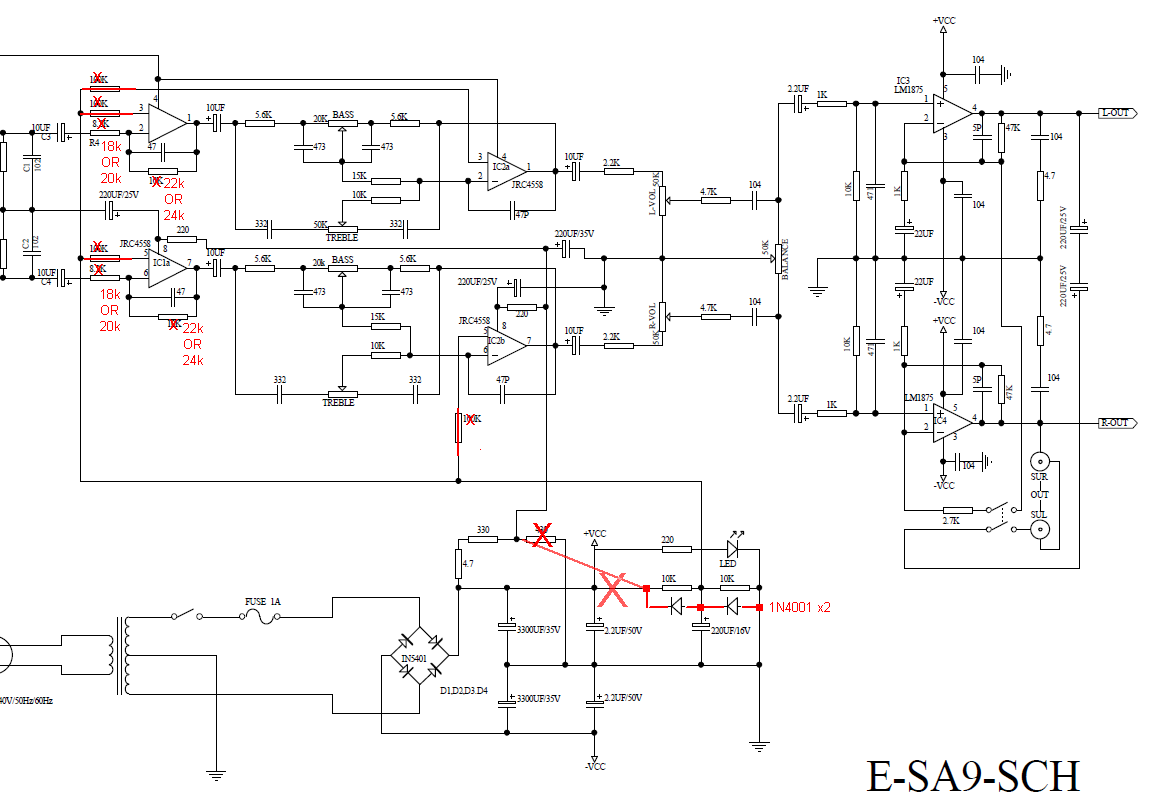

One more tweak that should improve distortion performance and increase input impedance along the way.
The 50k vol / balance pots and the 10k power amp input impedance aren't exactly what I'd call a good match. It all looks like a copypasta hodgepodge really.
OK, so maybe we should give the Vref generation some protection diodes to safeguard against power up/down gremlins (which may have been why they had these 100k resistors in there). Actually I think 1N4148 would be fine, too, or UF4001 Schottkys. Maybe they can be tagged in underneath the board. I think I'd put these in and check whether anything bad happens at all, maybe it actually doesn't. Power-down would be my main worry.
Thanks for the replies to this. I never fixed the amp and gave up, I think it had multiple problems. I suspect I broke a track changing the 4558 op-amp and had no way of fixing. How do you remove those SMD amps without lifting the tracks?
Hi! I would suggest bypassing the preamp section completely, it is a very poor design. Remove the vcc/2 resistors and all that stuff. Run the chipamps at 20k/1k gain according to the datasheet. I added a dual volume pot followed by a simple 5532 stereo gain stage, powered by the DUAL psu and a pair of +/-15V regulators. Replaced the faulty 3300uf psu decoupling caps by 4700uf/35v. It's now very quiet. After a few adjustments, I measured 0.028% THD+N @ 1kHz, 20Watts output in a 8ohm load, not that bad. I like this small enclosure 🙂 I use it a lot! cheers
