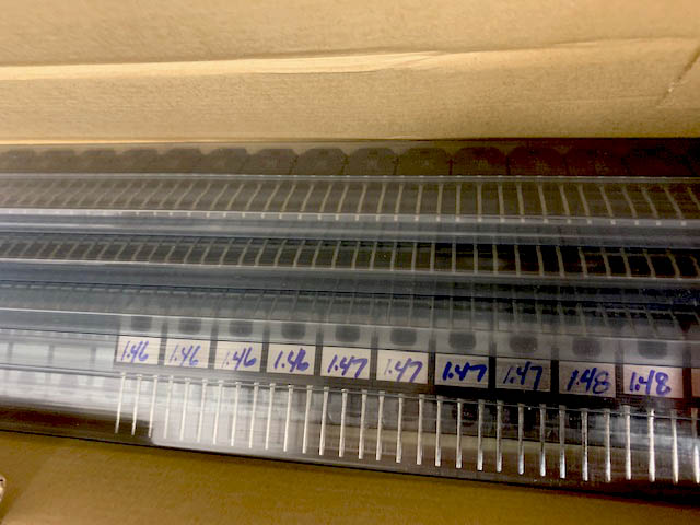

Vgs at 100mA. Sometimes I measure them at 200mA. The set I just sent were 1.46 for the P's and 1.57 for the N's If you match enough of them the Vgs can be better than +/-5%

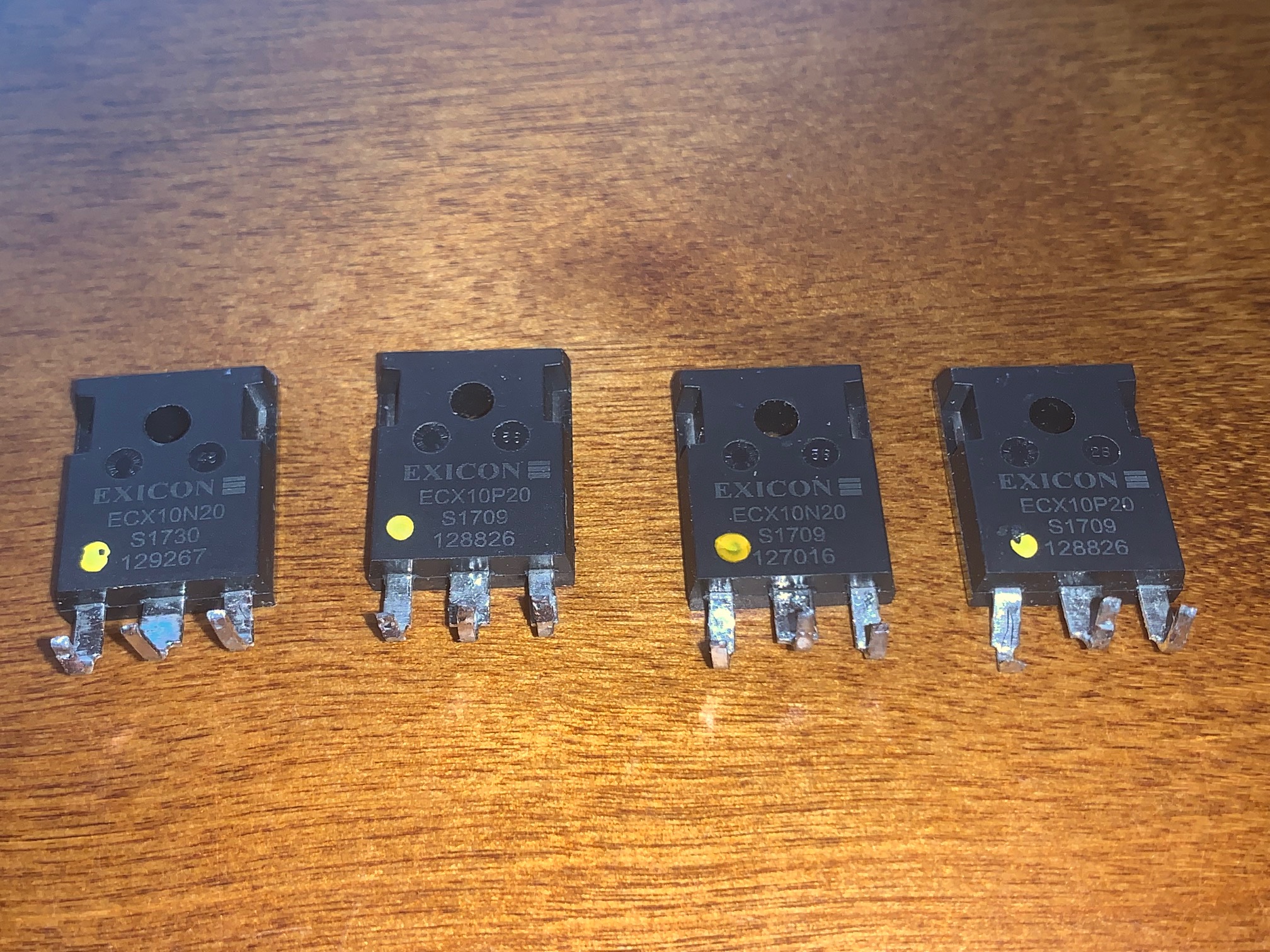

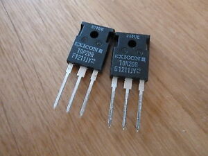

Exicon - UK are legitimate by Profusion, Richard Phillips
Sales Coordinator. In Thailand I bought K1058 and J162 from Tayda Electronics, they seem to work well.

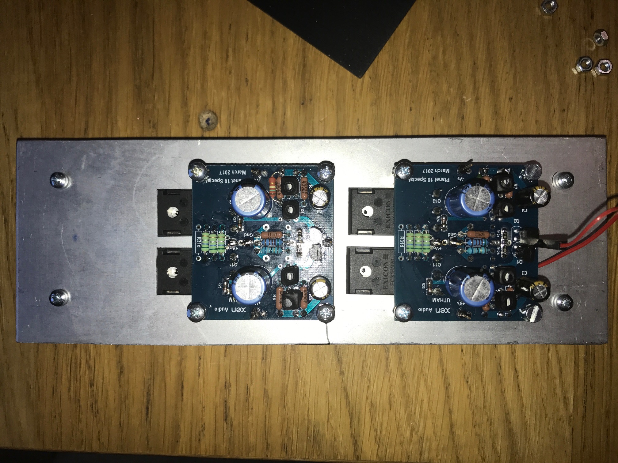

I use them in a number of circuits without global feedback.
UTHAiM -- Just for Fun
The XEN XELF Headphone Buffer

I'm not going to buy another 200 devices, I don't think I could, but there are enough such that you'll get 20 or more +/- 0.03 Volts, P to P, or N to N.
The Toshiba's have higher transconductance.

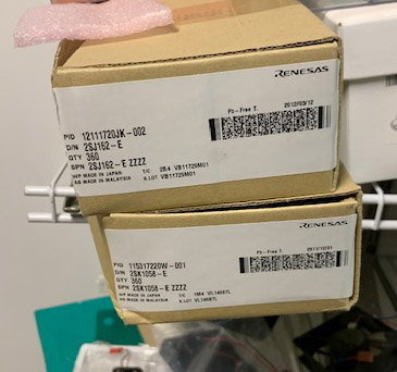

Jack came through for me with flying color. Better price than any UK seller of the Exicon. Delivery by USPS priority mail is super fast.I have a couple hundred:
The Vgs at 100ma is marked at the back of each device. Genuine Japanese Renesas NOS.
