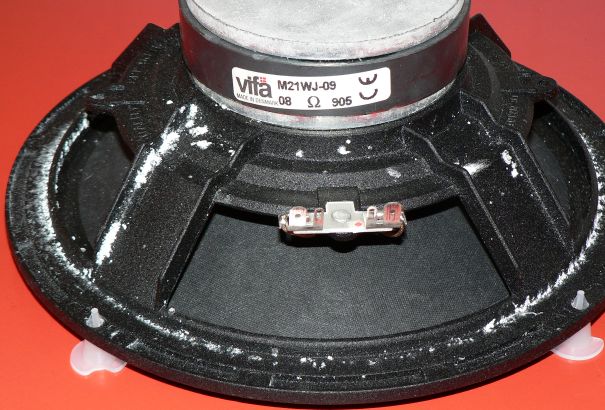

Add another to the case history of basket corrosion. Vifa M21WJ and the problem is the magnesium basket used in areas that have higher than normal ranges of temperature and humidity.
These were stored for years inside the house but have been used in the workshop for about 18 months. The picture shows the results.
So those with Vifa "M" drivers used in hostile conditions want to check them out.
Moral to the story is the use of Vifa "TC" type drivers with reinforced polymer baskets in the workshop.

I have the same defect on my Sonus Faber Signum mid-bass driver. You can read the thread
Here The corrosion had infected until the rubber surround so i had to replace the driver :bawling: . I am crossing my fingers that my new drivers would not suffer the same problem since i really like these pair of speakers and i was lucky since the agent still have the spare driver.
The SF agent also can not recommend any solution to prevent the corrosion due to our humid environment. The basket is made of magnesium alloy and it reacts to the environment causing the corrosion. Here are some pixs ...

I wouldn't go so far as that. To call Vifa and Seas drivers junk. Any drivers with aluminum or esp. magnesium castings with steel pole pieces will be subject to corrosion in a humid environment. Maybe your house is heated all the time or has other dehumidifier effects going for it. When was the last time you actually disassembled your drivers and inspected them? Not too many people take apart their working speaker systems unless they have problems.
I think the problem I had was not so much the humidity but the dew point. Rarely in the house would the temperature drop below dew point but in the workshop, the conditions are very similar to outdoor temperatures and dew point would be reached quite frequently..... that's what I think is the main environment problem.
A lot of corrosion problems in magnesium castings apparently can be accelerated by the manufacturing process such as the alloy used and even the type of shot blasting material.
In the end, this driver would not be able to be salvaged without removing the every thing from the basket, chemically treating it and a recoating such as tagnite which is crazy for a $30 driver. Using wire brushes and steel tools to clean it only makes matters worse so in the bin it goes.
