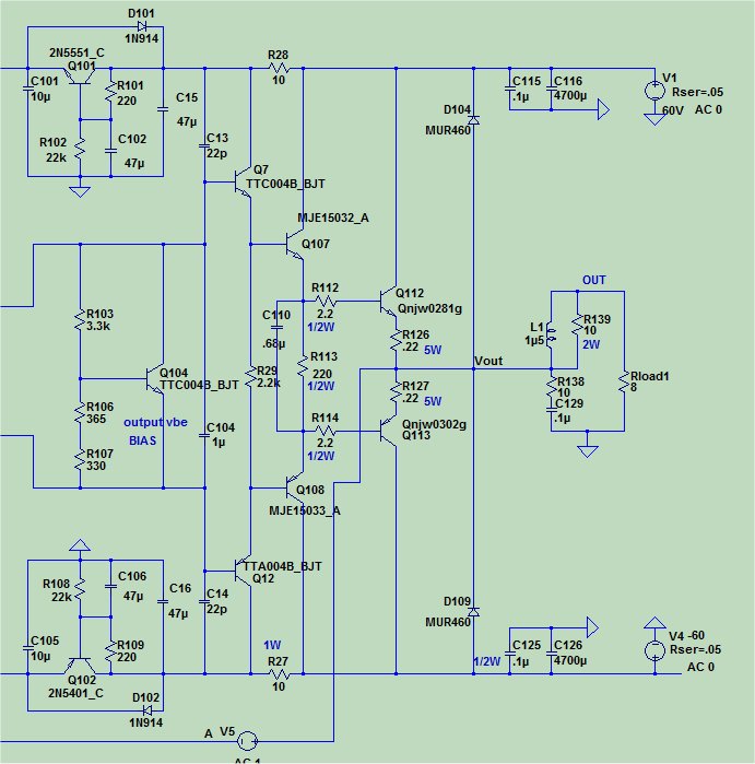

I use 3503/1381 on both VAS, and predriver in my CFA amplifier. Using TTC/TTA004 in predriver position needs to change the compensation (slow down the amp somewhat).

Hi zergxia,
I am still very much in the development phase of just the schematics right now. I am several months away from building anything. All I have are simulations right now. Sims are showing crazy low THD 🙂
Ultimately, I wanted the driver and predriver to be quite a lot faster than the outputs, and not just the same speed. As it was, the MJE1503x drivers were much slower. When I tried the NJW0281/0302 as drivers, I did much the same as you--I biased them at the same quiescent current as the outputs. They were the same Ft. I prefer not to have all the poles of the output stage stack up on top of each other, but spread out a bit. Not easy. They want to stack up.
Ultimately, Bespav gave very good advice: externally slow down either the outputs or the drivers. My outputs are now bypassed with strong zoebels to effectively make the OPS a double-EF as it approaches 1 MHz. My amp's overall loop gain crosses 0dB at 3MHz, which is lower than I wanted, but this seems to be the most stable OPS I've ever designed with discrete transistors (at least in simulations). About 1dB of peaking at 10 MHz.

Dear friend, thank you for your valuable sharing.
Many medium power tubes have a higher FT than high power tubes. When the driver stage uses a high-power tube, it is slower than the frequently used medium-power tube.
I thought before that the speed of the driver stage should be fast enough to avoid becoming a bottleneck. So I tried to increase the quiescent current of the driver stage to make the speed of drives and outputs as same as possible. But the reality seems to be different~
It seems that I should connect a small capacitor in parallel between the B/C of the drive to appropriately limit the speed.
Will this cause a decrease in usable gain and deterioration of distortion performance?
Thanks again:p
Any medium power stage will be an order or two faster than audio amplifier need. So it will not become a bottleneck.
Yes and no simultaneosly.
No - slowering will not nor decrease gain, nor add distortion.
Yes - slowering (based on speed of the last output transistors) will limit effective bandwidth of the output stage. Because of this you will be limited in unity gain frequency and feedback depth at higher audio frequencies, say 10-20 kHz, without complicated high-order frequency correction methods.
