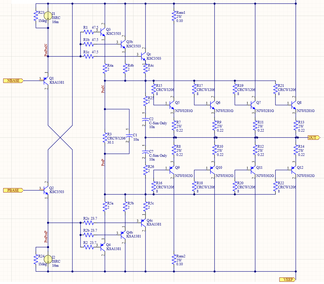

I've trying to spin up a new amplifier design--at least 200W into 8 ohms.
My simulation experiments have shown me that the output triple is the way to go, as opposed to the various CFP variations. I am using a diamond buffer like Bob Cordell shows on p. 267 of his 2nd edition book. My outputs are NJW0281 and NJW0302, 4 of each in parallel. My drivers are MJE15032 and MJE15033. My pre-drivers are KSC3503 and KSA1381. All of this is pretty much as Bob suggests.
I've been trying to increase the bandwidth of the output stage from the 20 MHz range, but have been frustrated. The MJE1503x parts were limiting things. I tried substituting an NJW0281/0302 for each of them, and that helped a little.
Then I tried a thing. I replaced the MJE1503x with 3 each of the KSC3503 and KSA1381 wired in parallel. This increased the bandwidth of the output stage by about a FACTOR OF 3! I now have 45 degrees of phase shift at 27 MHz and -3 dB at over 60 MHz. You may ask why I need a 60 MHZ output stage. The answer is that I'm wanting to increase the feedback factor at 20 kHz, and the first way of doing that is moving the 2nd pole further out.
Has anyone else used multiple paralleled KSC3503 and KSA1381 as drivers?
I'm attaching a schematic of the triple output stage.

Yes, emitter degeneration is a better way to share current, beta varies between devices a lot, so the base resistors are not so good (or are they just stoppers? in which case you might have very poor sharing in that circuit)Admittedly never did it myself. Might worth trying but I'd perhaps watch out for, a/ the combined safe operating area not to be breached, and b/ good current sharing not to be compromised by current hogging (high value base stopping resistor and lack of degeneration at emitter could encourage current hogging).
Although it may not make a difference in practice, it is more customary to have each driver driving its own output, rather than 3 in parallel driving 3 in parallel. You could probably reduce parasitic PCB wiring parasitic that way (less metal to make unwanted capacitances to ground, which eat away at phase margins).
Higher Hfe transistors require less Ib for the same Ie than do the lower Hfe transistors when working paralleled. When using a Rb then higher Hfe transistors would be driven at a slightly higher Vbe than are those of lower Hfe coworkers, due to a slightly lower voltage drop over the Rb, further deepening the unevenness in Ie. Power amp design books usually recommend a 0R22 emitter degeneration for paralleled output transistors, and a resistor no more than 10x that, or 2R2, at the base. So I guess for the paralleled driver stage I would put a 3R3 at the emitter, and 33R at the base, and go from there.
I looked carefully at SOA. That's why there are 3. You're correct that I need to put some resistors on the emitters for current sharing. Thanks for the reminder.Might worth trying but I'd perhaps watch out for, a/ the combined safe operating area not to be breached, and b/ good current sharing not to be compromised by current hogging (high value base stopping resistor and lack of degeneration at emitter could encourage current hogging).
AS long as you dont mind another device on the BOM, perhaps look at KSC2690/KSA1220
That is a heftier device with high fT and low Cob. I'll give it a shot. Are there SPICE models you like to use for that device? I'm wary of factory SPICE models.

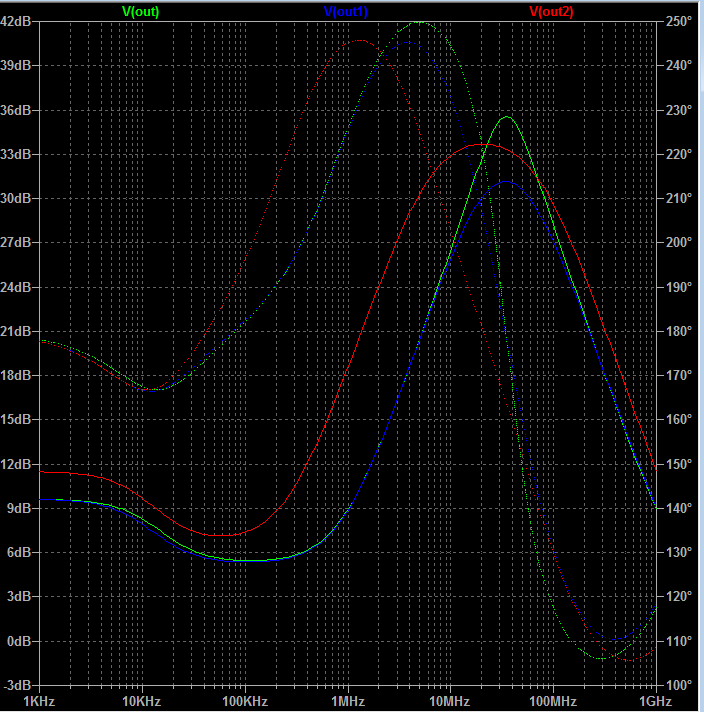

Also try to use a way slow output devices like MJL21194/MJL21193.
The have huge crystals, wide SOA, an order stable fT/Ic and are enough fast to any of the audio amplifier tasks.
Try simple attached models and compare.
The graphs in simple model shows an output resistance of the overall OPS.
Green curve is a fast OPS without slowdown of the 2nd stage.
Blue curve is a fast OPS with slowdowning 2nd stage
Red curve is an OPS with MJLs.
The sign of instability is a high-Q peak on the green curve. Check phase, the small frequency change ended up in phase turning to reversal. You need to lower such a peak by any methods.

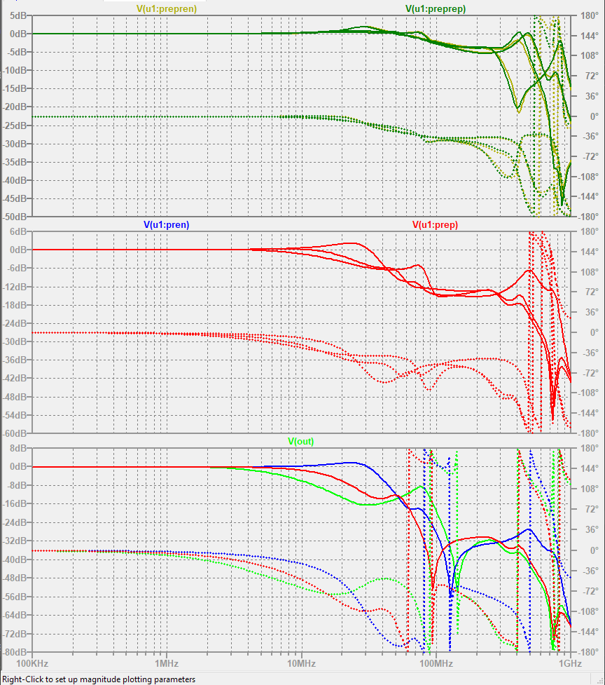

Hi Bespav,
I think I will keep the NJW0281/NJW0302, not for bandwidth but for flat beta vs current. These yield much lower THD than my old triples back in the 1990's.

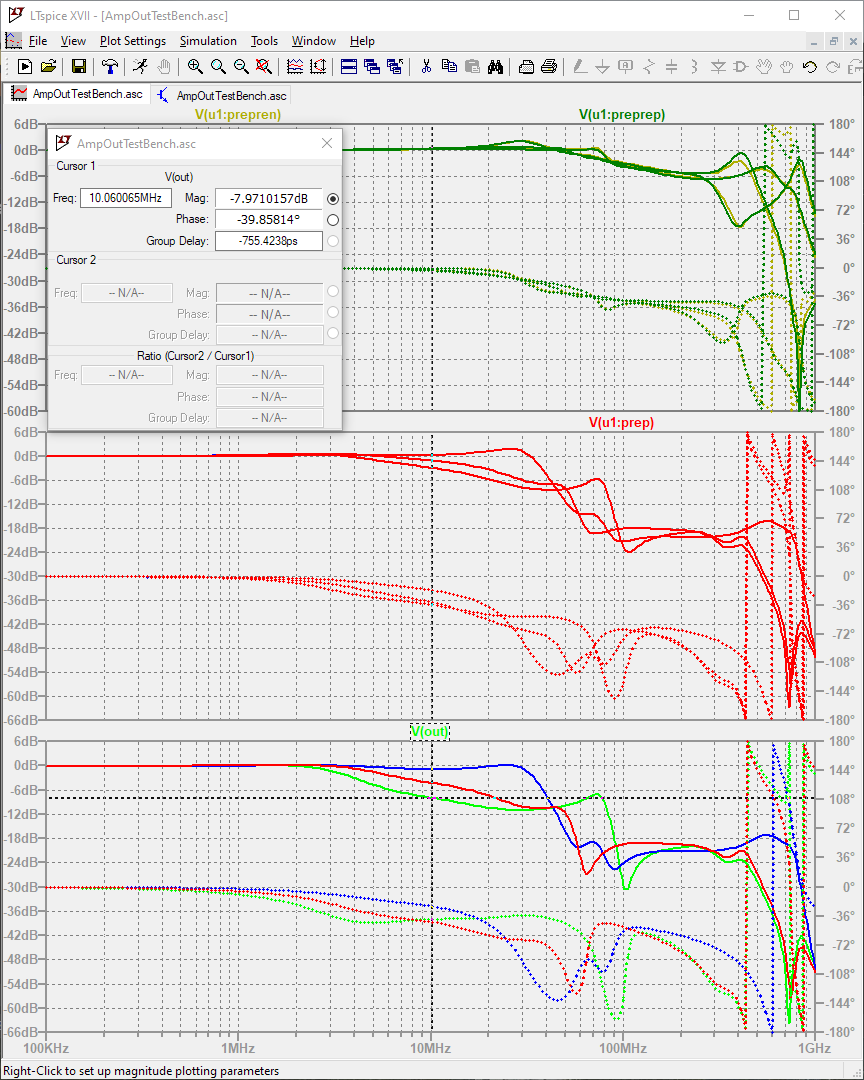

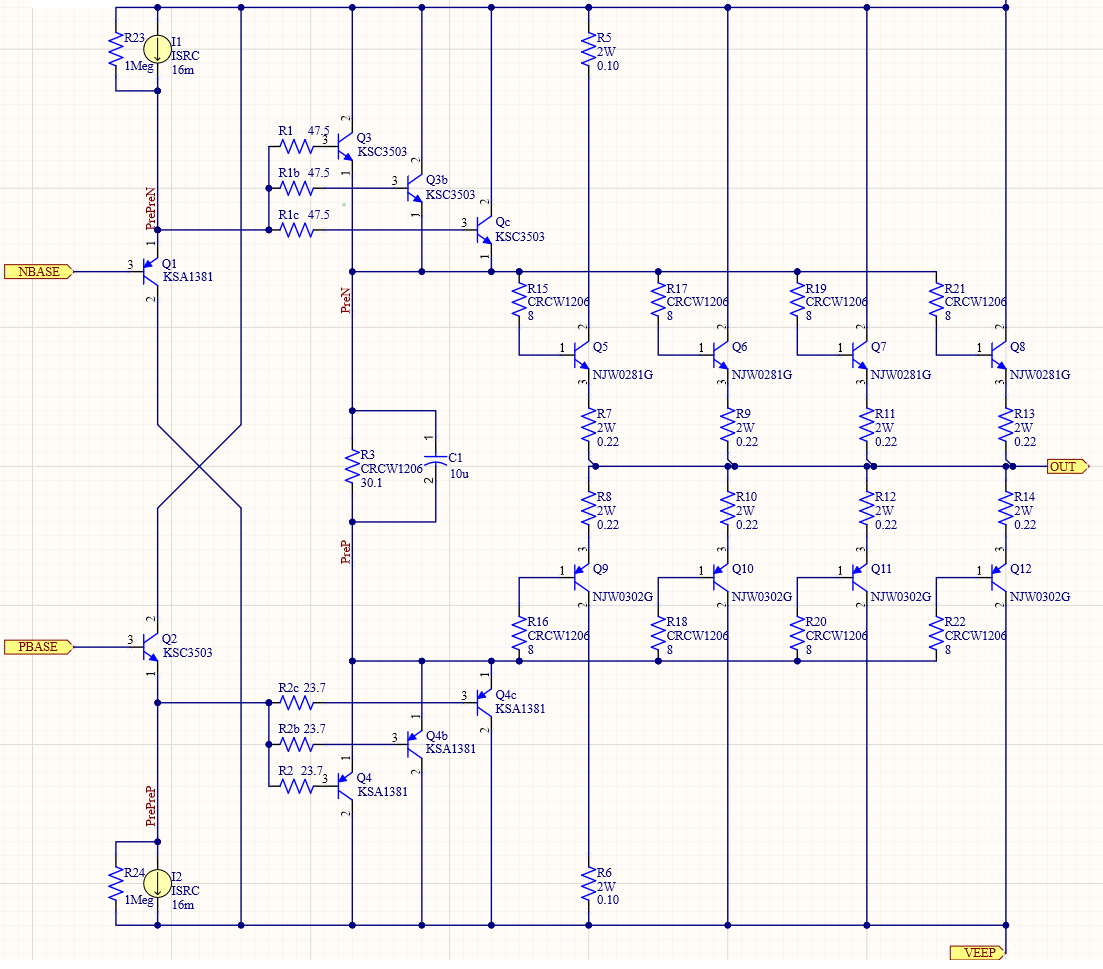

I did an experiment. First, I fixed the ballast resistor problem in my drivers (this did not noticeably affect the AC response) Then I put a Zoebel across the outputs as shown, to bypass them at high frequencies. I tried just C first, but there was too much pole-zero wobble around 5 MHz.
That really cleaned up the AC response. The before and after plots are shown, along with the revised schematic. I think I can safely close a 10 MHz UGF loop around this output stage.
The plots show AC response with output of -58V, 0V, and 58V into 4 ohms. As expected, BW drops heavily at -58 and +58 V on the outputs. My transistor models include 35 nH in series with each base & emitter, and 10 nH in series with each collector.
