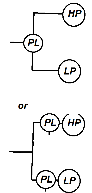

There is a subtlety here that may be missing from the discussion. Consider the hypothetical case of a 2 way speaker with perfect LR4 minimum phase crossover. Also consider that the speaker exhibits the additional nonlinear phase and GD associated with the woofer cut off and tweeter high frequency roll off. The crossover can be passive, active analog, or active digital, FIR or IIR. Makes no difference. Assume that the speaker is bi-amped. We wish to make the speaker linear phase. There are two options, global correction of the system phase, or correction of the individual woofer and tweeter response to be linear phase. So what is the difference? If we choose global correction a single filter is developed that will correct for the nonlinear GD associated with all sources; the woofer cut off, the crossover, and the tweeter roll off. The input signal is passed through this filter then to each channel of the speaker. If we choose individual correction filter for the woofer and tweeter the woofer correction will consider only the woofer cut off and crossover induced GD while the tweeter correction will consider only the crossover and tweeter roll off induced GD. That is, the correction filters will be different. But note, nothing, not one iota about the actual speaker has changed. Not the frequency response, the phase response, the GD, the polar response, nothing. But if in either case you pass an impulse through the correction filter(s) and then the speaker, the impulse will be reproduced perfectly (in theory). The reason is not because the speaker is linear phase. The reason is because the correction filter(s) manipulate (distort) the phase relationships between the frequency components of the input impulse in such a manor that when passed through the speaker the original phase relationships of the input signal is restored. The correction filter(s) take out phase rotation and the speaker puts it back in.
Looking at this mathematically,
For global correction let the correction filter PL(w). Then,
PL(w) * (HP(w) + LP(w)) = PL(w) * HP(w) + PL(w) * LP(w)
The summed response on the left will mimic a linear phase system but the individual responses on the right will not. The net woofer response will have nonlinear phase at high frequency (in it's stop band) where as the net tweeter will have nonlinear phase at low frequency (in it's stop band).

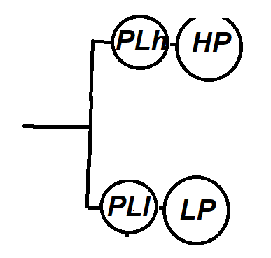

For individual corrections, let PLl(w) be the woofer correction and PLh(w) be that of the tweeter.
Then,
PLl(w)*LP(w) + PLh(w)*HP(w) will mimic a linear phase system and each individual response will also mimic linear phase .
Both global and individual correction schemes yield the same result but in the global case the "distortion" of the input signal is identical for the woofer and tweeter sections where as in the individual case the signals sent to the woofer and tweeter are actually different. From my perspective, and the old adage KISS, I can not see how individual correction would be superior to global correction. In fact, if the speaker were to use and odd order Butterworth crossover the global option is the only alternative.

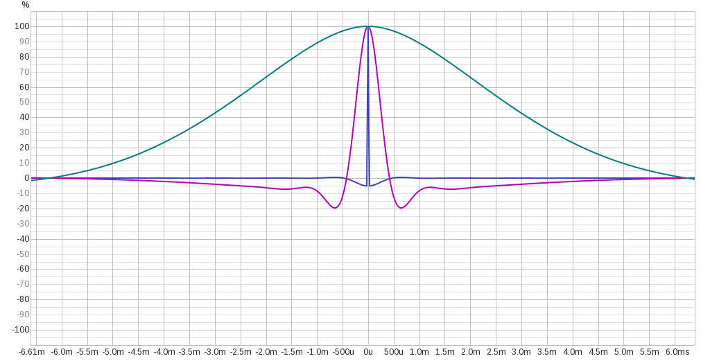

Good example to use, to help me explain my take on why global is not optimal.Consider the hypothetical case of a 2 way speaker with perfect LR4 minimum phase crossover. Also consider that the speaker exhibits the additional nonlinear phase and GD associated with the woofer cut off and tweeter high frequency roll off. The crossover can be passive, active analog, or active digital, FIR or IIR. Makes no difference. Assume that the speaker is bi-amped. We wish to make the speaker linear phase. There are two options, global correction of the system phase, or correction of the individual woofer and tweeter response to be linear phase. So what is the difference?
Fully agree, no difference....IF we are talking about 1D electrical space.If we choose global correction a single filter is developed that will correct for the nonlinear GD associated with all sources; the woofer cut off, the crossover, and the tweeter roll off. The input signal is passed through this filter then to each channel of the speaker. If we choose individual correction filter for the woofer and tweeter the woofer correction will consider only the woofer cut off and crossover induced GD while the tweeter correction will consider only the crossover and tweeter roll off induced GD. That is, the correction filters will be different. But note, nothing, not one iota about the actual speaker has changed. Not the frequency response, the phase response, the GD, the polar response, nothing.
When we use global correction, I know a FIR filter must be long enough to correct the lowest frequency of interest.
And the higher frequencies get corrected within that longer filter.

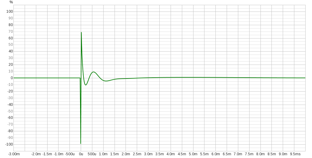

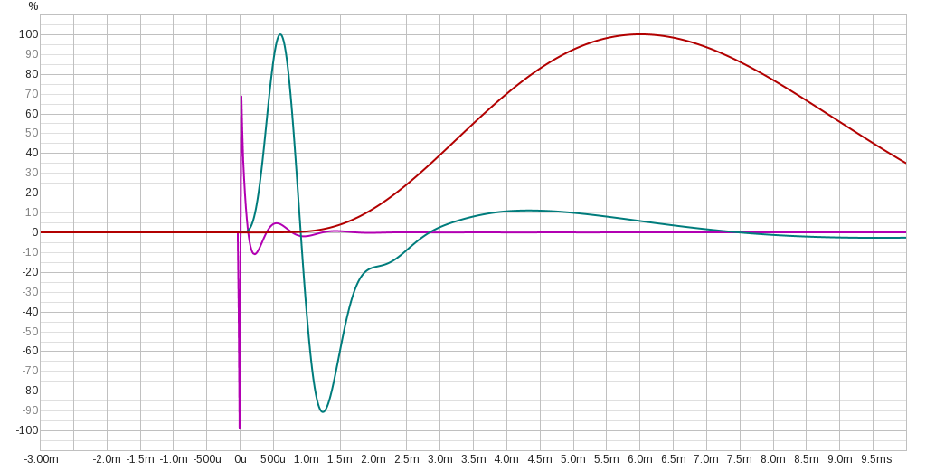

I've found looking at the impulse response of global filters, that the one filter usually has lot of impulse fuzz.
Fuzz that stretches out in time on both sides of the impulse peak, (due to length of filter.)
Whereas with individual corrections, a long filter can used for the lowest driver, with progressively shorter filters used for higher frequency sections.
Frequency dependent FIR filter length if you will.
I think decreasing FIR filter length with frequency helps minimize the time window width of potential misapplied corrections or pre-ring as frequencies rise.
I've learned to try to get each sections linear phase impulse response, as clean as possible, trading that against as short as possible.
(Using fixed delays between unequal filter length sections.)
The key for me has been to look at the electrical filter's impulse, .....and not just stopping at acoustic transfer & impulse, think acoustic response says it all.
Because...I think electrical impulse fuzz is noise....that we hear though our speakers all the time.
With otherwise identically near perfect acoustic transfer and impulse response on my multi-ways. ....
.....when each section's electrical impulse is comparatively cleaner & again shorter, its like the entire speaker's noise floor is lowered.
Subtle, yet obvious.
Speaker at low volume sounds particularly better. Dynamics sound improved without SPL metering any higher. Loud sounds even more alive.

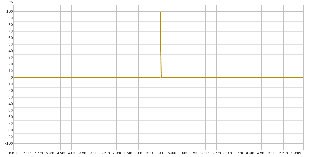

And I've yet to see a global FIR file, covering low to high, have the filters electrical impulse look really good.
Some two-ways have been OK, when starting with an already excellent speaker....and leaving the woofer cut off alone. Past that, not so good..

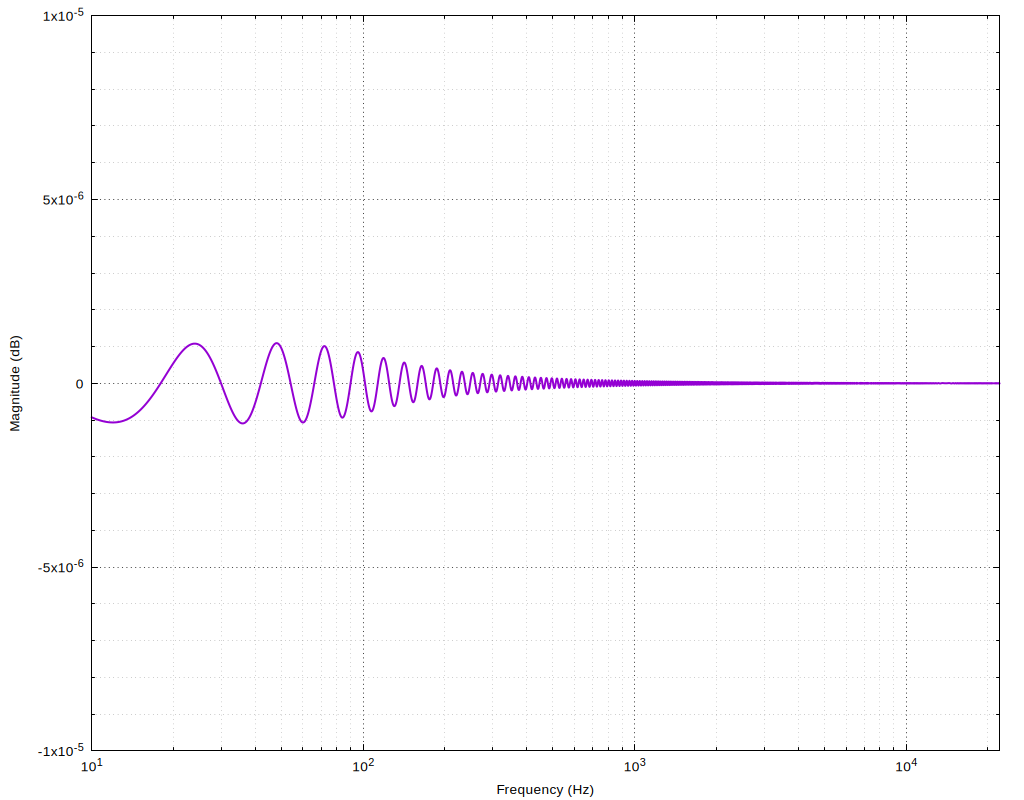

With regard to "buzz" that's a matter of numerical accuracy. I suspect a hardware issue and it may be true that it could be an issue. No argument there.

Must be a problem with how the filters you've examined were designed. The global phase correction filters I generate have no such problem. Here's an example 3-way crossover (LR4@85Hz, LR6@1050Hz), first uncorrected:I've found looking at the impulse response of global filters, that the one filter usually has lot of impulse fuzz.
Electrical sum of the above:
Now with the global phase correction filter applied (2048 taps):
Electrical sum:
Correction filter magnitude response (note the vertical scale):
I think, perhaps, you didn't get my point entirely. Suppose you have a speaker that isn't linear phase to start with.. That seems to be the objective of the original post. It can be any speaker, and you want to correct it to behave as a linear phase system. You can measure the response, say it's SP(w). Now it is desired to generate a correction filter so that the response is SPLP(w), where the phase of SPLP(w) = w*Td. That is, same amplitude response but linear phase. You have
SPLP(w) = PL(w) * SP(w), or
PL(w) = SPLP(w) / SP(w).
PL(w) is an all pass filter with phase equal to the negative phase of SP(w) plus the delay associated with SPLP(w). Process the input through this filter (FIR) and feed it to the speaker. It can be single amp or multi amp, any type of crossover.... The speaker's output will mimic a linear phase system.
Consider a speaker with a B3 acoustic crossover. How would you develop separate correction filters for the woofer and tweeter?
Let's go back to this. Given that you now have PL(w) yuo can apply it as.
Since the same PL filter is applied to both the HP and LP sections the inter-driver phase difference between HP and LP section will remain the same and the summed response will remain and the speaker will perform as if it is a linear phase design.
By contrast, if you different PL filters for the HP section, say PLh and low pass section of the speaker, say, PLl and apply them as
then there is the potential to alter the inter-driver phase difference and the result, while it may be linear phase, may not sum as it did originally (i.e. the B3 case).
In the LR4 case it doesn't make a difference because the inter-driver phase difference through the x-o region is zero and if you make the LP and HP responses linear phase with the same GD they will still sum properly. But that is not the case where the inter-driver phase difference is not zero. The bottom line is that the correction all pass filter should be based on linearizing the system response.
OK ... I think I understand your point, now. It has always been my assumption that what you stated above is exactly the case. That is to say, it doesn't make any sense to linearize the woofer response to constant delay of "x", and to linearize the tweeter response to constant delay of "y", y != x, regardless of whether the linearization is done in the crossover or globally. Similarly, in an "n-way" crossover, the final delay in all of the passbands has to be equal, regardless of the individual delays associated with each crossover pair. The multiway crossover depicted in my MDS Tutorial does this automatically, but if a different configuration is used, then the delay equalization has to be performed explicitly.The bottom line is that the correction all pass filter should be based on linearizing the system response.
Electrical sum:
Guys, sure...in the electrical domain...global vs individual makes no difference. We can all agree, Ok?
But what about the 3D acoustical measurement domain?
Take your example above, the first panel showing 3 minimum-phase pass bands. And with all three pass bands having correct relative timing,... that is their initial impulse rises all starting at T=0.
What happens if they don't all start/rise at T=0 ?
Well, pure FIR global impulse inversion in the electrical domain will still correct them to linear phase pass bands...but only / narrowly for the specific time offsets from T=0 rising starts.
And how dang easy is is to nail down acoustic passbands' min-phase impulse starts? For establishing low frequency timing, it's difficult at best !!!
Real world global correction based on acoustic measurements, implicitly assumes relative measured timings are spot on, ....like electrical always are..
Error gets magnified away from given measurement spot and FFT determination.
All that's one time domain issue...a form of "tune to a spot" like global FIR room correction inevitably suffers.
The form I was addressing earlier, is when driver cut offs / rolloffs get summed together for corrections. Shorter filter lengths are needed for higher freq drivers than lower ones, to help keep passbands' individual gack, confined to their own passband.
