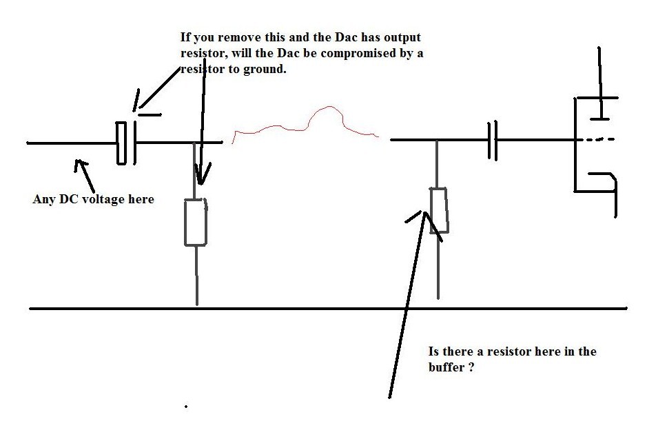

i have a DAC which has an output capacitor that is 10uF. which then connected to a tube buffer that has the input cap of 0.33uF.
my question:
1. is this setup recommended? with 2 caps in series and separated by an interconnect?
2. can i remove one of the caps? which is better removed? output cap of the DAC or the input cap of the tube buffer?
3.i am planning to put this DAC and tube buffer in the same chassis. what is my better option?
thx in adv
regards Erwin

in this case V rating could be an issue with tube circuits operating at 10-100x the V that a typical DAC output cap may be blocking
likely the 10u DAC output cap will not have a high enough V rating for the tube circuit
so the safer approach would be to keep the tube amp input cap and possibly remove/short the DAC cap if you want to reduce the order of the low frequency roll off

i have check that the voltage required for the input of the tube buffer is less than 100v. its around 55v if im not mistaken.
while the output cap of the DAC is also rated 100v. actually 63v before the cap upgrade.
does this affect your proposed solution? thx
if operating V works out then you could try eliminating either one of the caps
all else being equal the larger value cap would give a lower corner freuency which has several good effects

I think jcx means check this 🙂
If the buffer is exactly like in post #1 of the link I would go with jcx's suggestion of linking out the 10 mfd cap in the DAC.
When you have linked the cap measure if any DC voltage present at DAC output. If there is then as long as you ONLY use the DAC with that buffer there is no problem.
the tube buffer circuit shows ~150 V supply - I would use that as the starting point for the blocking cap rating, not the nominal 55V operating point - if a Al electrolytic is used also check the bias point as the cap's leakage current could change it
it simply isn't safe to use a cap with a lower rating than the attached device's power pin V
with such high voltages you may want safety rated caps and to beef up the DAC output with some clamp diodes from the DAC out to the DAC PS&gnd that can carry the tube supply's max current until the fuse blows
I would recommend similar clamping on the output of the buffer as well

Hi Guys. Thx for the input.
Jcx, the tube buffer input caps are 400v rated polyester. good enough?
safety rated cap you meant is X2 rated caps?
i got no clue about "clamp diode", mind elaborate? thx
