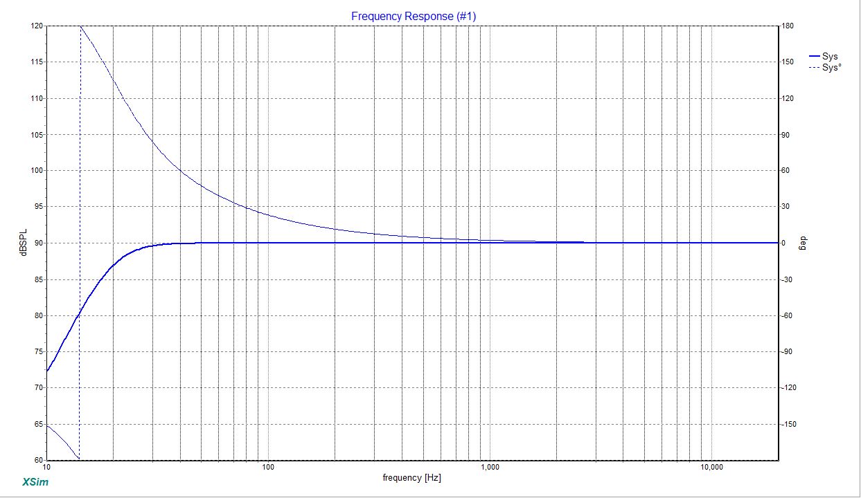

The second thing, I think, can be changed: I'd like to remove the two fixed infra(sub)-sonic filters (3rd order butterworth filters @ 20hz), because I don't need them for my subs and they just rob me of precious low end extension. ;)
