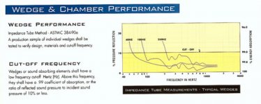

Yes, you keep repeating that but the data disagrees with you. Anechoic chamber wedges (almost always in fiberglass) are very effective and scale to any size. Don't they know better?

If 4" of fiberglass works to alpha 0.99 at 125 Hz, then It isn't risky to predict that 8" would be good at 63. More than 2 meters required for below 100Hz doesn't ring true (show me your data).
I've attached a figure from an Eckle (anechoic chambers) brochure. I believe they took it from the Beranek/Sleeper 1946 paper. It shows performance of a 60Hz wedge which is 1.5 m long, I believe. These were measured in a standing wave tube. The wedge shape gives the impacting wave an acute angle so any reflection at all bounces further into the wedge. I do know that fiberglass density was part of the experiment and many (in the thousands) samples were tried.
The original question was whether polyester wadding (pillow stuffing) had any special absorptive qualities. You maintain that it is better than fiberglass for very low frequency use (due to lower flow resistance). Every measure at every thickness that I've seen published shows that fiberglass is far superior. Is there a crossover point where polyester is better? Is there a phenomanon that prevents fiberglass performance from scaling to larger and larger sizes? Perhaps, but not that I have seen in the dimensions we use. It doesn't show in speaker cabinet dimensions or practical room treatment thicknesses, or even in anechoic chamber wedges of over 1 meters thick.
