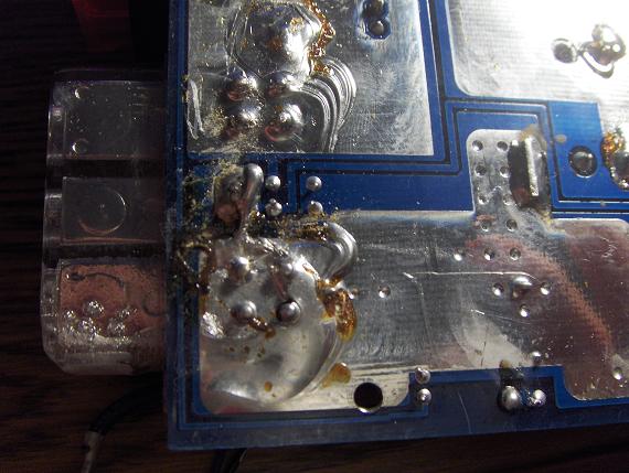

Could this be the cause of an amp not working. I was looking at the bottom of the amp and saw that the solder on the ground terminal was melted and seem to have connected to the remote wire terminal.
{Using the word terminal as in the point where the wires go throught he board and are soldered in.}
Could this be the reason I am not gettin any output from the amp?
Yup.
Would also suspect that the head unit remote out is now shot.
They only use small surface mount transistors for these normally and just wont take any abuse.
What the helll did you do to heat that terminal up so much ???????
Extremely poor connection..

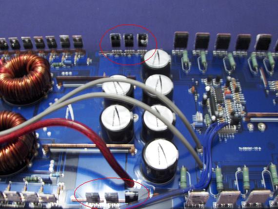

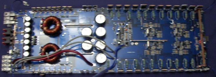

Can you post a good quality photo of the power supply from the top side of the board?
Have you pulled the FETs and checked them?

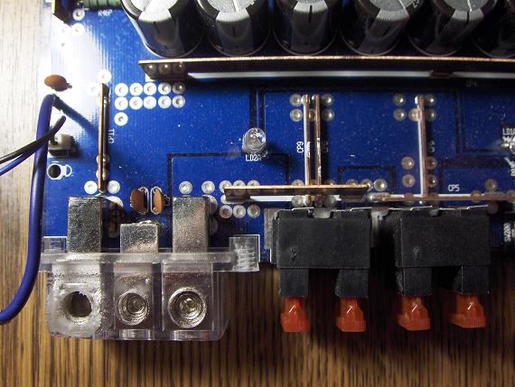

That's not the power supply. That's the power terminal block.
I would like to see the transformer, the FETS, inductors, capacitors, rectifiers... If you can't get good resolution in one photo, post an overall shot and then close-ups of the other components.
They are not FETs. They are likely rectifiers.
Do they have diode symbols on their face? Possibly all facing one direction?

going by your last pic.
Left side will be switching mosfets (possibly irfz44) for the power supply.
Middle (circled) will be rectification and a pre regulator for power supply section.
Right side, output section. (amplifier)
Best way to test power faults in an amp is to remove the rectifier diodes, turn the on and measure (carefully) the votages where they came out.
one side will be -40volts (very rough guees depending on amp output) other side will be +40 volts.
to check the high speed diodes just a meter on its diode scale.
should get nothing one way and about .6 the other.
