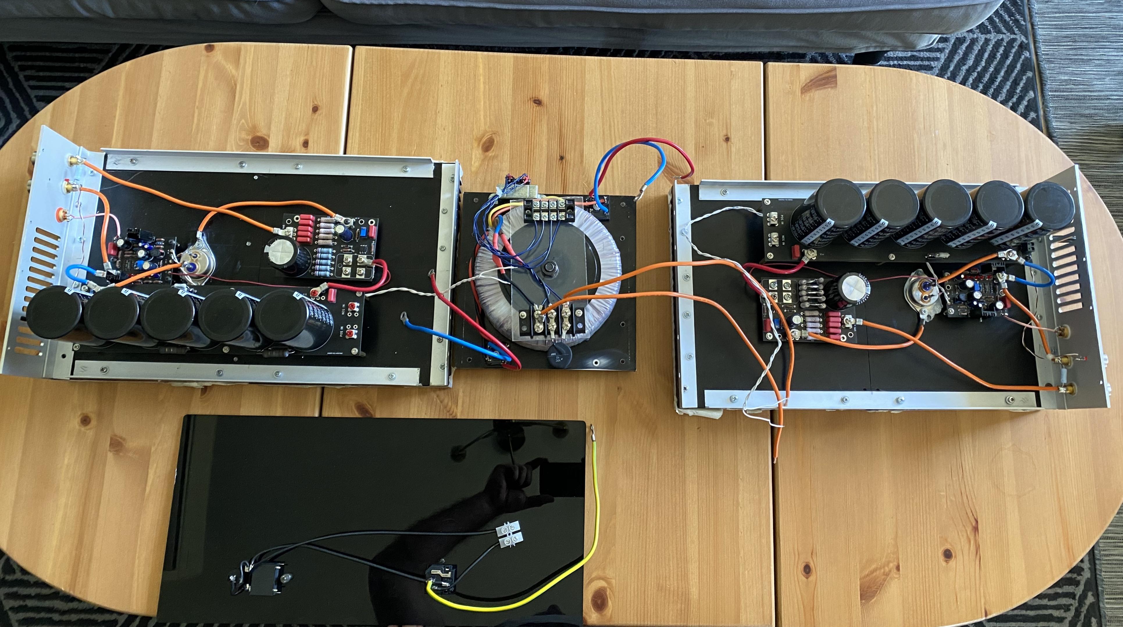

On attached photo you can see a relay glued next the switch and parallelled to it. DC wires from a 2.5mm socket not yet installed on the photo

I assume that this is your 1st FW clone build, i can share my experience. I also build monoblock, where AlephJ was my 1st FW clone build, but i gave the board away to my friend.
now on each chassis there are J2 and M2 on each side of the heatsink with neutrik powercon to switch between board. you can refer to this post

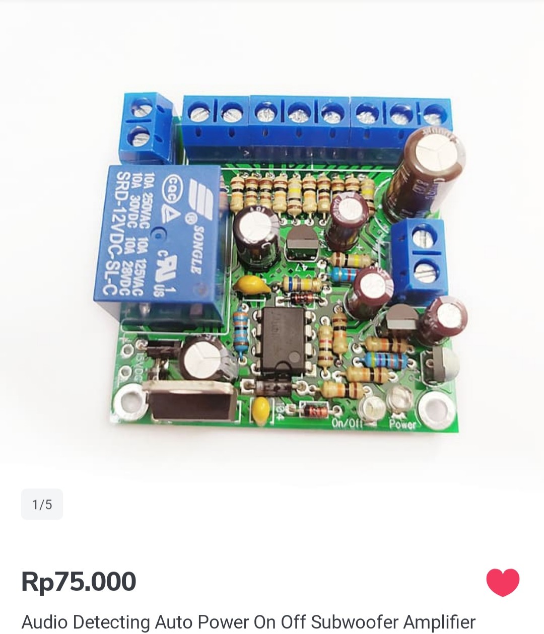

I also had same idea to build remote trigger for my audio gear and already got this kit by my local diyer (you can search if any similar item ebay/aliexpress) where this relay will be trigered if any audio source coming.
but I have not install it yet, i don't think it's necessary because my audio gear won't stay 24/7. now i just use traditional method by pressing the rocker switch

I could go further and include the audio detection module suggested by gadut in each mono block to trigger the relay and avoid the manual switch altogether. I suppose with this approach, in order to warm up the amplifier I would have to start playing music. I assume that the audio input to the amplifier would be in parallel with audio fed to the audio detection module.
