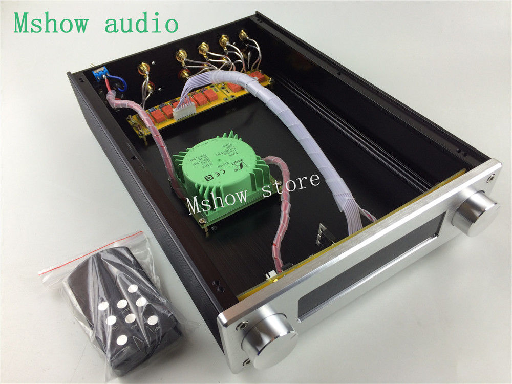

Remote selector and volume control on ebay
I found a package on ebay at a reasonable price. The 63 dB volume attenuation should be adequate for most preamp application.
HIFI Remote volume Controller peramp pre-amplifier audio 128 steps /4 way input | eBay
I like the 308mm enclosure depth which would allow easy addition of buffer card or upgrade of transformer. Any first hand experience of this stepped relay ladder volume unit?
