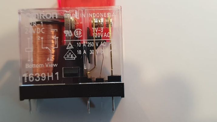

Interesting. Does the extra relay plug allow for remote on/off control?
Yes it does, its a switching transistor so you need to add a relay to switch line voltage.
Have you used it with a relay, if so, which relay did you use?
Also, have you tried programming a universal remote to operate this device?

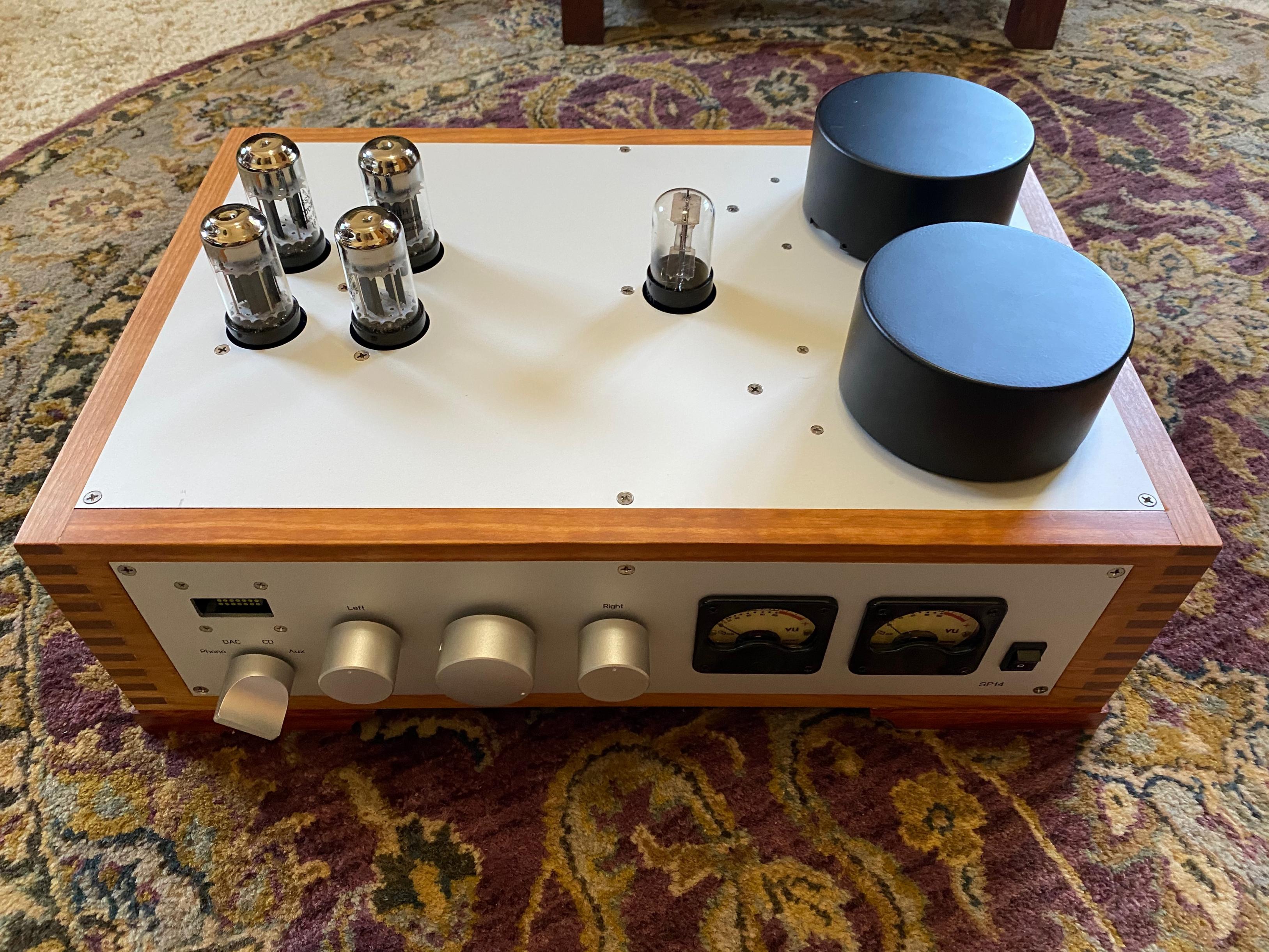

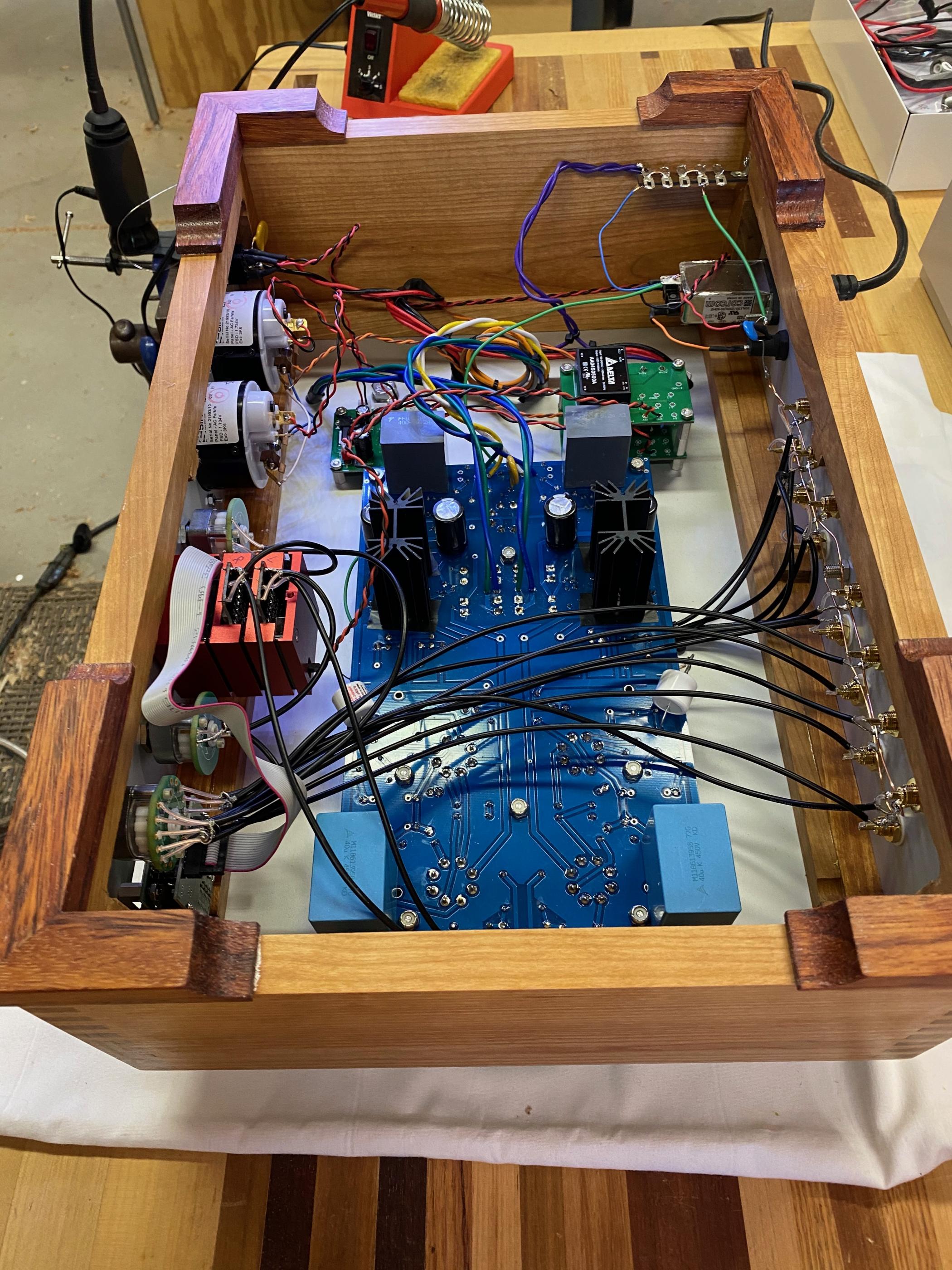

BTW here is the last build I did with them.
My wife is too, the once I explain why we 'need' this or that new item. 🙂
That looks really nice! What amp board is that?
SP14 Pre-Amp from tubes4hifi home page. Roy's designs are very nice, clear and fun builds. Have made several different builds from him.
I haven't used the relay switching but I would choose something similar to the attached pic at whatever voltage suites the application. I would also look for a relay socket as I don't like line voltage on a PCB.

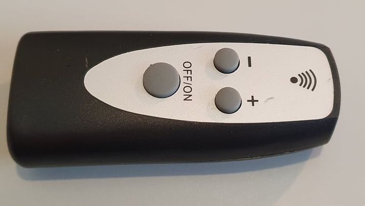

They come with an el cheapo remote which I have plans to repackage. I suppose a learning remote would work.
