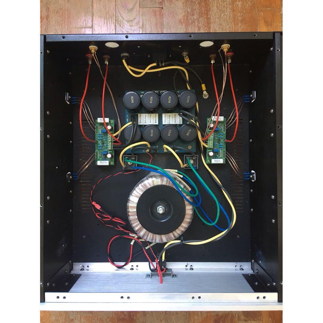

such as this... are there any sonic disadvantages?
Yes, that's very bad. At the high switching frequencies that's an oscillating circuit and it's killing the dead time adjustment and that means the transistors will likely fry. Even worse: You can expect DC at the output when that happens and since you've got no protection on the amp, that will fry your speakers too.
And there's actually no reason to have them that long, just move the boards to the heatsinks/enclosure wall. Much better: Split the capacitor board and keep the wires short between the caps, enclosure and FETs.
