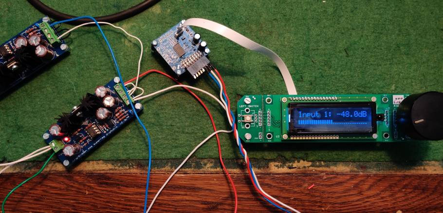

I was looking for for the same and decided to get me a Muses 72320 volume control which u can have with remote control. I bought one from Academy Audio and am totally blown away by the immense better sound quality against the blue Alps pot.
I got the MCU from Academy Audio but there is a smaller one, with or without display. I wanted this one as it can switch inputs also. View attachment 800688

Thanks for the response. What are the components in the pic?
volume control and display board I can tell how about the other 3.
The 2 boards on the left are the 15v (+and-) Jung regulator, ordered here on diyaudio.
The board with display is the MCU, which controls the Muses which is on the small board which is a VCM.

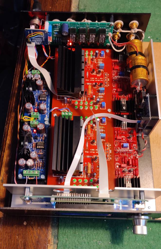

With the MCU you can also switch 4 inputs. I have a relayinput board and use a small board with ULN2003 to switch the relays, as the MCU can switch 1mA max.
Regards Remco
Regards Remco
