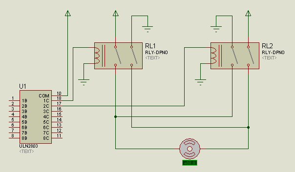

What is the drive voltage for the volume control?
You would normally use 2 binary outputs from the controller to drive the motor, presuming a single speed of operation is satisfactory.
One output would drive the H-bridge for travel in one direction, the other, obviously the other direction. The H-bridge is simply a way to wire the motor so that independent drive can be applied to it in either direction. PWM would not be required,
w
I'll draw you a diagram if you need it. You don't need to use FETs, you can drive relays off the ULN2803.
As long as you can't drive 2 outputs simultaneously, this should be OK.
w
If you still want to make use of the PWM output, you can feed it into the relays to drive the motor, @8k the motor will accept it as readily as DC.

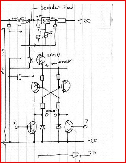

Transistor version here... this is part of a circuit I actually designed and built to add RC to my amp. As myself and Waki say, you normally need to outputs EITHER of which go high when volume up/down is pressed but NEVER together. The pot on the base of the TIP111 allows the motor speed to be set, something thats important to get the feel and usability correct of how fast the motor operates. Points 6 and 7 are the "logic" inputs to the bridge.
