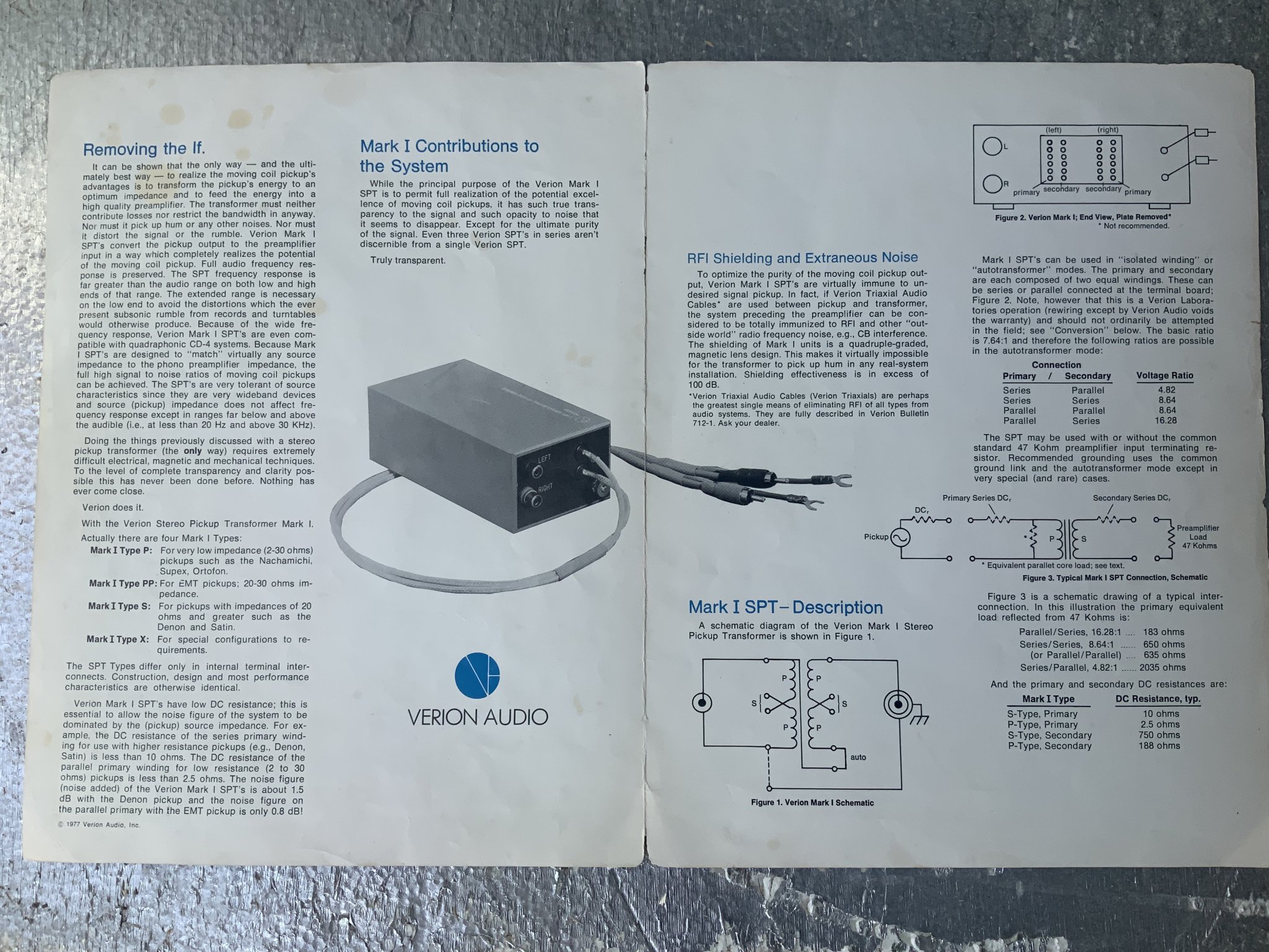

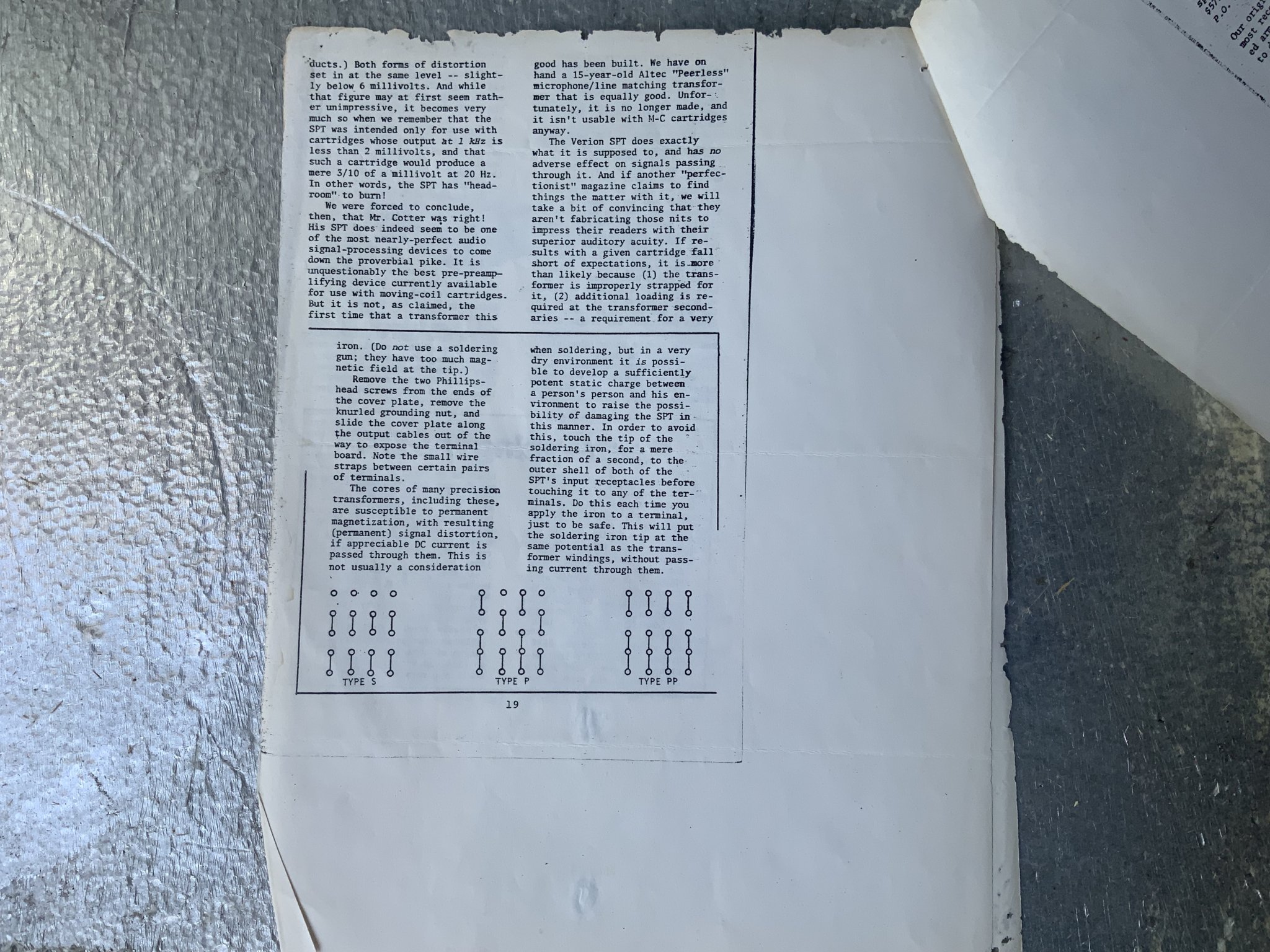

Have the Verion (early cotter) transformer info.
The cotter uses has a different strapping on the (P)
