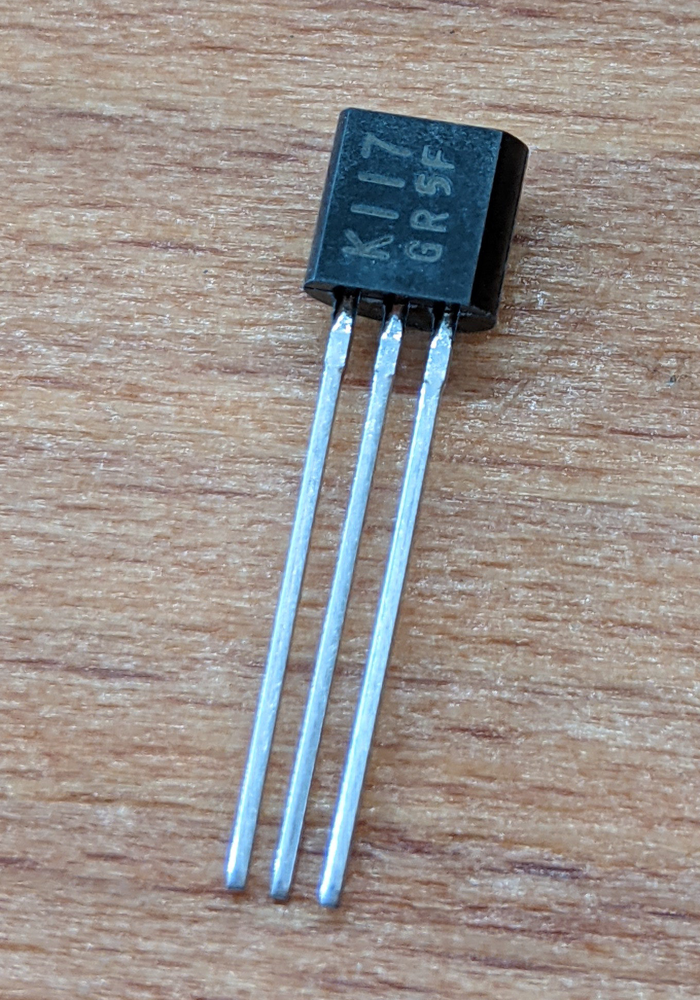

Reichelt.de in germany still have 2SK117.
As they are a re-distributor, they could potentially be fakes
but never had a problem with parts from them.
There is small chance these will be originals as 2SK117 were never that popular as 2SK170. But I wouldn't bet my money on it.
