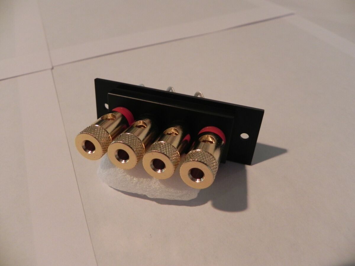

It is long/rectangular. How do I go about finding binding posts with mounting plate or whatever that fit the opening in the subwoofer? Don't the spec sheets usually specify the width of the panel included. I don't know what I'm doing so this may be wrong terminology. I meant, the widest/longest dimensions, rather than the part that extrudes through the sub opening. Obviously the former is more important.

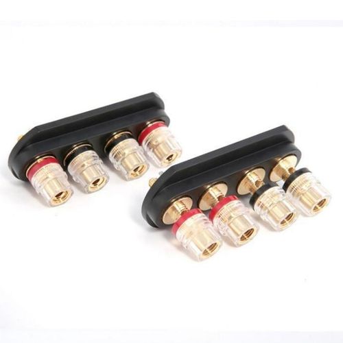

These are some reference links:
https://www.parts-express.com/4-Way-Binding-Post-in-One-Horizontal-Mount-for-Speaker-Amplifier
https://www.alibaba.com/product-detail/R-Connector-Brass-Binding-Post
https://www.ebay.com/itm/375530175096
https://www.ebay.com/itm/133778683293
https://www.ebay.com/itm/166223426993
https://www.ebay.com/itm/135389674441
Some of these are just standard binding posts mounted on custom mounting plates and sell for very high prices!

My suggestion is use a piece of 1/8" thick ABS plastic, very easy to cut and drill.You may not be able find a flat mounting plate ready made, but you can cut a piece of metal or wood or plastic that will work.
That will let you use most any connectors that you want.

When only 2 dimensions are stated for push terminals, is that usually for the panel dimensions, or the part that extrudes through the cabinet?
Without clues like "total length", "hole diameter" or a dimensional drawing, dimensions could be anything, I wouldn't assume anything.
