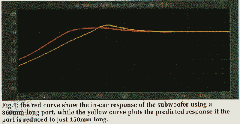

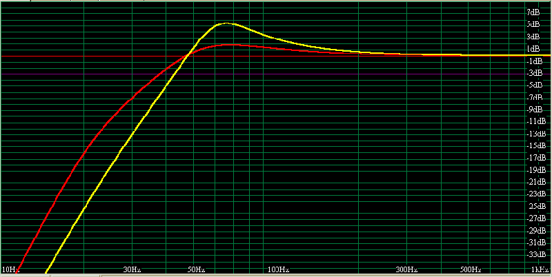

I have thought the same thing... especially when I saw the graph created by a program called BassBox for a sub that I had modeled mysefl many times... So, I compared... both are in a 19.4litre box tuned to 33Hz and then halving the port length... LOOK!!!!

Hmm, so, that would explain the extended bass on the graph done by bass box? :) BUT $160!!!!!
I doubt it, real curves are jagged and even smoothed out graphs are at least a bit squigly. The difference is due to the different port dimensions (as was written on the screenshot).
