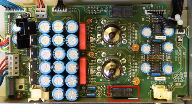

So indeed I'm having low voltage to drive the coils. The strange thing however is that the Omron or 12V relay is engaged first. I think that this might be due to other circuitry on the board I'm connecting to. The picture shows the relay on the board.
To give background, this is the original post with the design I'm now tweaking.
How to build a Digital input on a Njoe Tjoeb 400 (Marantz CD 4000) cd player.
i added the second relay with the idea to drive a dual led for indication of power with a warm up time for the tubes. So switch from red to green.
