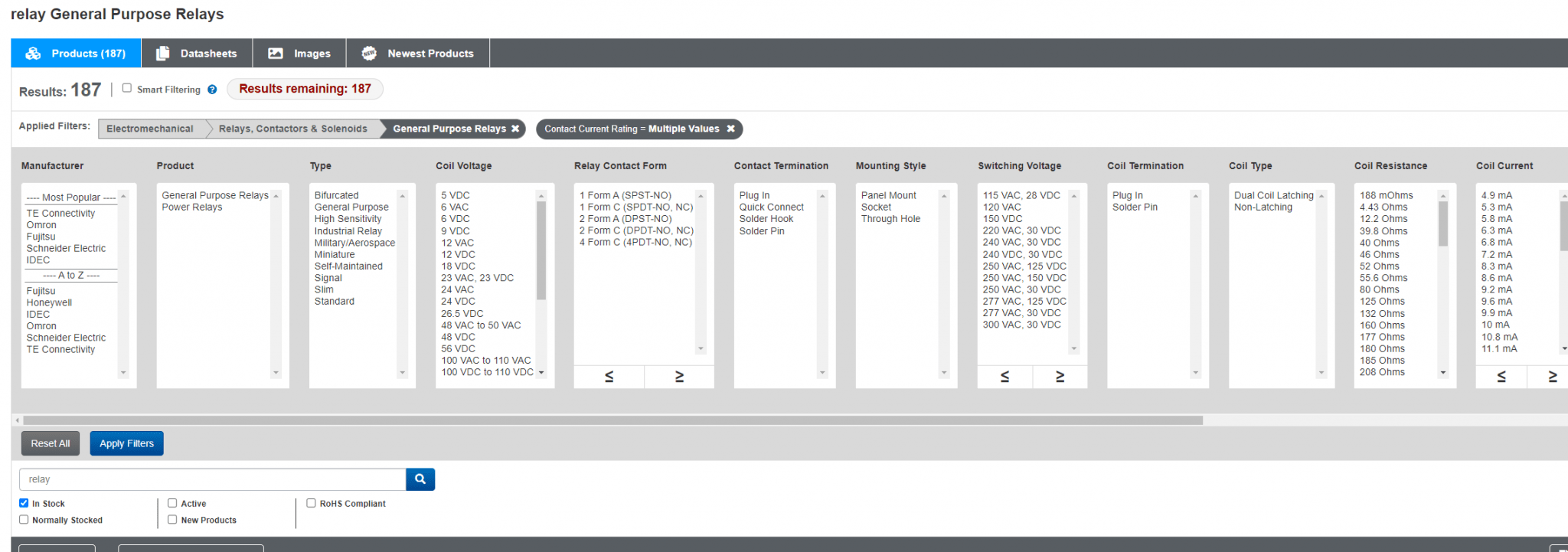

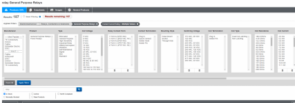

I found these: https://www.digikey.com/en/products...y-potter-brumfield-relays/9-1462038-9/1828444
5A rating, dual contacts. I think these should work, since the output of the DG300B amp isn't that much, and it won't be used while the amp is outputting.
